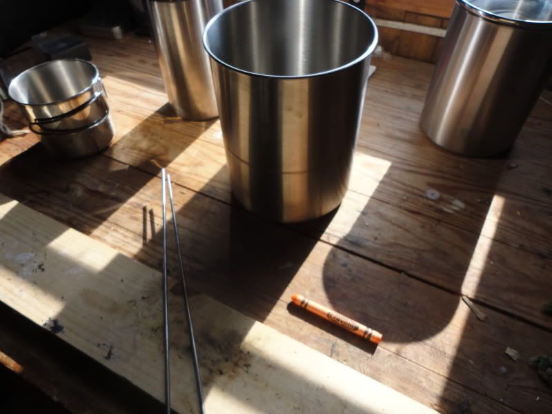

Made me a cookset the other day. I thought you folks would like to see it. Ive been wanting to make a twig stove and a pot to nest in it for awhile now, but never seemed to get around to it. It was suprisingly easy to do. I used a couple stainless canisters I bought, and had the rest of the stuff scattered around the lab.
I first plotted out all my holes and marked them with crayon..I find all of truely great woodsmen use crayon.

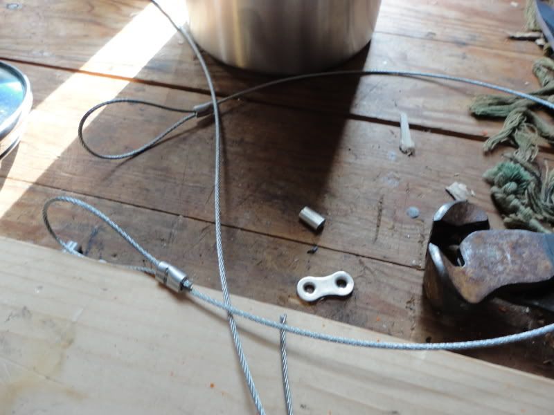

I made a bail for the pot next. I have one I made for a Guyot that might work too.

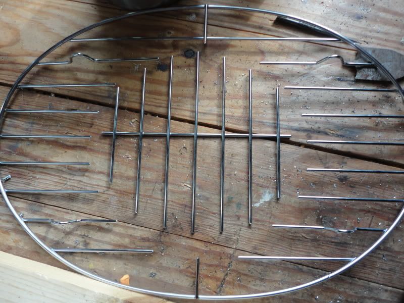

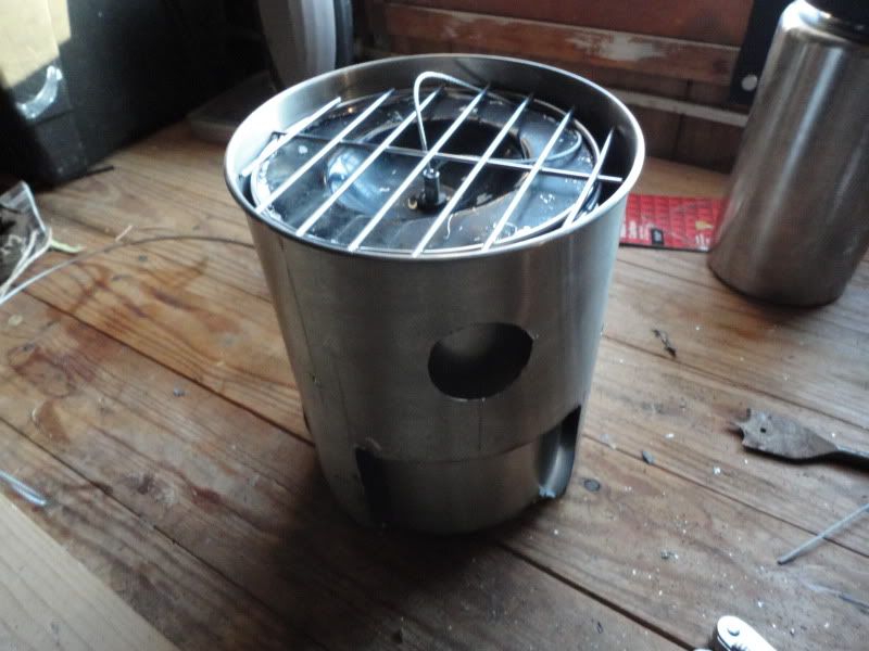

Cut out the grate for the inside. This grate was in a roasting pan I bought at a yard sale awhile back.

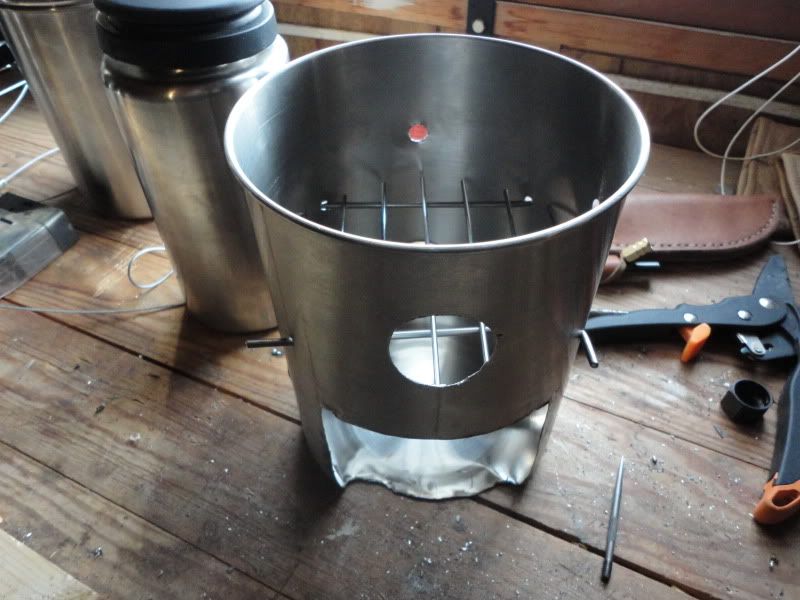

Made all the cutouts and drilled the holes. Then made the pins for the grate to sit on. This was some pin stock I had left over from something. The holes and fuel opening were done with a hole saw and a dremmel.

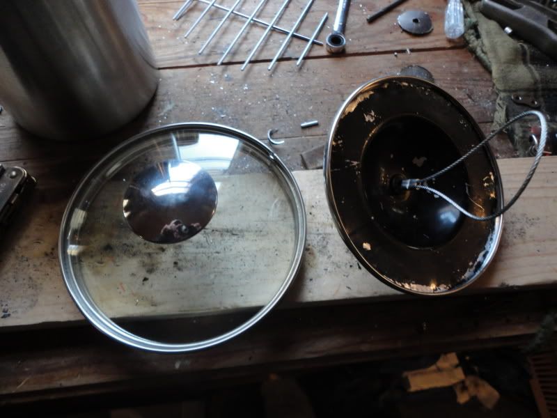

Needed a new lid for my pot. It came with a glass one like on the left. I broke the glass out and cut a metal lid and snapped it in place. Then made a loop for the lid. On a side not, I really didnt need to break the glass. I hit it 4 times with a hammer and it didnt phase it. Doubt Id do anything worse then that to it in the woods. Be cool to see the contents without having to remove the lid.

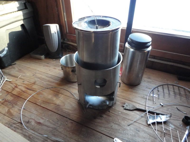

Heres the finished setup.
All packed up

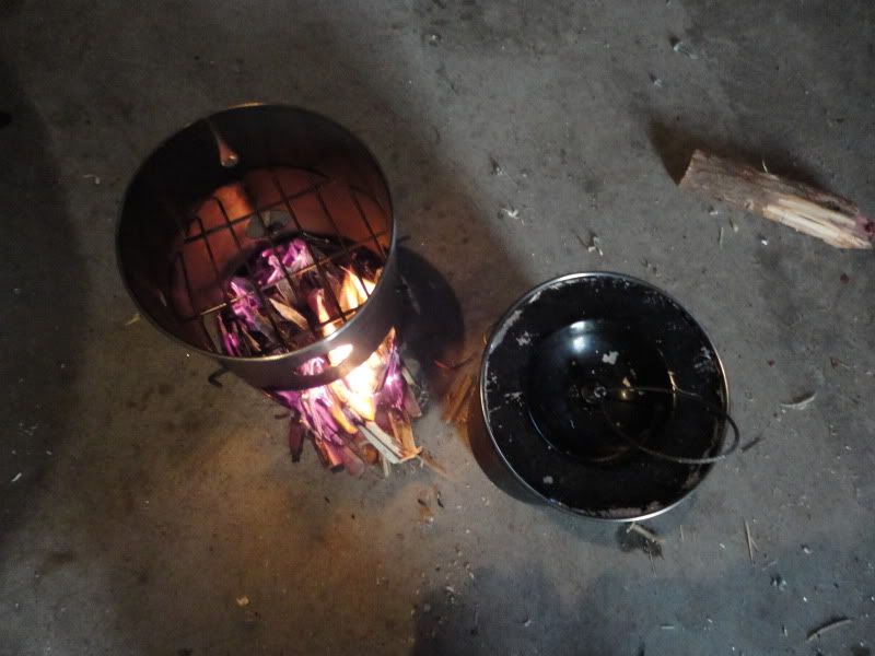

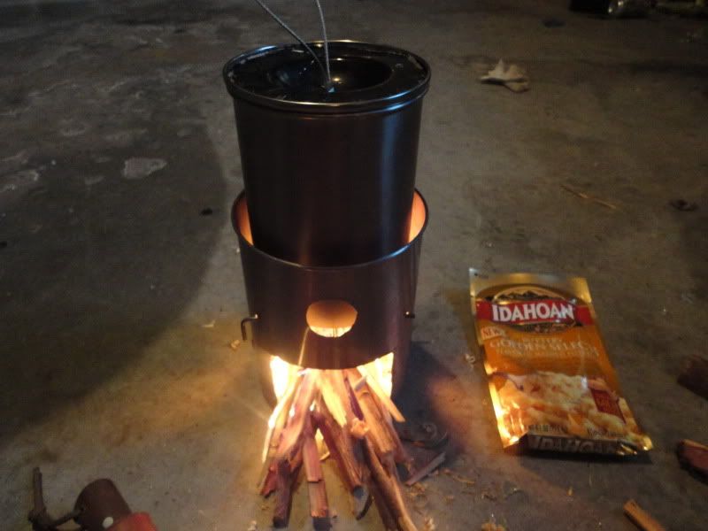

So now it was time to give it a try. Decided to make some spuds right there on the shop floor. Had doors open of course.

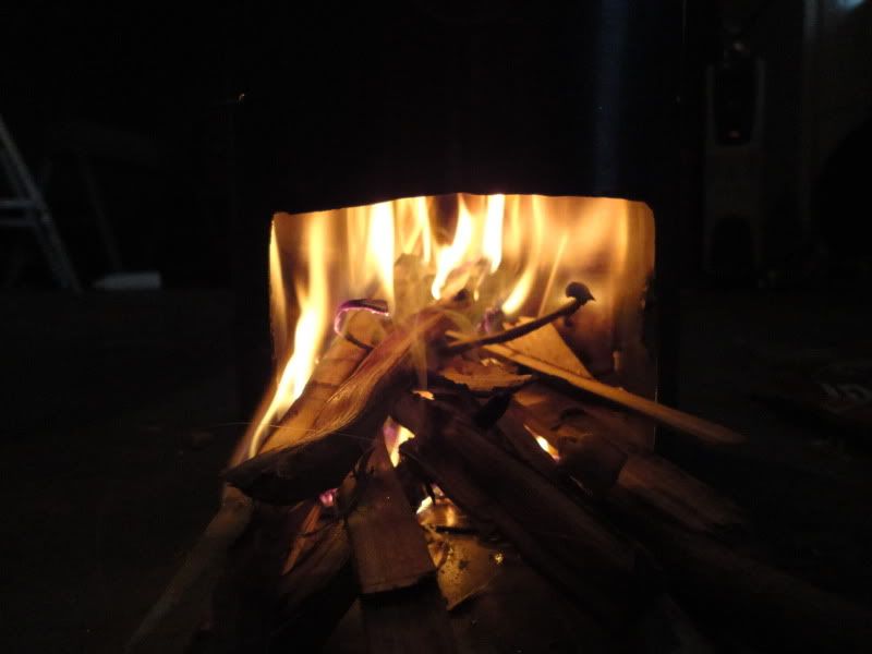

Fire it up!!
Not a bad lookin setup.

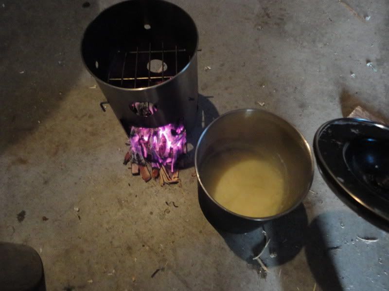

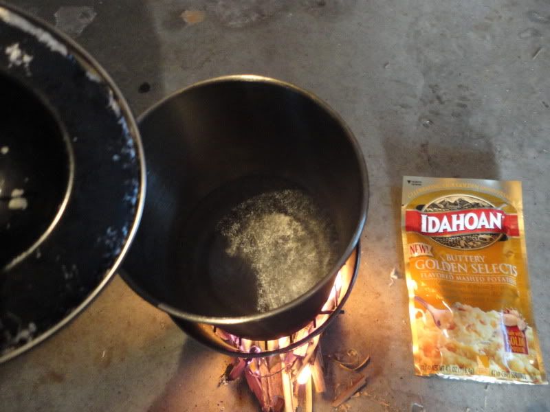

Freakin 2 cups of water boiled in no time. Like 4 minutes.
Waitin on taters.
Done
These things are pretty neat. The billy pot turned out nice. Its sturdy and a good size. Im gonna rivet on some loops for the bail to attatch to, and I have plans to do a smaller pot up like a Mors pot.
