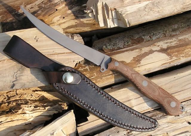

This is a photo that "Last Visible Canary" posted of a Busse Fillet. This is very similar to what I want my end result to be.
You didn't mention grinding or heat-treating; what equipment do you have? If you have a belt grinder I would advise drilling your tang holes, cleaning up the surfaces and grinding the profile, then HT, then grinding your bevels. If you only have files etc to work with, you'll have to do almost all your stock removal before HT; with pieces that thin it could lead to warping in the quench. I recommend Peters' HT, they are very picky about keeping things straight and clean.

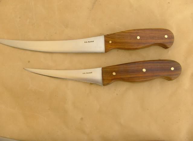

440 C is a good choice, I use precision ground 1/16, profile the final shape prior to heat treat and grind the bevel after heat treat. I dont know if the stall matt is stable in saltwater, some rubbers will get sticky and corrod, I have not tried it but you may want to put a piece in a glass of water with salt and see if the texture remains the same. Because the thin steel is flexible I think pins or bolts are needed to keep the epoxy from breaking loose, I peen my pins so they provide a mechanical connection, when the expoxy is setting the only clamping pressure is from the pins, this way I am sure to get a good bond and mechanical connection. Stall matt is different and may not need pins as advised. I think texas knifemaker is the least expensive heat treat if you are only doing a few blades, check them out. 1/16 is really flexible so HT to 58- 59 is fine and will hold a good edge.
Patrick, thank you and that is a great looking fillet!!! If you don't mind me asking, where do you get your steel?? 1/16" precision ground steel has been impossible to find!
