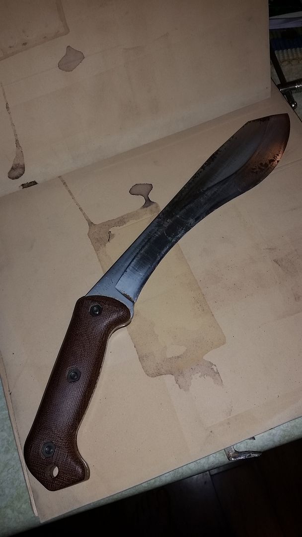

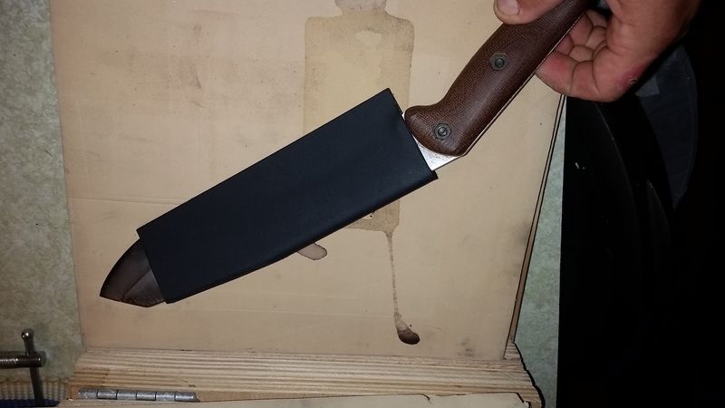

I started making my own kydex sheaths awhile back because I have too many knives to pay someone to make them! LOL. The one problem with kydex though, it can be difficult to design the sheath so the knife inserts with no resistance whatsoever until you get to the point where it locks onto the handle. Im very picky about this. I like to be able to pop the knife loose with my thumb and draw the knife with zero resistance. On a recurve blade this is tricky. I decided to make a kydex over garment for the knife that is as wide as the widest point of the blade. This will be on the knife when the kydex sheath is made and then removed afterward. This should make the recurve portion of the blade irrelevant, I hope. LOL.
This probably isnt news to anyone who makes kydex sheaths, but its the first time Ive tried it.

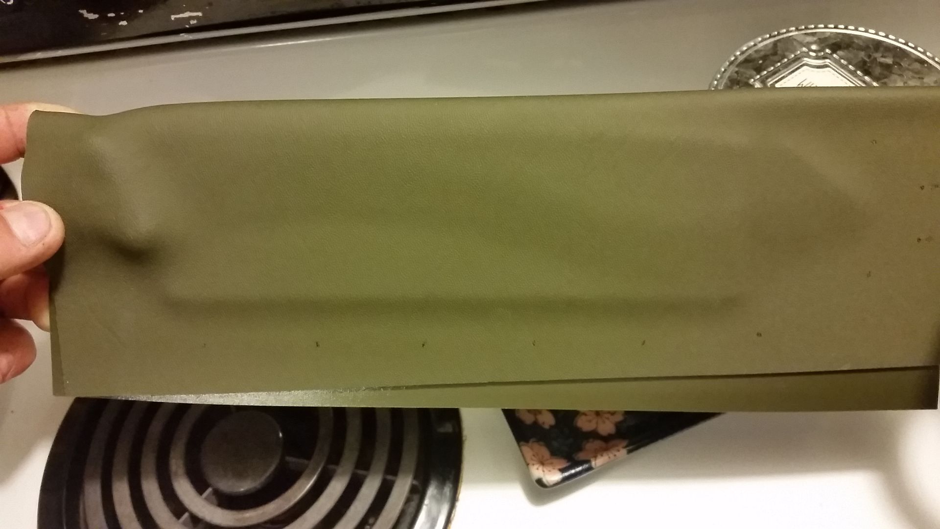

First step, make the insert and shape to the spine profile
I like this way because you still get to see the shape of the blade after youve heated the actual sheath around the insert.

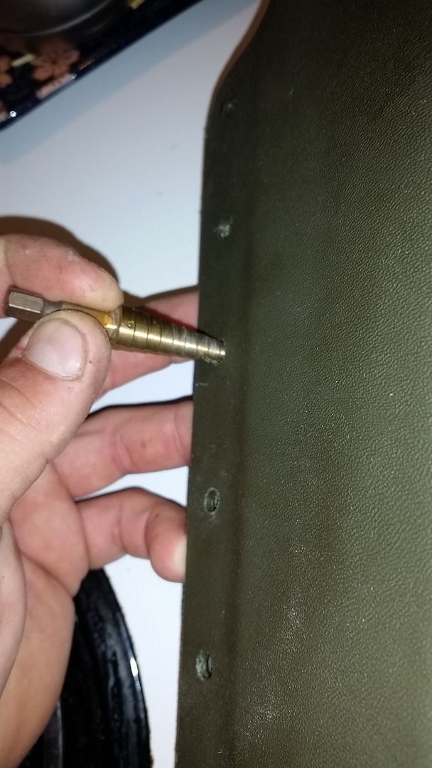

drill your holes, clean out the swarf in the holes with a step bit(by hand!)

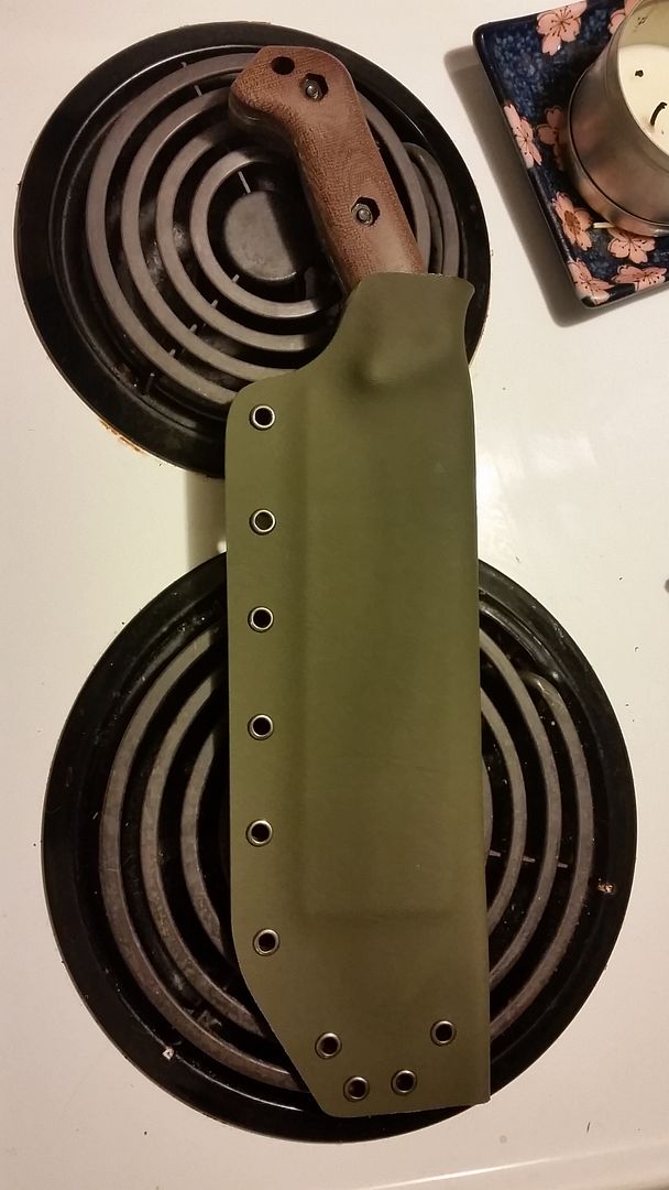

cut and sand your sheath to shape and boom!
Next installment is a leather frog and a dangler.
