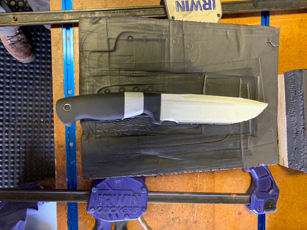

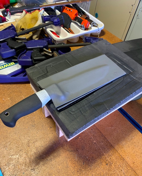

Three layers of masking tape go all over both sides of the blade (and spine) to create a small space inside the sheath to prevent rubbing and scratching
Sitting on the press, ready for the hot kydex
Both pieces of kydex get heated for a few minutes (until they are soft enough to be floppy) at about 100 degrees C (about 210 F).

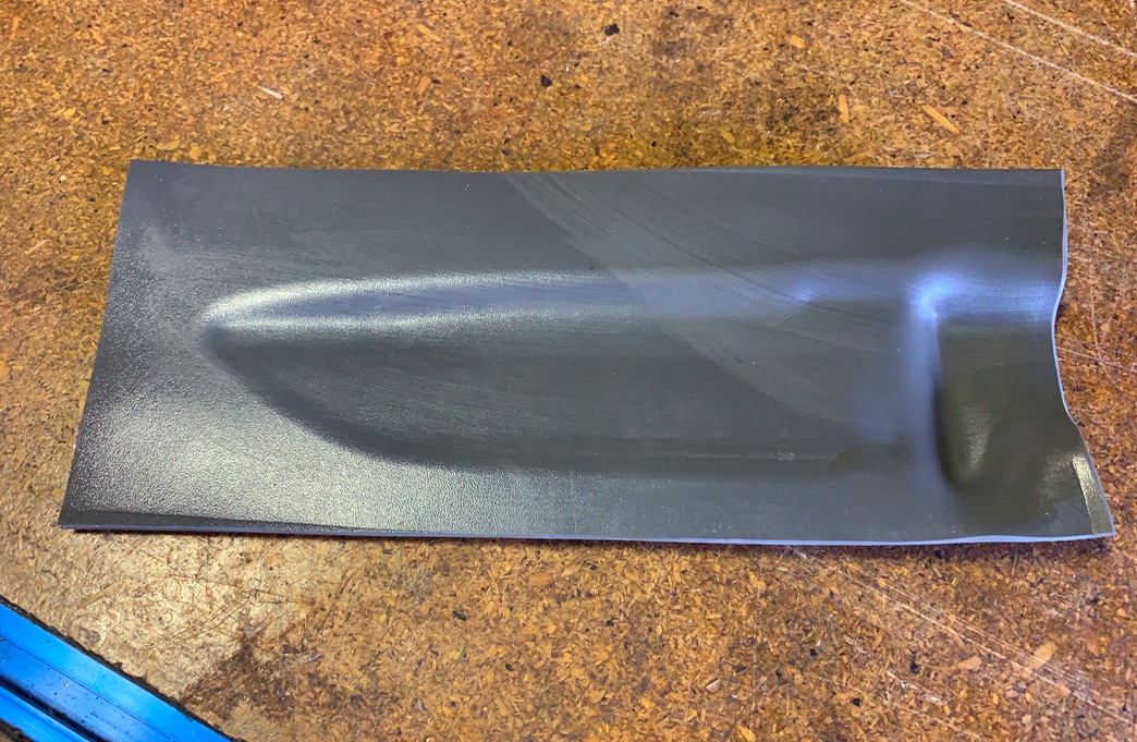

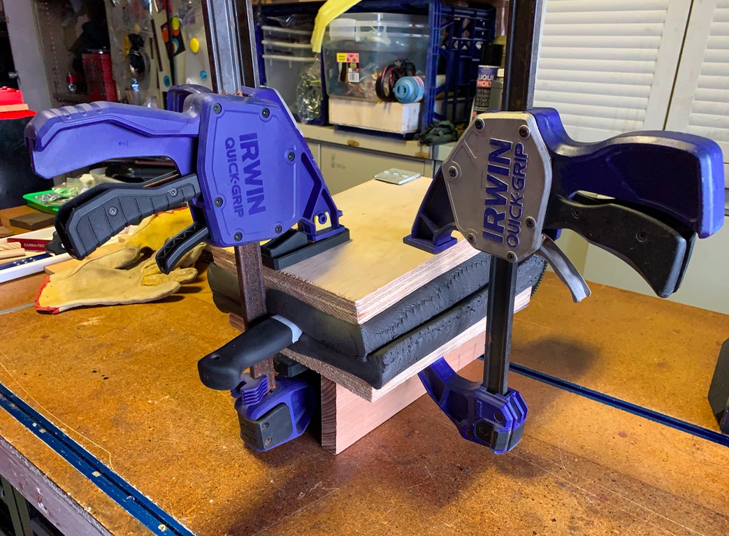

Then quickly put the first piece of kydex on the foam, then the knife on top, then the second kydex on top of that, and clamp the top of the press down tight as fast as possible. The kydex cools and stiffens quickly! Leave it for five minutes until the kydex is cool and stiff.

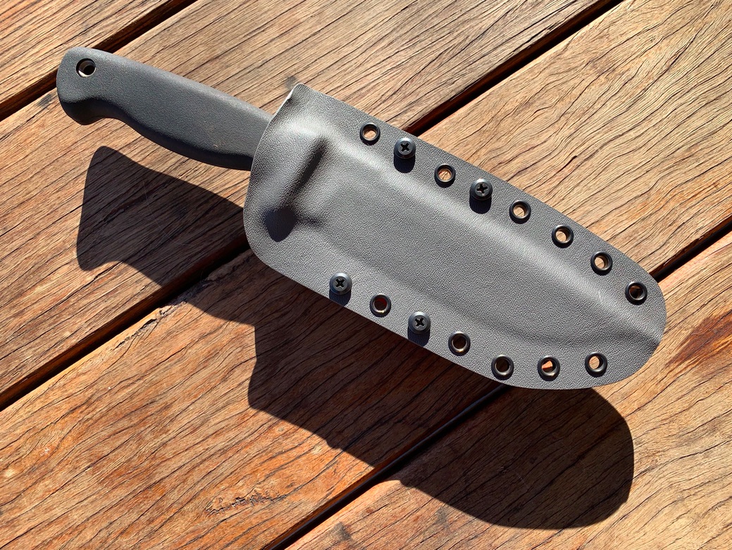

The result
I got it wrong the first time. There isn't enough room below the blade edge for the rivets, so I had to do it again.
What it look like on the inside

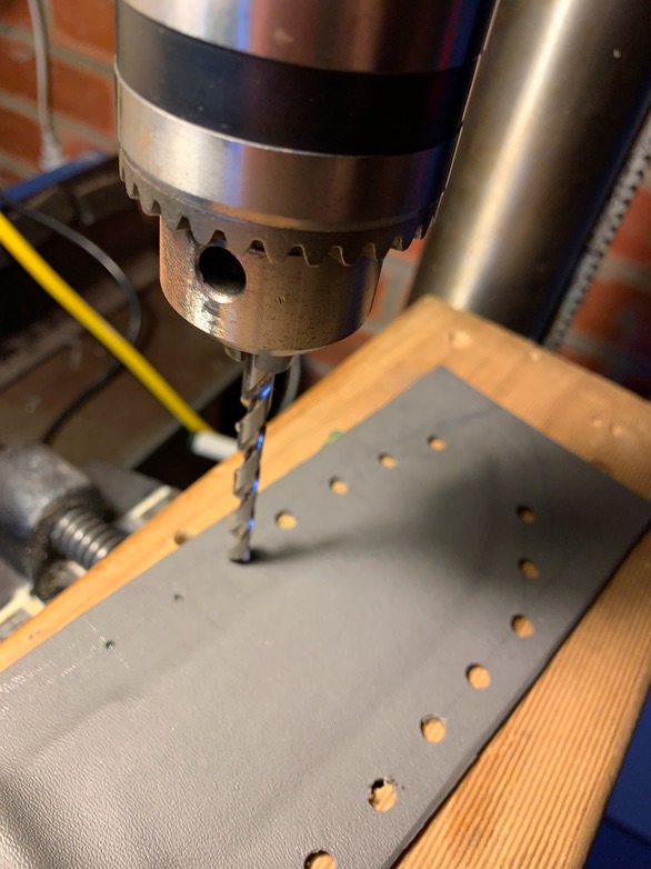

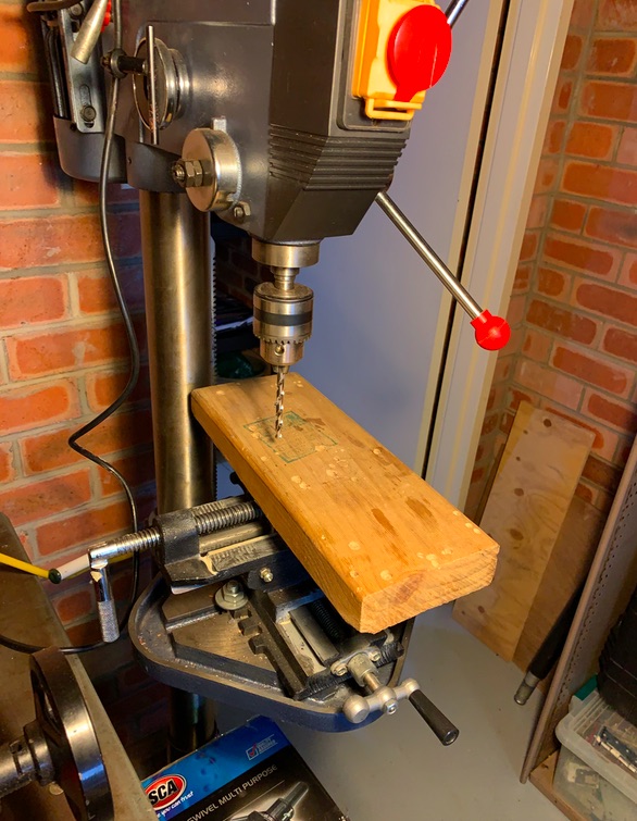

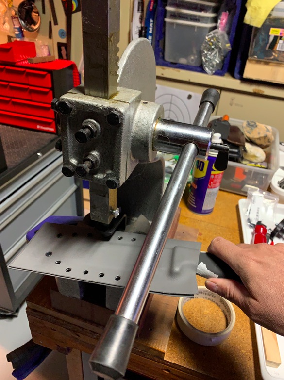

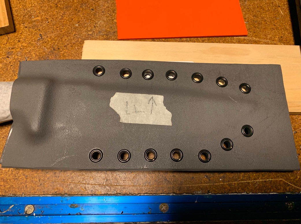

Ready to drill the rivet holes

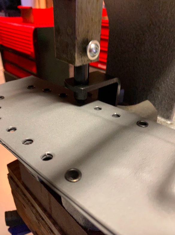

Putting the rivets in. This tool (can't remember what to call it) clamps both sides of the rivet onto the kydex and squashes them together into a single piece
Rivets complete

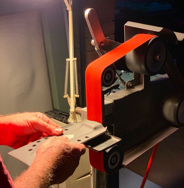

Shaping the kydex on a belt grinder, so it follows the curving line of the rivets

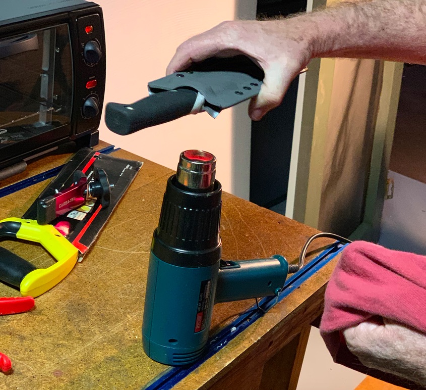

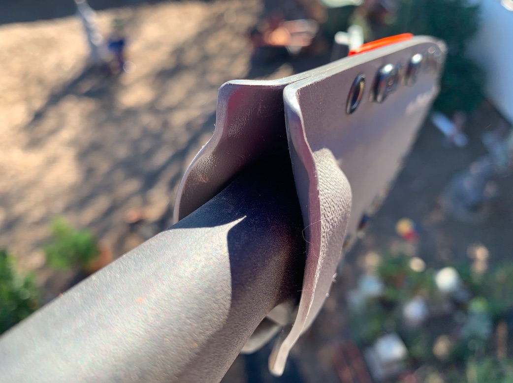

Heating it up with a heat gun to shape it so it locks tightly over the handle
Lots of fiddling around with the heat gun: bending the kydex a bit, more heat, more bending... until it is just right
Cont...

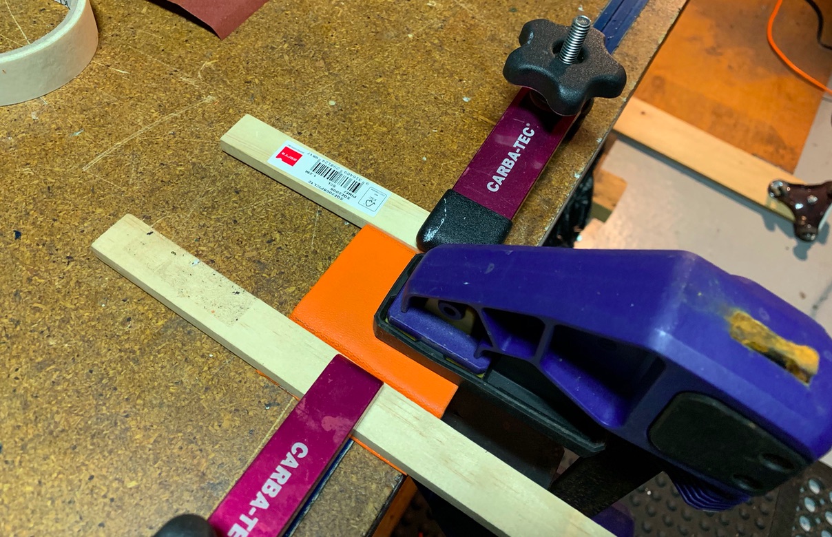

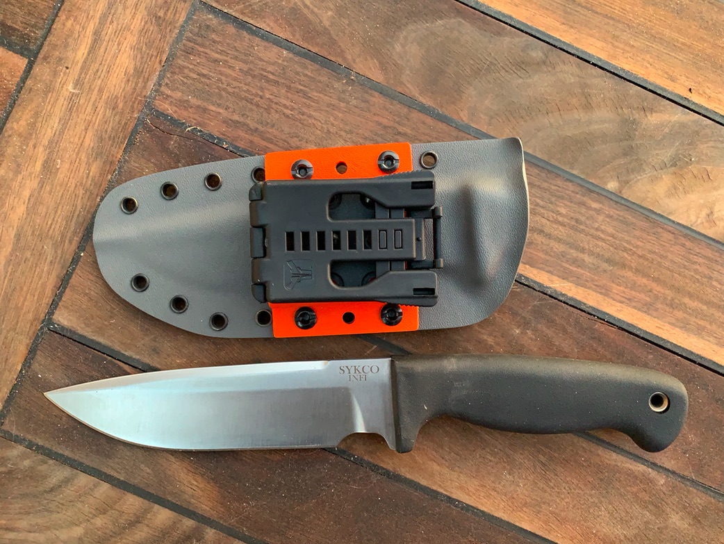

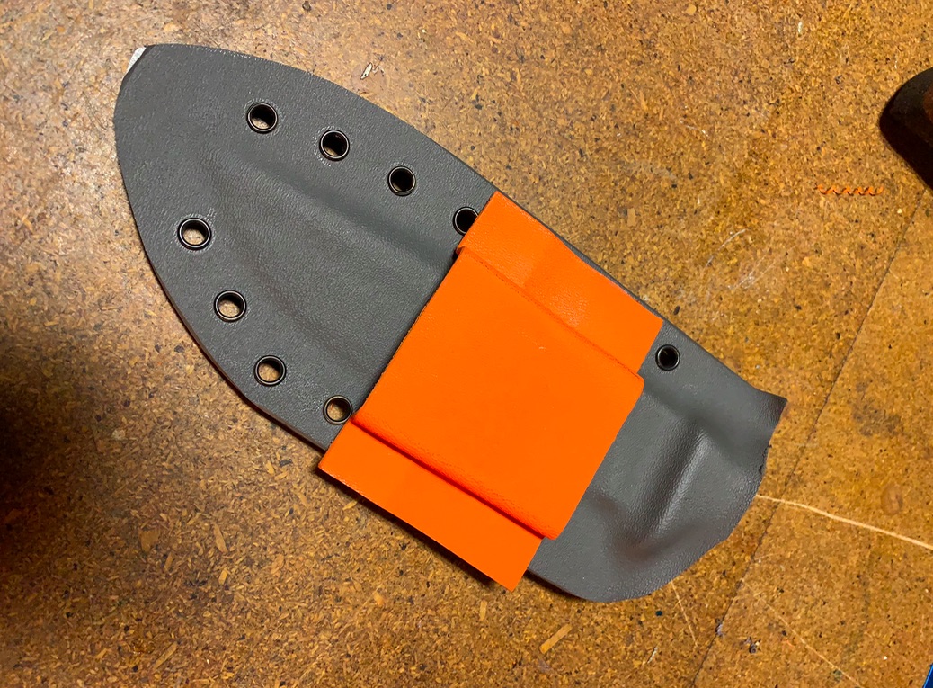

Creating the bridge: Cut the bridge to shape, then heat it in the oven until soft. Then it goes over a wooden jig (hidden under the kydex here), with two more bits of wood either side, all clamped down as quick as possible. Leave it to cool.
The result

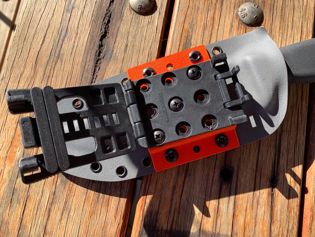

Then drill more holes, put in rivets, attach it to the sheath and put on a tek lok
Using a bridge lets me use three screws for a super secure attachment. The bridge also helps the sheath sit out a bit from your belt so the handle doesn't dig into your side.

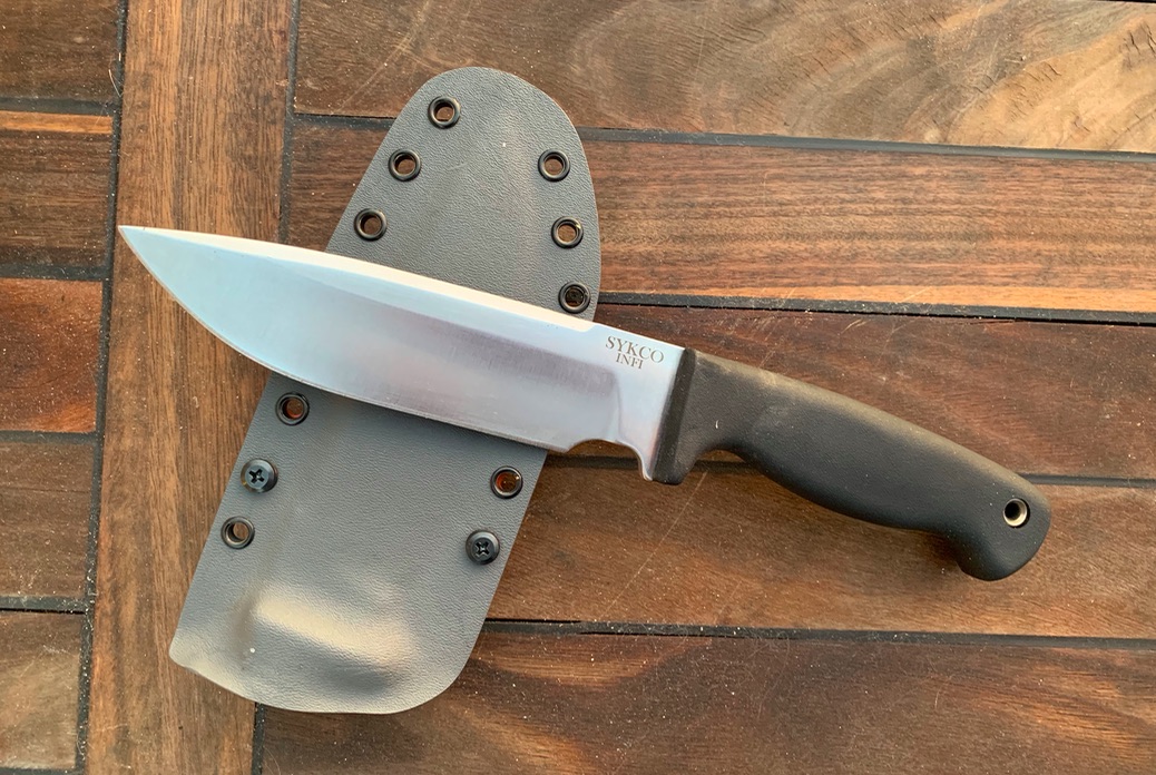

The finished product
I had a lot of fun making it !!!

Really great post, but, left me wondering:
Do you always use a Tek Lok in this manner - hinge down or do you carry tip up?
I've had a couple of times where it opened and the only reason my knife didn't fall off is because the hinge was on the top edge of my belt.
This is for carry tip down in the normal way. I find it easier to take on and off this way. I just engage the lock to ensure it doesn't open.
