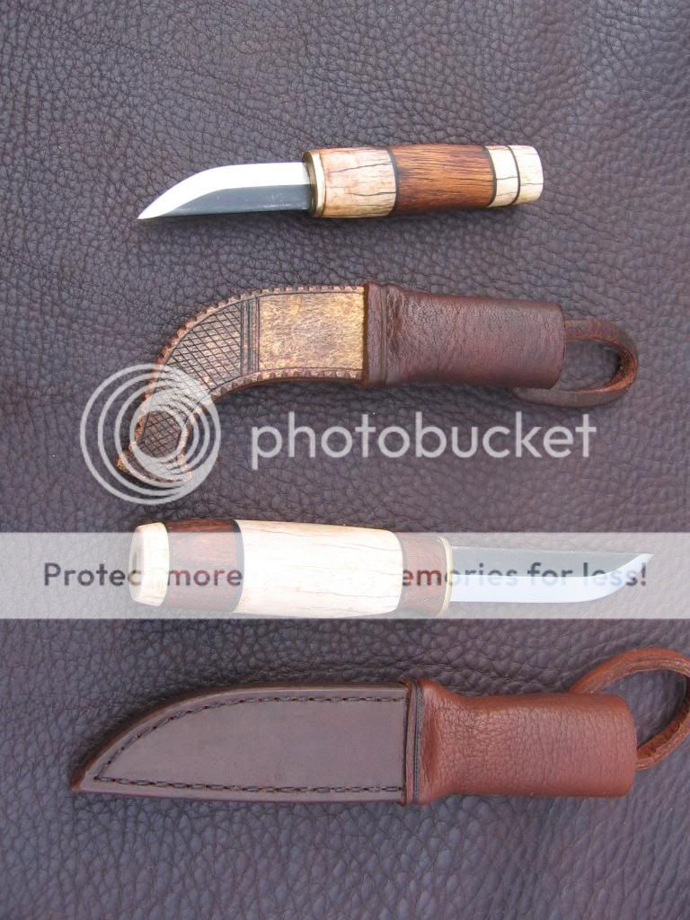

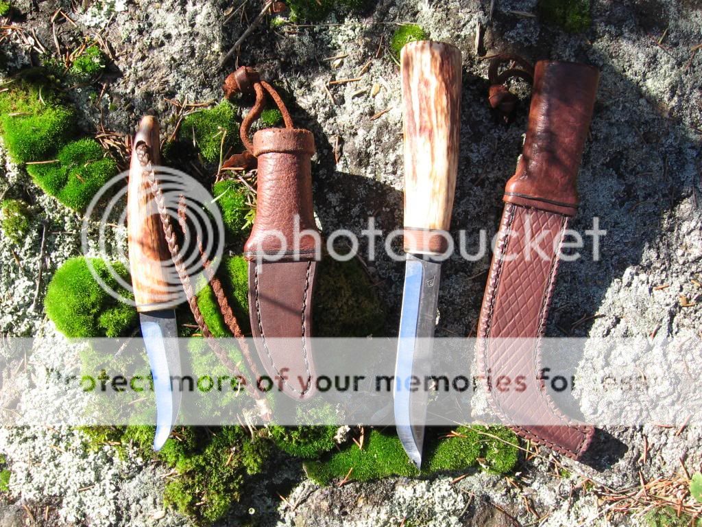

Here are a few with stick tangs, Finnish blades. Segmented handles require a lot of fitting at the segment joints but drilling for the tang is easier with hand tools. Single piece handles pretty much require a drill press and long bits. One thing you could consider is old carving knife handles in stag as the hole is already drilled. I always mix bone/antler grindings mixed with epoxy to fine tune the fit of the tang. Here are some pics. If you need any help I'd be happy to tell you how I do things, just message me.

Are those blades from Brisa?
