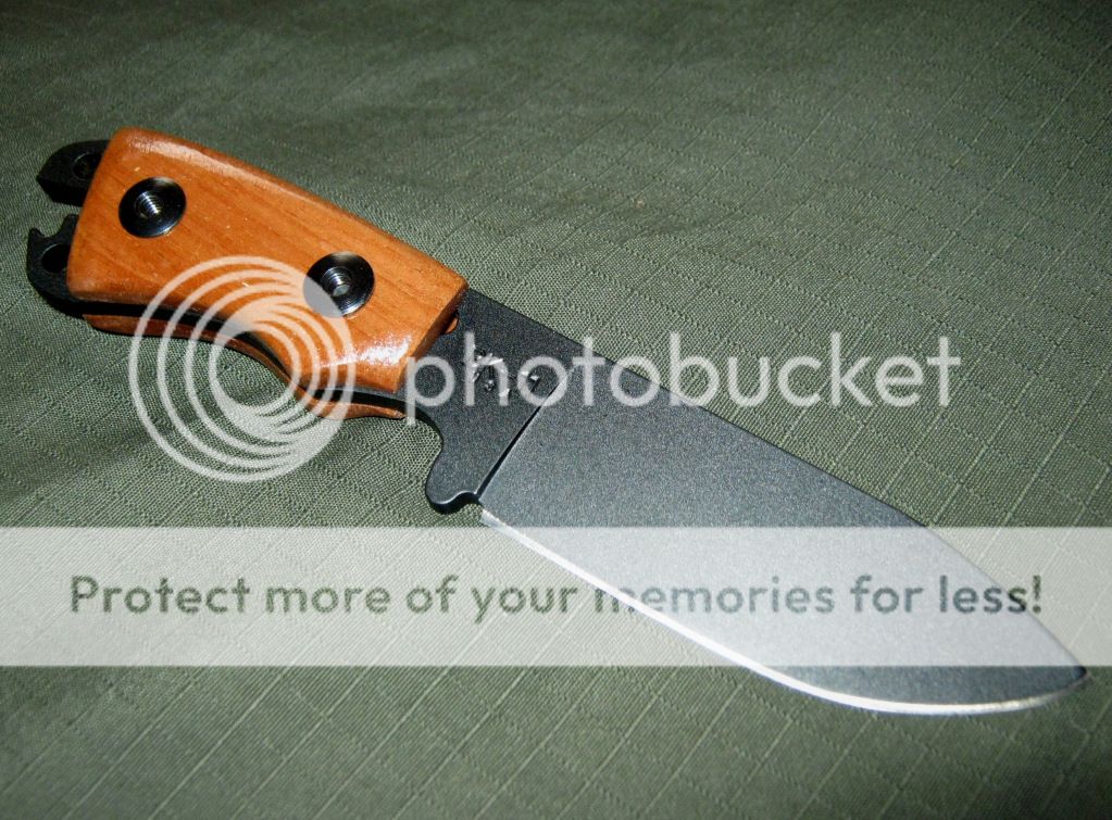

Hello all. I have searched for micarta handles for one of my knives, but unfortunately there is no sale in my country. So i decided to make home a wood handle to the knife (BK 11) and I'm sharing with you the stages...

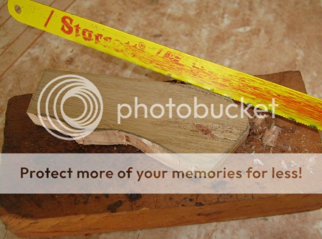

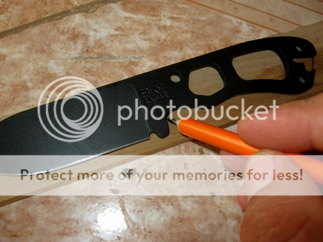

Initial marking..
Removing edges with little saw

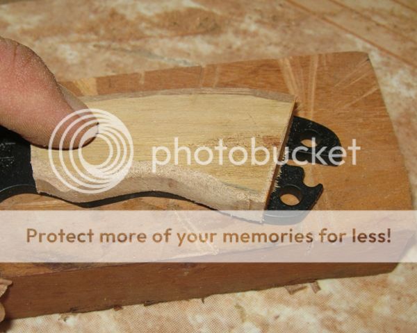

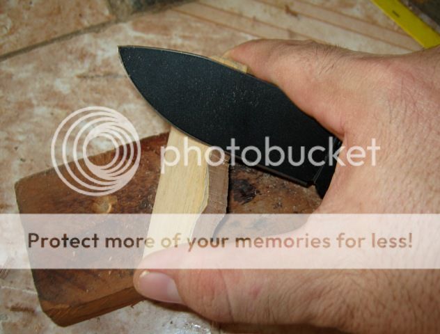

Making the concavity with blade (pictured has only one hand but I used both:D:D)
Verifying measures...
Sanding concavities with coarse sandpaper (aid of plastic pipe)

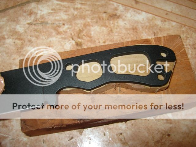

New measures (with ends removed to enter the sheath and paracord)

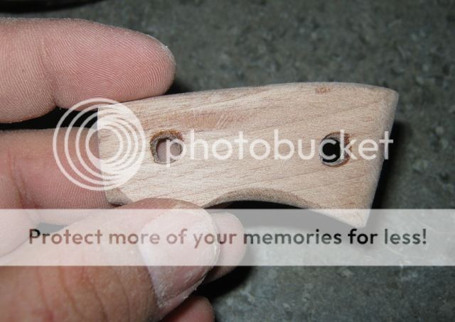

After sanding and fairly with drilled holes

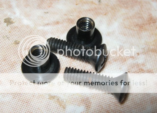

Screws used

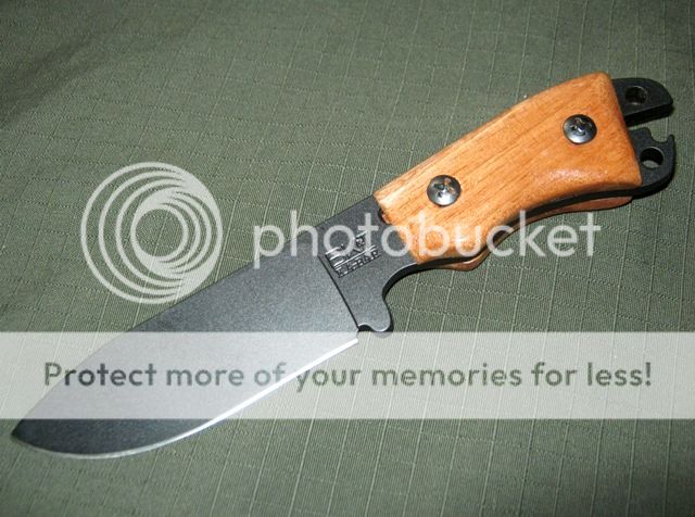

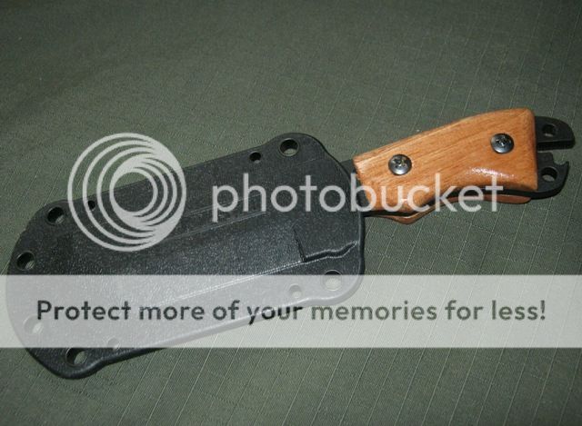

Ready handles, placed in the sheath after the use of varnish...
Work completed..
I hope you enjoyed!;)
