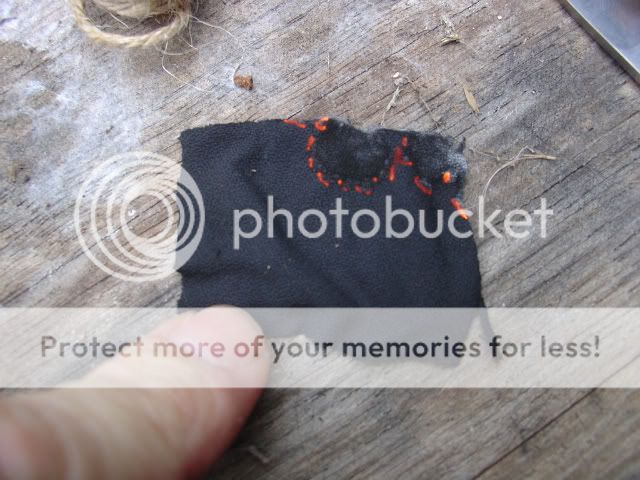

There are many ways to make char cloth, heres one of my favorites due to ease of clean up
supply list- cotton, something hot(small fire or sterno), aluminum foil, and a rack or grate to set it on
Step-1 get some cotton roll it up 3x40in in two layers of heavy duty aluminum foil
Step-2 poke a hole in the foil with a needle and place over heat source, in this case I used a sterno can
Step-3 leave it on the heat until smoke stops coming out of the hole then plug the hole with a toothpick or pin to prevent oxygen from getting in the foil and combusting your charcloth. When its cool to the touch, unwrap it.
This will give you about 36in of charcloth, like this.
I used to make little 4x4in strips but I use it so much this way is more time effective for me. Then, take a carbon steel knife or your favorite striker.
Set the charcloth on a piece of flint/chert and strike it with the striker/knife. If you did it right, you'll catch a spark and ignite the charcloth.

I make my char cloth in a altoids or similar tin. Poke a small hole in the top of the tin to vent the gasses. Place the tin on some coals or a small fire so you are able to watch the smoke coming out of the hole you made. When the the tin stops smoking the char cloth is (usually) done. Only takes a few minutes. Pull it off the fire, let it cool for a bit (doesn't take long) and open up. All of the cloth should now be black like charcoal, if there is any brown on the cloth throw it back on the fire and do it again, will take even less time for the smoke to stop. 100% cotton works best, I use old t-shirts. Cut them into 2"x2.5" rectangles (depends on the size of the tin). Only put a few in a tin at at time, the will char better and faster. I usually won't do more than 5 or 6 pieces of cloth in a tin. I also have about 4 tins I use all at once to make up big batchs. I like to keep a bag of already cut up t-shirt rectangles on hand so I just have to put some in a tin and fire them up. I have a tin in my fire kit that holds my striker, a piece of flint ,and a thick stack of char cloth (just be careful it tears easily). The cotton pieces will shrink a bit when they char. I can usually get away with using half of one of the pieces to start a fire, but it is much easier with a whole one.
