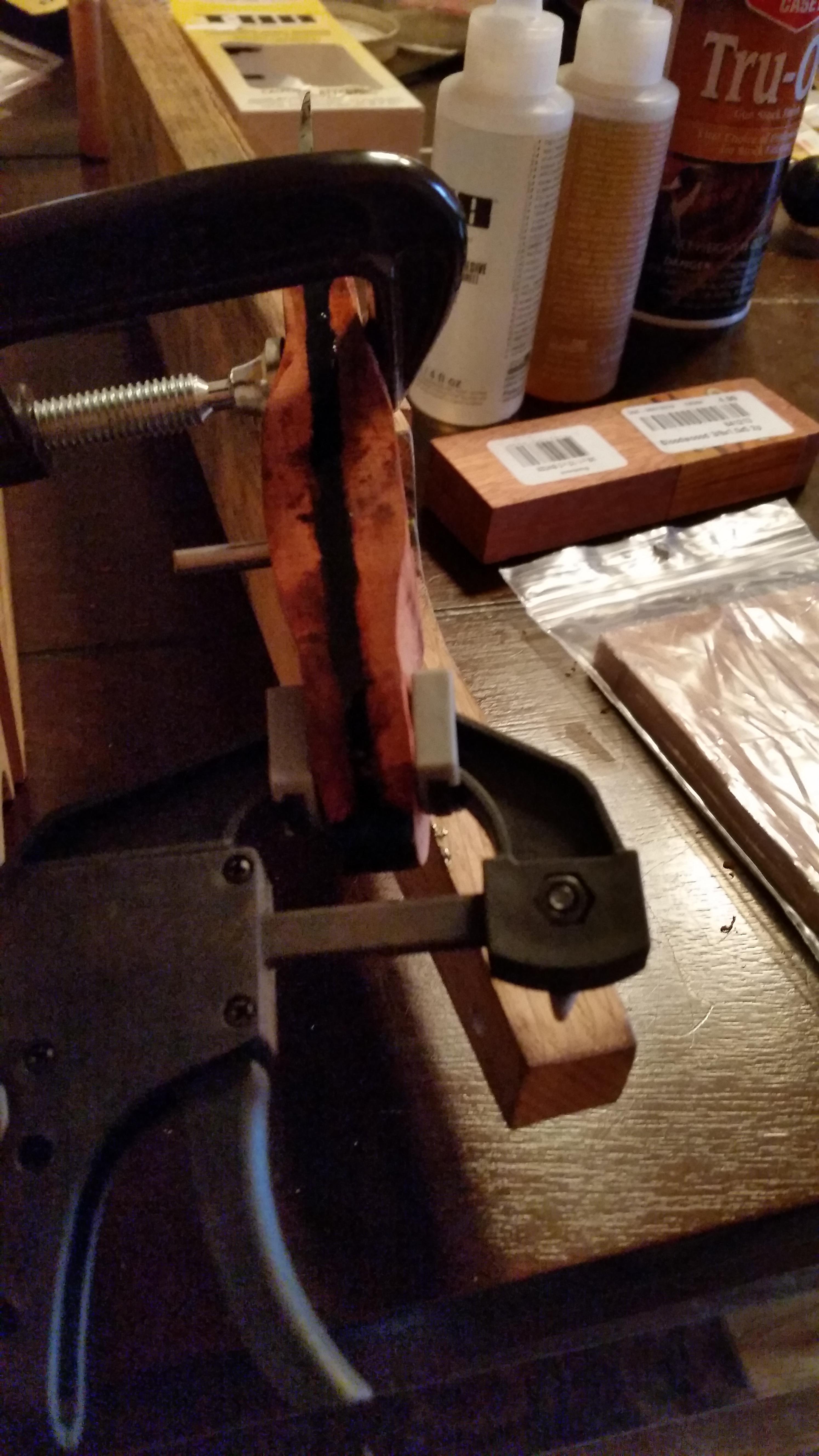

Now go mix your epoxy. If you bought quick setting epoxy then you need to move fast. The stuff I have I can mess around with for about 45 minutes before needing to leave it alone to cure.
Have what you need to mix and apply the epoxy in front of you. Also have the pins, scales, blade, clamps, and hammer in front of you. Have several rags or paper towels, too. Lay some newspaper down on your table to catch drips and so you can lay the stuff down .
Take the epoxy and smear it all over the inside of each scale. Push a little extra into the pin holes. You don't need a ton of the stuff but you want just a little bit to squeeze out when you clamp it.

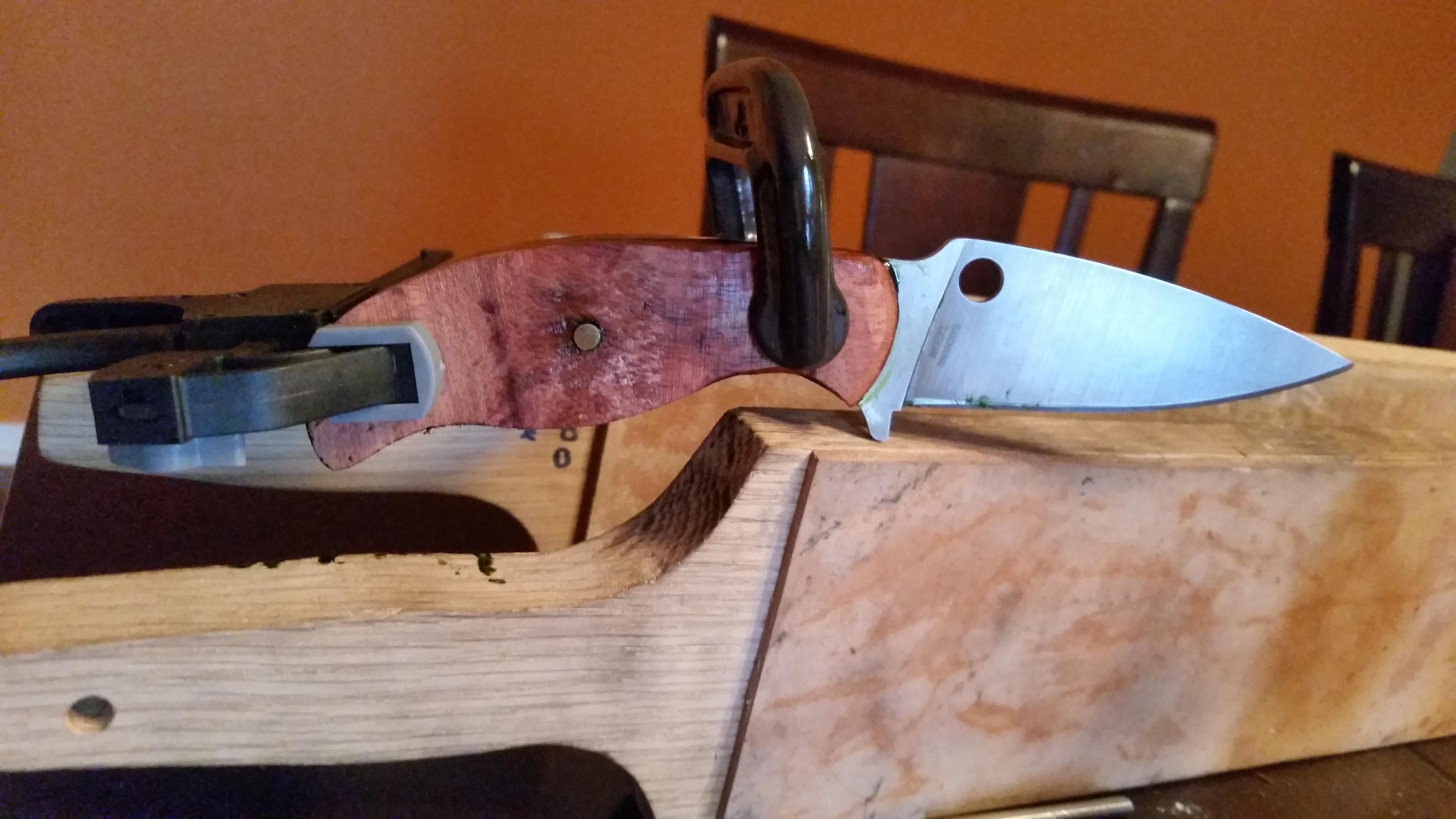

Now push the pins into one of the scales. Put the knife blank onto the pins. Put the other scale on.
Clamp all of the stuff together. Wipe off the epoxy coming out just to keep things a little neat. Don't worry about getting epoxy on anything on the outside, it's going to be sanded off anyway. Set the clamped up knife on something and let it sit overnight.

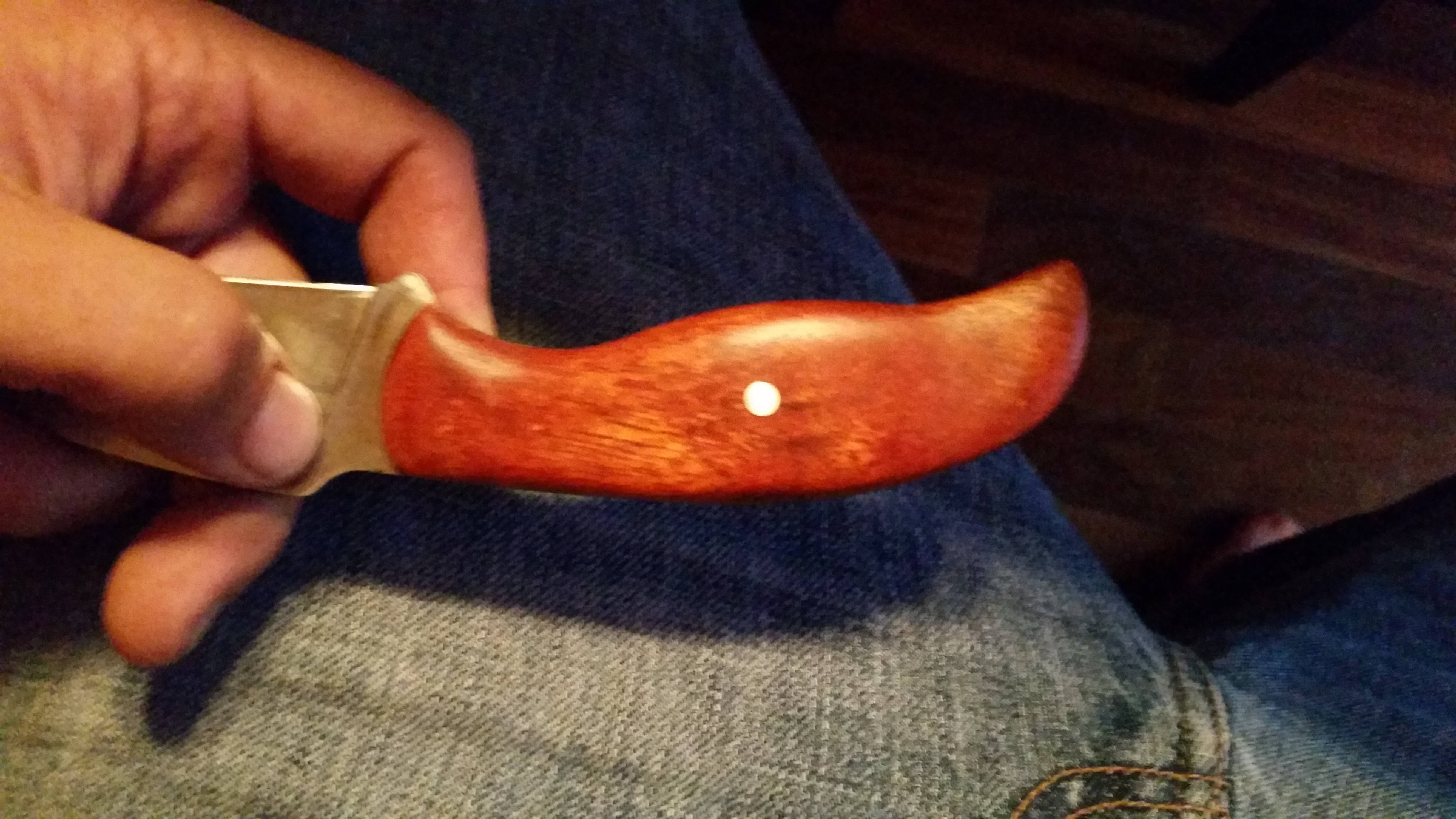

Heres mine curing right now. It's a single pin. I could've had a lot more but with this knife it'd be purely for aesthetics.
Notice the extra epoxy and long ass pin? I made a mistake on my first knife and this is me making up for it.

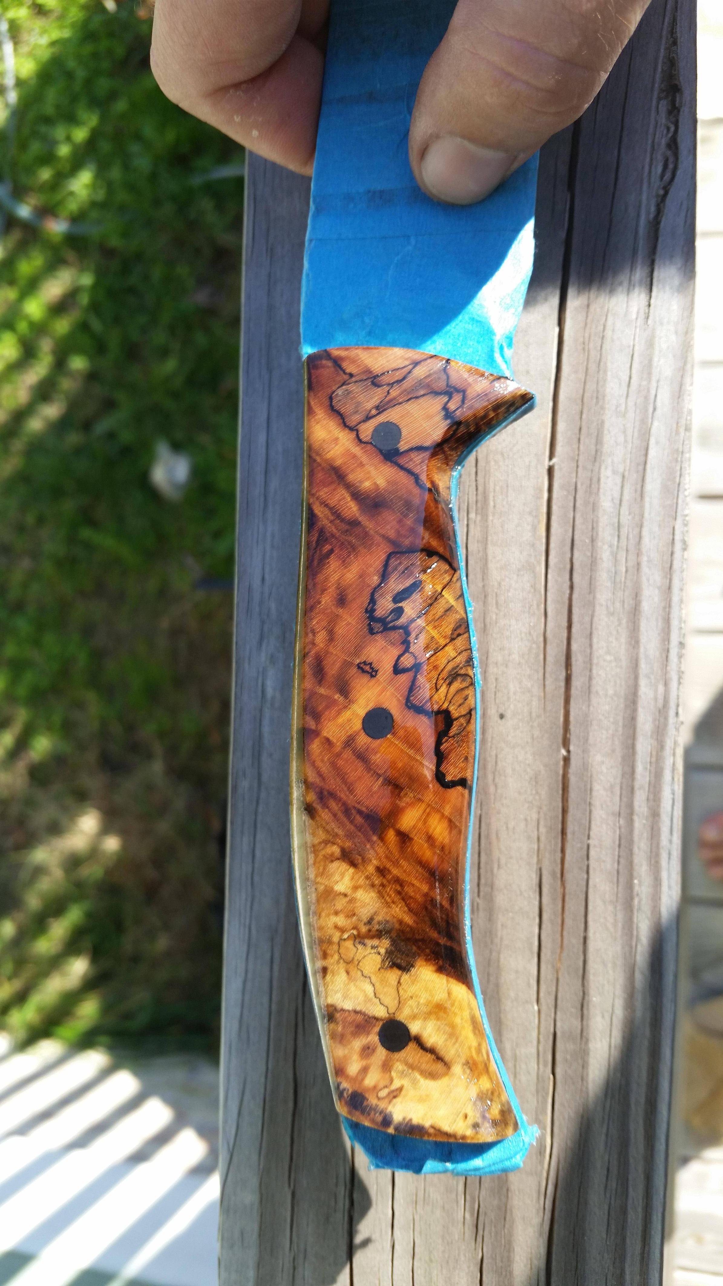

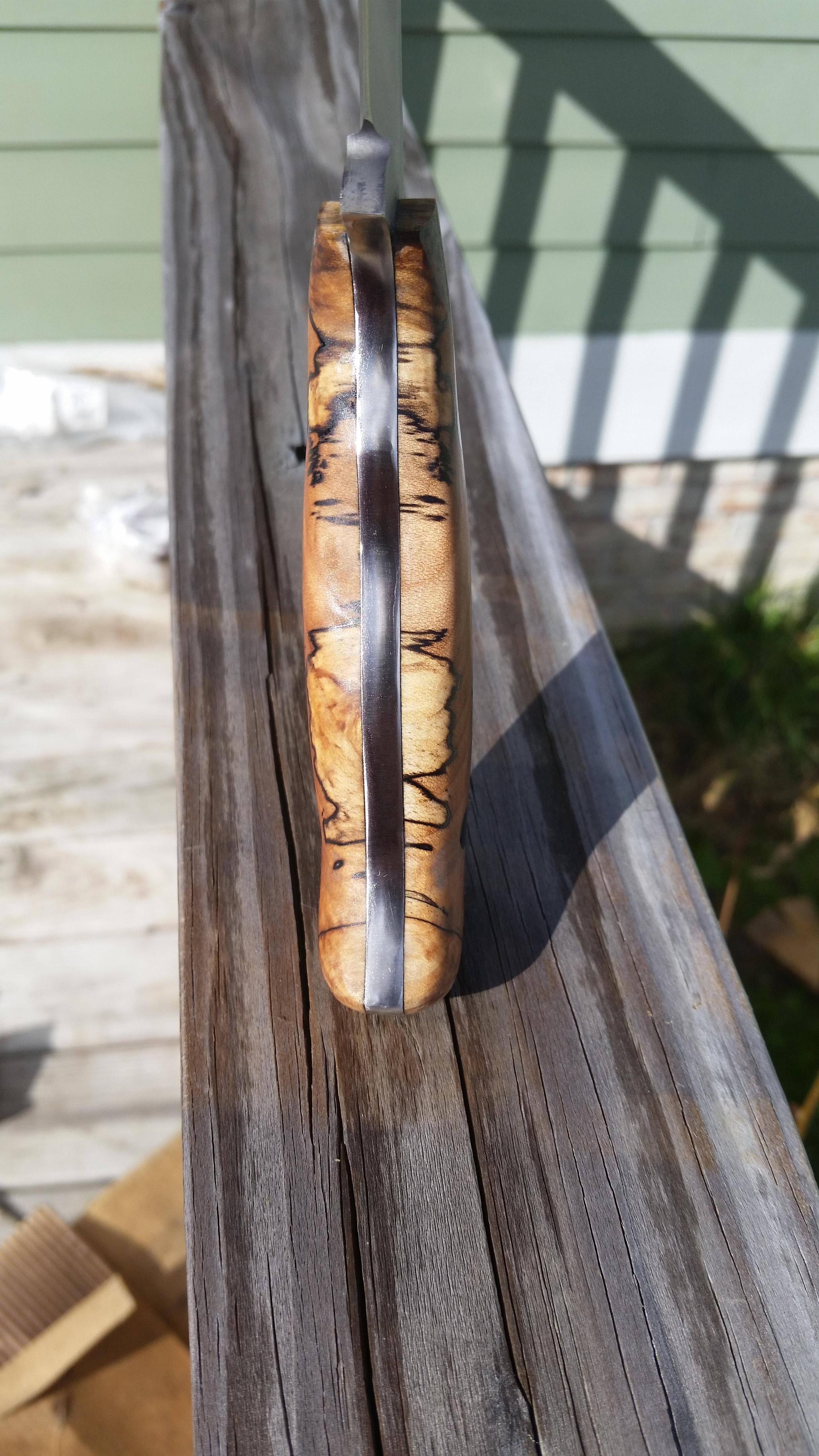

The next day take the clamps off. Now you have a rough knife. Go sand it down to its final shape. Whatever you feel comfortable with. Thin, fat, round, or square. Your pins should be as easy to sand down with the belt sander as the wood. Remember to go slow.
Now that you have a knife with the handle shaped how you want it, take the sandpaper sheets and remove the belt marks. 80 grit belts leave a fairly nasty looking finish after I'm done removing the scratches using the sheets, it looks nice. This is the most time consuming part, hand sanding it. It'll take at least an hour to just get the belt's scratches out, depending on how hard the wood is.
Once that's done you're pretty much set. Take some gunstock oil or similar and smear it on. You have yourself a knife with handles made by you for you. Total time to work it is maybe 3 hours, and that's pushing it. Letting it cure takes 12 to 24 hours, that gives you time to come onto the forums and share just how easy it is. The total cost? About $150 to buy what you need. For the knife specifically? Well, if you spend $5 on the scales, then about 8 bucks. Most of the stuff you can use for other things.

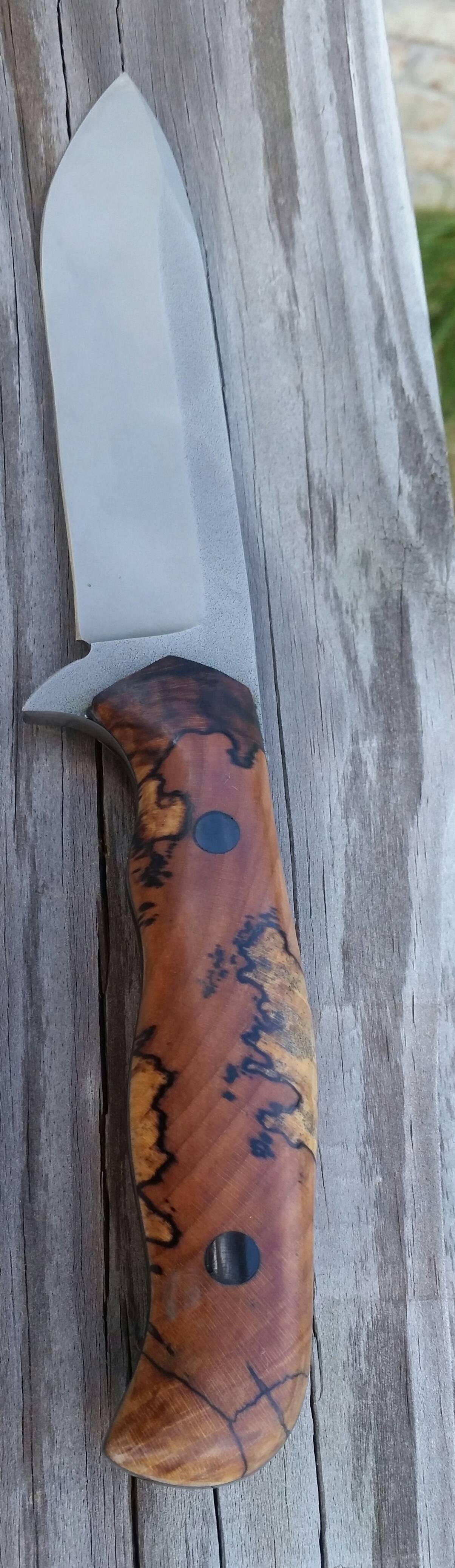

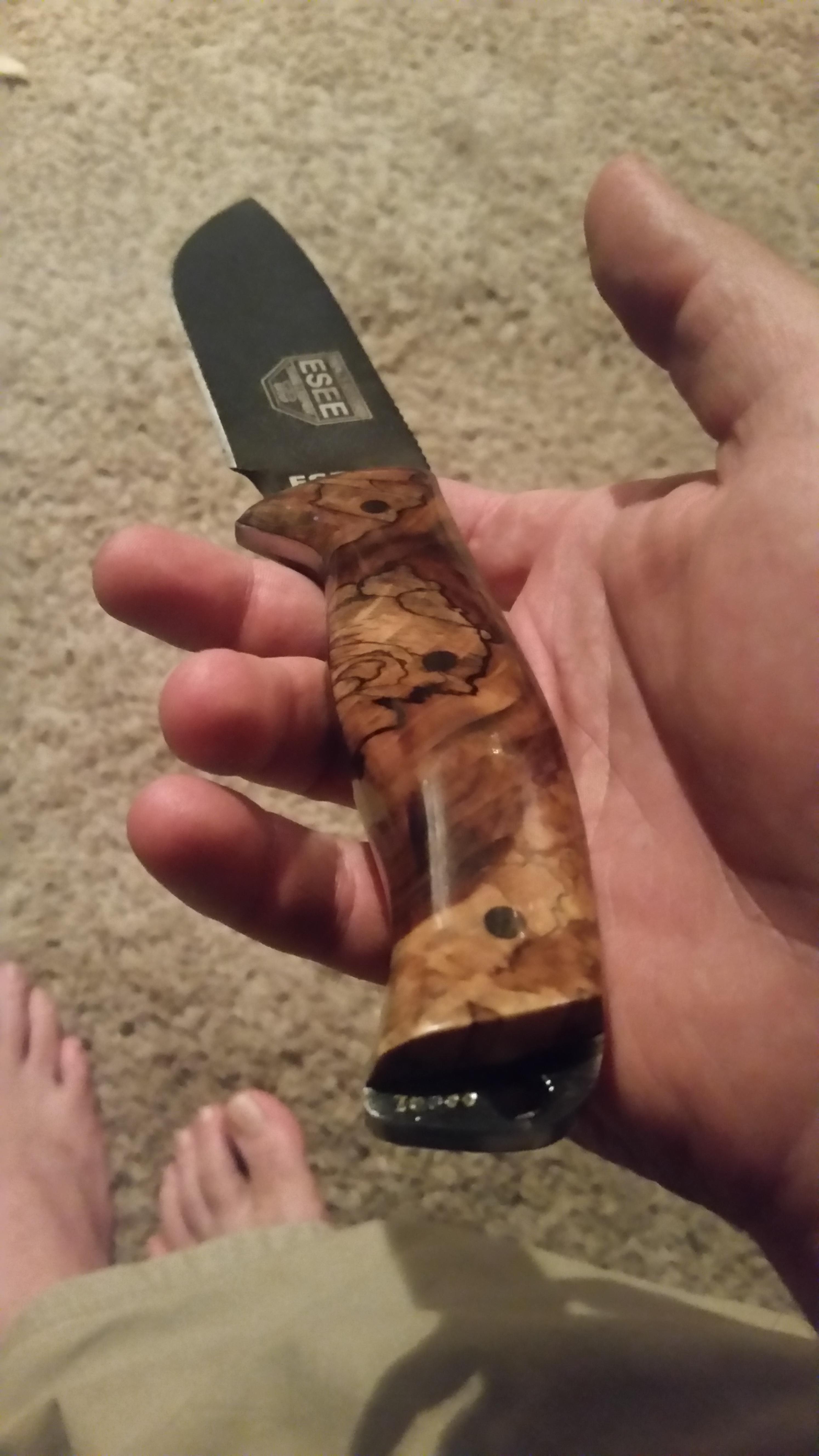

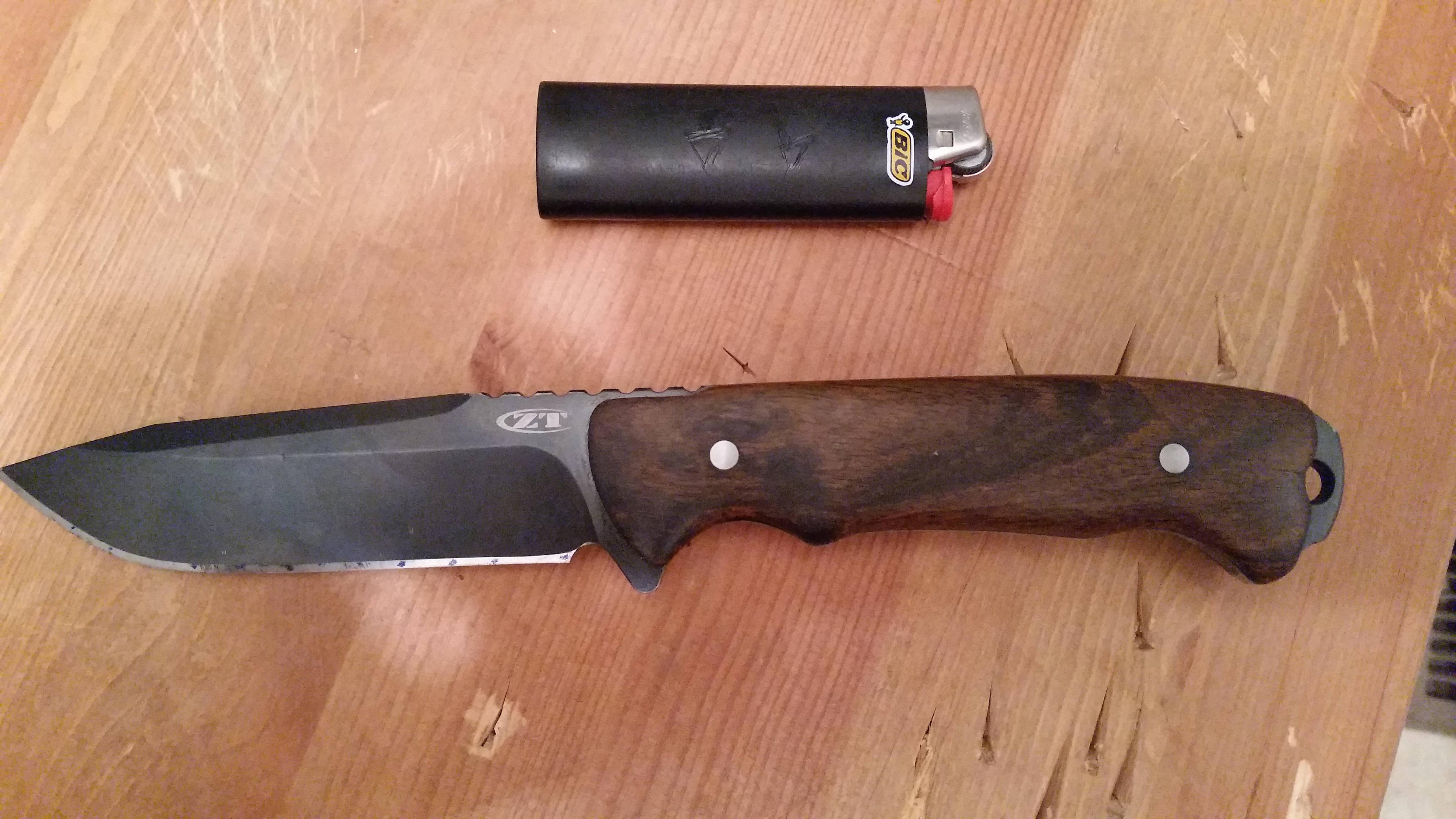

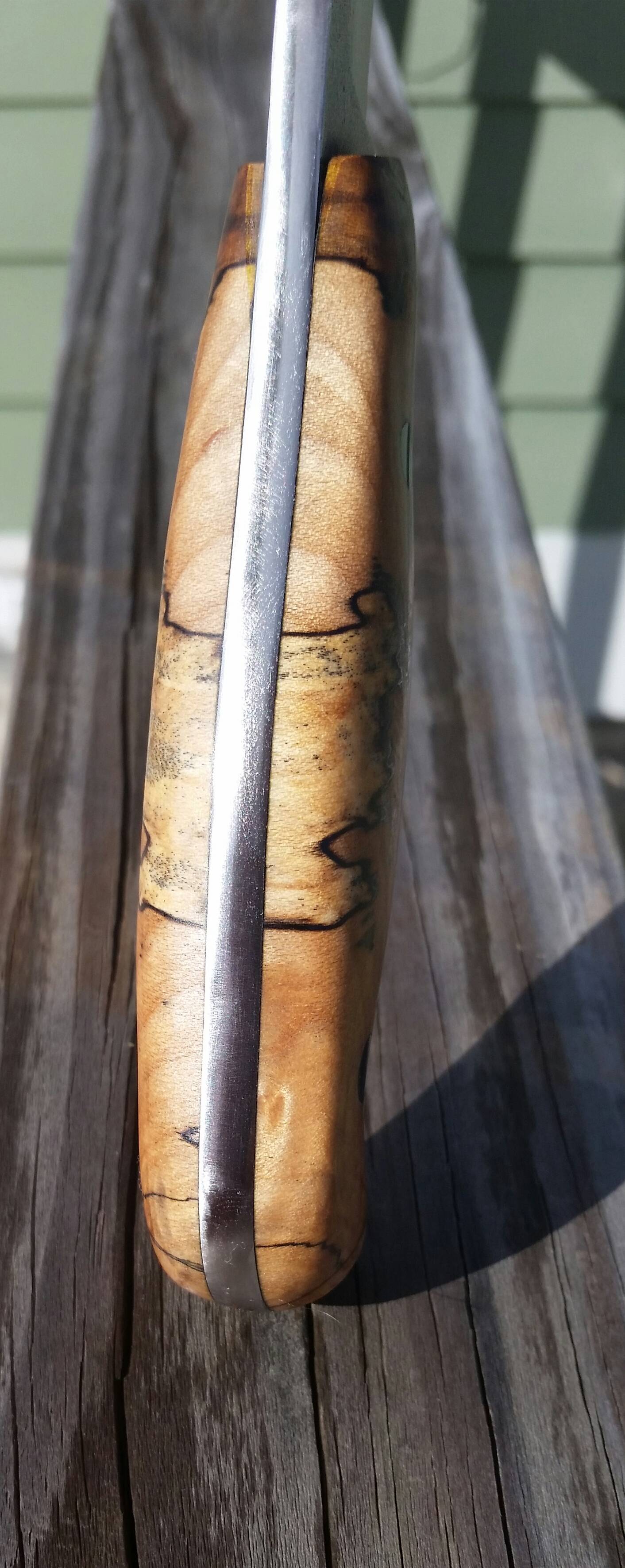

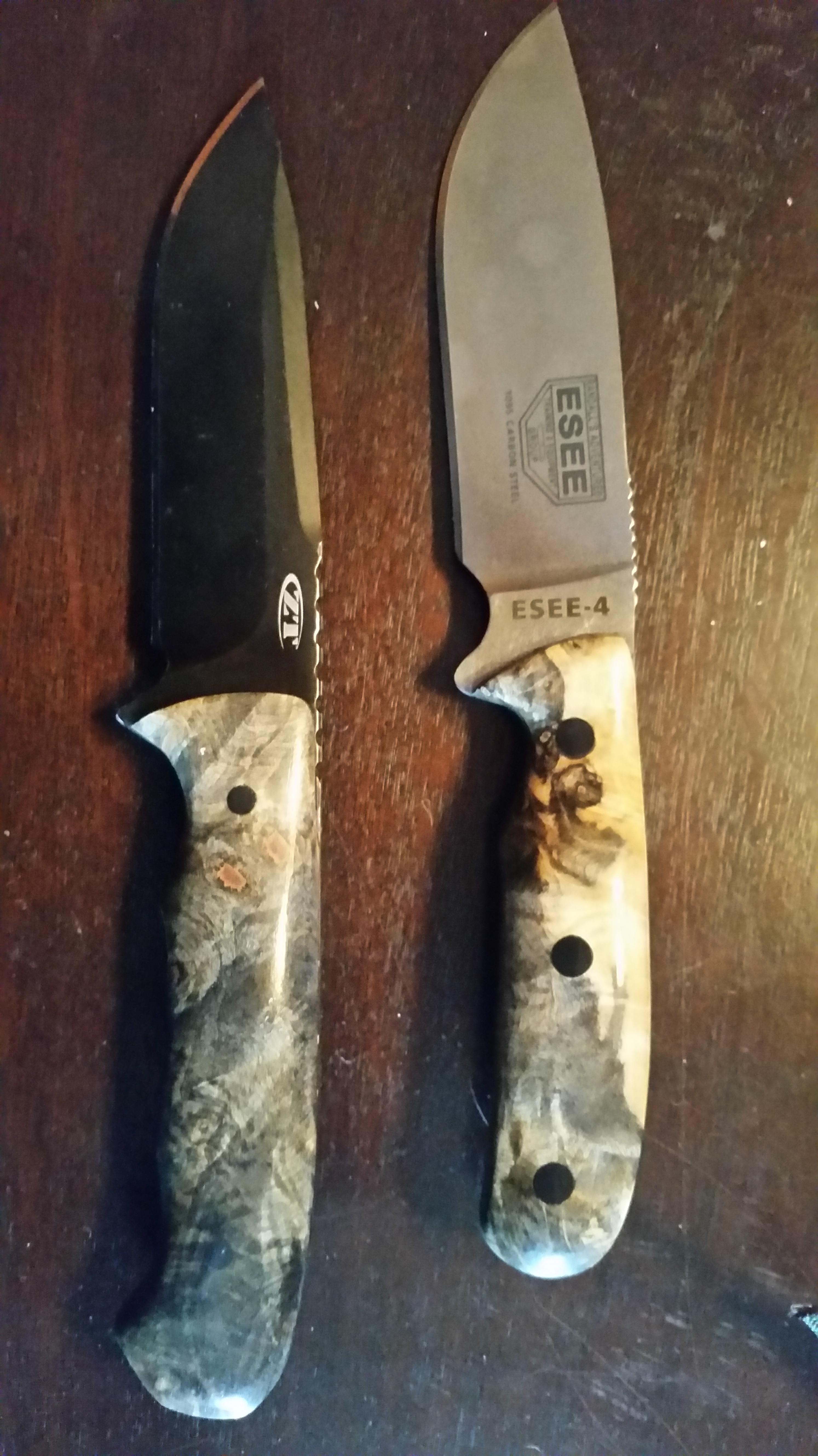

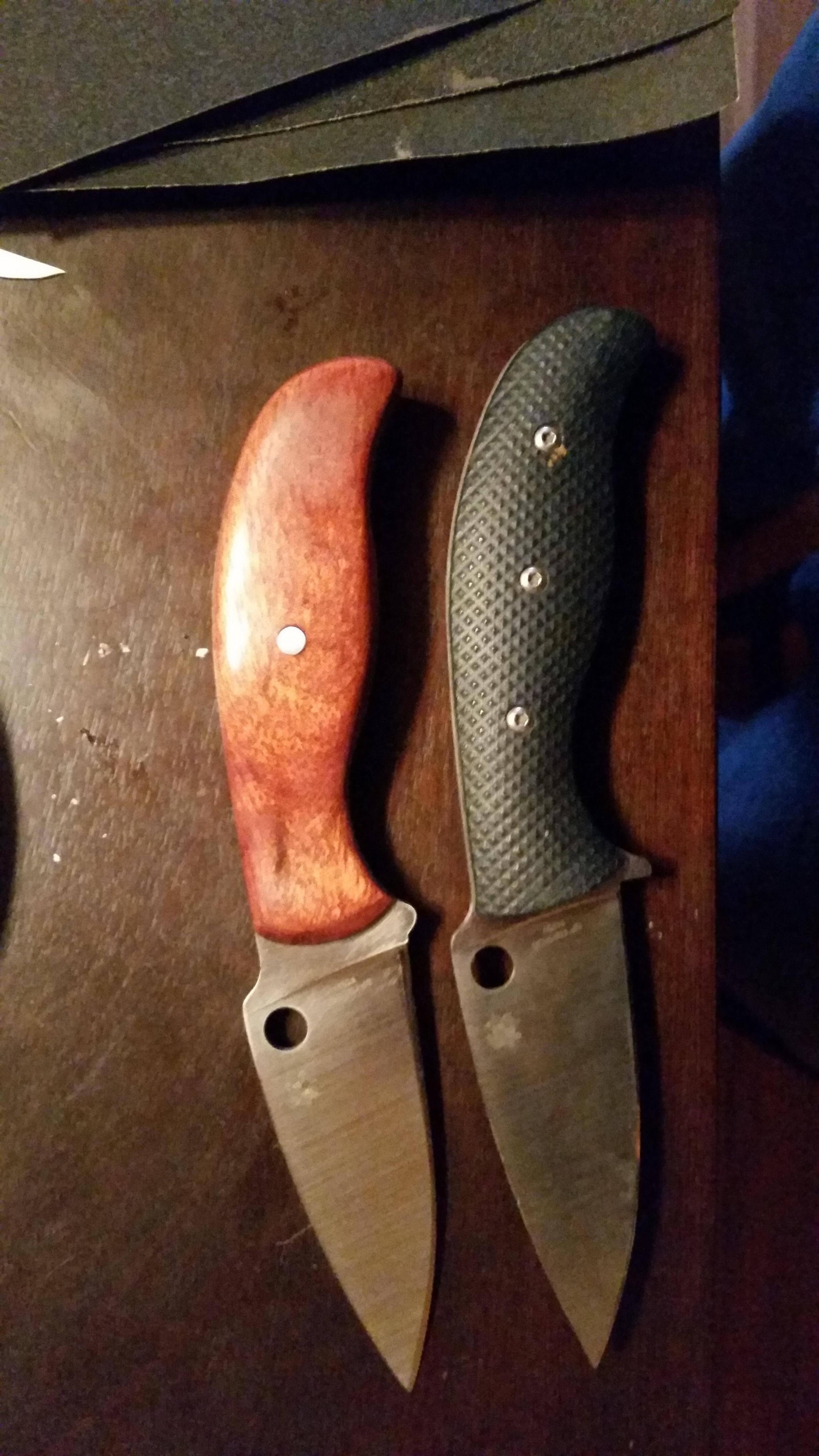

When you're done you should have something close to this. It wasn't hard and I'm definitely no craftsman or anything.
I'll post the pics of the MT when it's done.
Oh, and for you experienced guys, please take it easy on me
I went just a little too thin right at the front but it's still comfortable. I think it took me longer to write this up than to finish the knife after curing.
