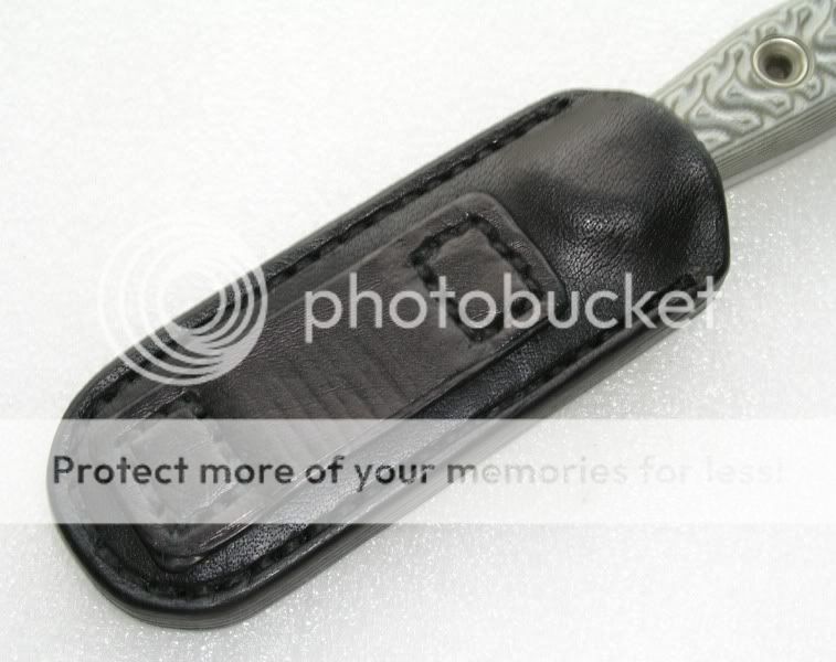

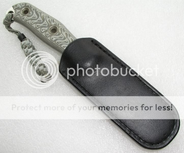

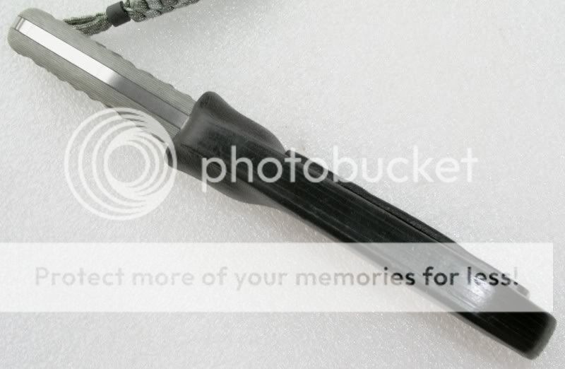

Anyway, I have received the leather hand tools I ordered from Tandy and I was desperate! Wanted to try out the tools! Finally I found a local store doing some leather work and repair. The owner sold me some scrap pieces- enough for making a couple of sheaths. So leather still a problem, but at least I could get started. :p
I have made a couple of leather sheaths in the past, but without the proper tools and I am very satisfied with the outcome of this one. At the same time, I have realize the value you get when you buy a leather sheath from the established makers at $40- 50. :thumbup: Lots of manual work that goes into one small sheath!
Here are some pictures:

Wow, that looks VERY professional!
Nice work.
Does it ride the way you want it to, it's definietly a high-ride...
Nice sheath! Thats way better then my first couple. Any chance we can also see the knife?
Heber
first sheath???? First time I tried to make a sheath, i nearly went suicidal!! Some of you guys are really talented! I don't know how you guys do it!
:thumbup::thumbup:
That's definitely a pro-level job. I really like the details - slight recess for the stitching and very clean lines on the sides where all of the layers come together. I have more than one commercial sheath that doesn't come together that well. If you did this well on try #1, I want to see some tooling on try #2.

Thank you all for your feedback!
To answer some of your questions/comments:
xaman- Yes, it’s a high-ride and just as I planned it.
leatherHog- my first sheath using real hand leather tools. But I have made a couple of sheaths in the past, using tools not specific for leather.
Heber- You can find the introduction of this family member at this thread: http://www.bladeforums.com/forums/showthread.php?t=531181
Gary007- Thank you! At least for me- using the right hand leather tools helped a lot!
Ham Solo-Thank you! I have not been able to find anyone selling small quantities of leather. So if I have to buy a whole cow worth of leather- I just might have to open up for business! ;)
Thank you IDAHOG!
Wow- thank you for your comments Tohatchi NM! We shall see what I can come up with on the 2nd sheath!
