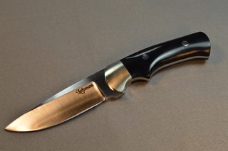

I use epoxy , auto safe belts and 50 tons press to make this and I would like to see someone to break this things .............I have around me tons of industrial grade micarta made with phenolic resin and I know that this micarta made by me is at least three times stronger ...............
It s not always about the money , sometimes is pleasure to make something alone :thumbup:
This is micarta I made from balistic kevlar woven fabrics . Epoxy resin is already applied .....only need to baking on 150 celsius for one hour . Was made directly on the knife blank / M35 HSS steel / , picture did not show how it s look in real ...........Too bad it s not yet completed. I need a few more layers to get the required thickness. Bad calculation :)
This is the tool / press for oven / I made for this project .........
Right from the oven...........
I agree with Natlek. Homemade micarta (TEXLAM © as I named it) is as strong as material is used for. I use 8 tons press and hard wear textiles and results are pretty good compared to real micarta. I am pretty sure You could not break it in hands. About sticky in use, it get sticky only when it get wet so I assume it is plus for this material. In sticky term I mean it does not slip in the hands. There is no residue on hands. I made lot of handles with TEXLAM and My customers are very satisfied...
