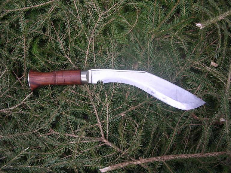

This time I used a 16.5 inch 23 ounce villager WWII by Murali and nothing else.

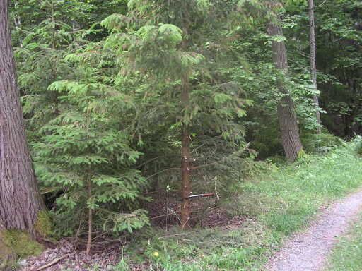

Some small spruce trees a bit too close to a small road are doomed to die!

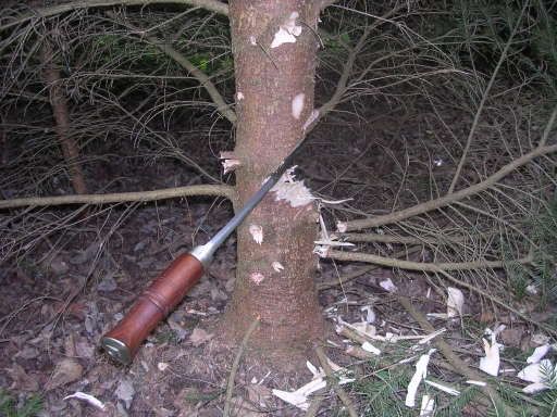

It was very easy to cut small 3 to 4 inch diameter spruce trees with the WWII.

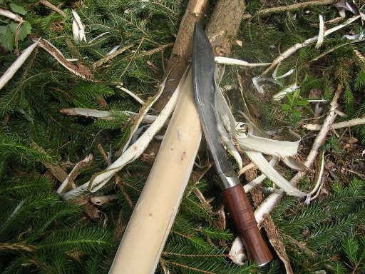

Bark stripping. I find the WWII much better than a small knife because it is very easy to switch from a peeling motion to a cutting motion when a knot is encountered. A small knife will get stuck on the knots but the khukuri just cuts them off.

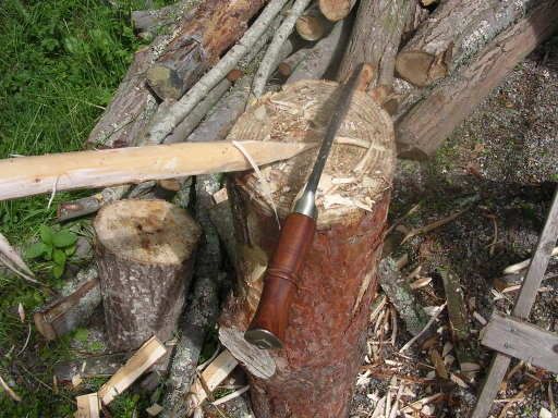

The pointed end is roughly shaped with several swift cutting motions. After this I use the recurve part of the khukuri and I try to make some finer adjustments to the tip.

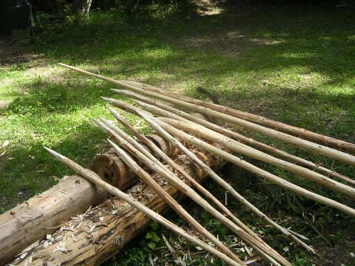

The poles are left to dry. They will be ready for use when the winter comes.
Conclusion: The WWII is a very effective tool for making pointed poles and it eliminates the need for several tools (saw, axe and knife).
