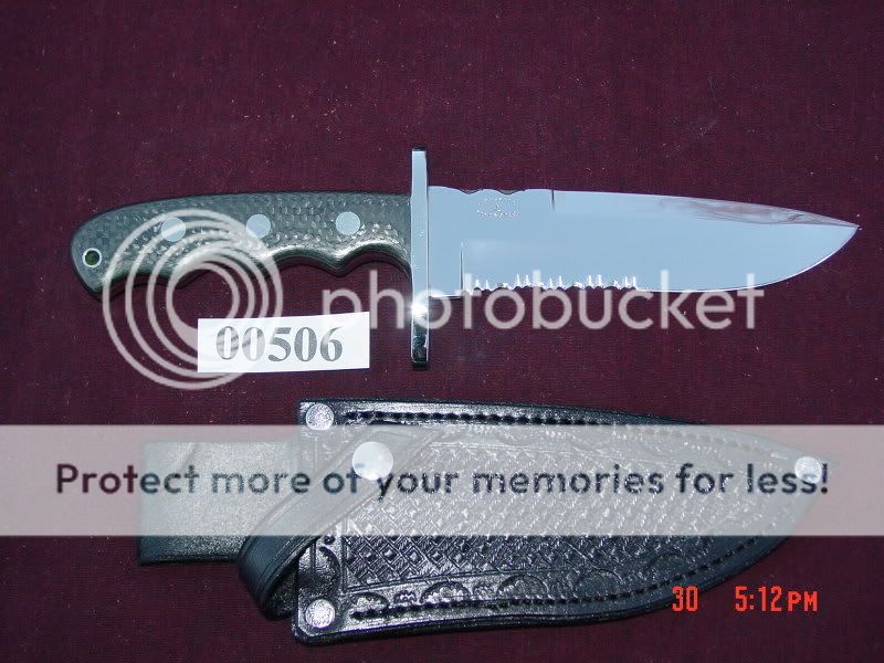

I use a foredom with 1/8" carbide rotary file to rough them in and then after knife is nearly done I use a 1/8" diamond to finish then triangle crock sticks for final sharpen. I have done a lot of them, but they don't seem to be very popular around here. Here is an example.
Jim
