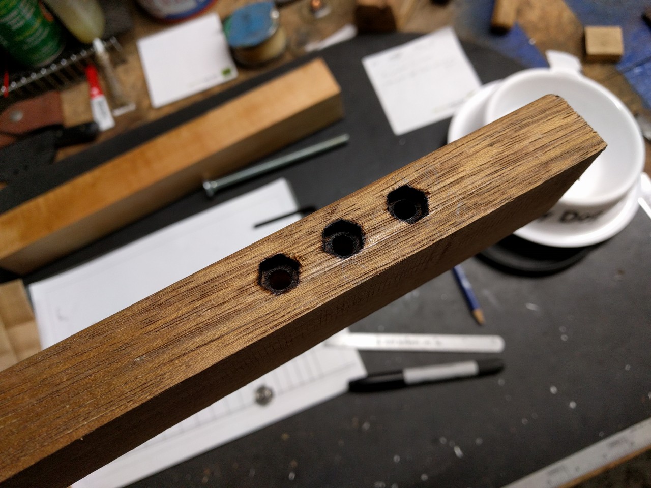

Hey folks, I got some new tools and want to try and make new handles for a BK9 and a Zombie Zomstro. I wanted to keep the same mounting method, but don't know how to make the nut holes, any special tool that does that?
Thanks, good read. No easy answer for all materials though, I need a test piece, I think I would try the drill one size smaller and file the sides. I have some small flat edge files, may take a while though. They seem to have success with the hot bolt in micarta, I would use an arbor press. Wood maybe another story.

Worked great in micarta. Not in G10.
I just used that technique this past week to inset some nuts into a piece of teak. It works FAST in teak, holy wow! All the natural oils flare up. :D

with wood scales, I countersink a hole same diameter as the flats then pull the nut into the handle while cranking down on the bolt - then I countersink the bolt head.
