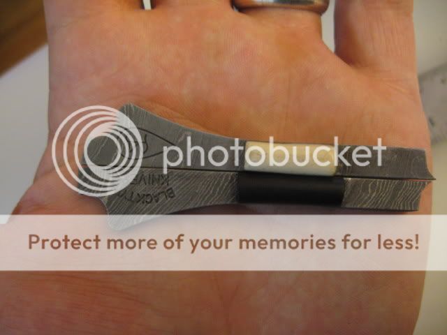

I daily carry a mammoth ivory "massage fingernail" that I made in because I have to keep my nails short. I hold it, so no need for extra oil. I occasionally carry other mammoth knives and treat them like any other handle. They go into whatever pocket they are in, with whatever else is in there- and surprise!!- none of them have ever split in half!! I've never even noticed any appreciable wear either. It's a knife, if the maker is reputable then so should the handle material be. I honestly don't get worrying about a knife, I buy mine to have and to cut, not to stay pristine. I say use away!!
I just took a picture of my mammoth slipjoints, the swayback has seen the most use, then Yukon jack, then the zebra and it's brother. I haven't used the dark handled one much so it really hasn't had much pocket time.
And this is the fingernail that is with me every day:
