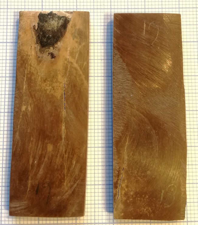

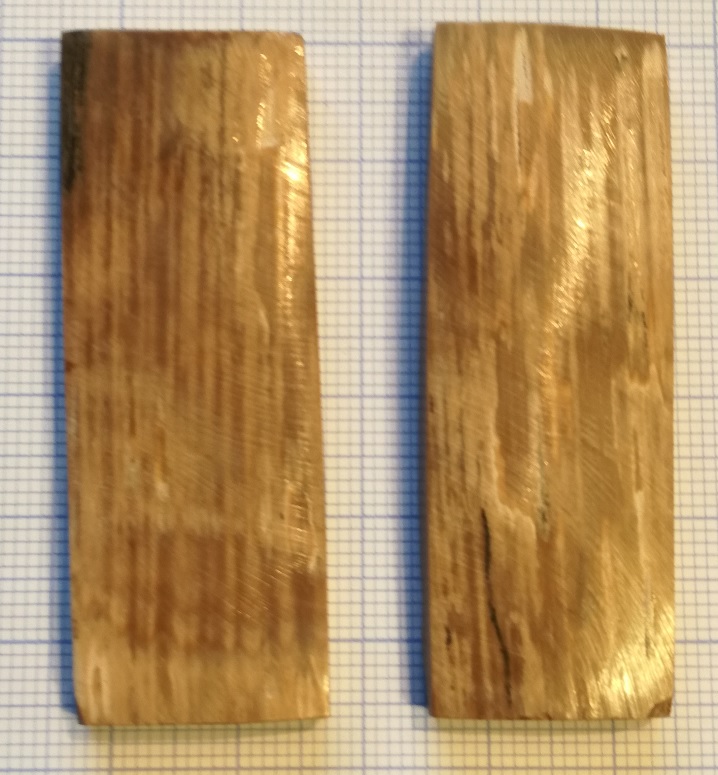

I want to work with mammoth ivory for the first time.
In the back there are some small cracks. Should I fill them with super glue of will the epoxy from epoxying to the liner do the same?
(I will use a thin G10 liner)
And the stripes on the surface, do they go all the way trough or will I lose them if I contour the handle?
The surface your referring to is called bark. It’s the outside of the tusk and yes it will go away if you grind it. If it was me I would fill the cracks. I’m not a huge fan of cyanoacrylate but I know it’s used a lot in paleontology. The big thing I don’t like about it is that it can get everywhere and if it cures to fast it can leave a weird white haze on the surface. It is good for filling real fine cracks as it wicks into every little crany. It’s not the greatest gap filler though. If thoes where mine I might try the cyanoacrylate and let dry. Then use a real thin epoxy (I use clear coat by systems 3) to fill them the rest of the way. I have had luck with using a fine tipped air gun to blast the epoxy deeper. It’s a trick I use to fix cracked rifle stocks. Never used it on cracked ivory but I don’t see why it wouldn’t work.
But take all this with a grain of salt as I have not worked with ivory all that much. And the stuff I have worked with was not cracked at all like that. But like I said if it was mine I would do it like I said above.
Is that both sides of the ivory you're showing - front and back? If so, you have inner ivory without the "bark" that's on the outside. I like soaking mammoth ivory in thin CA so it will soak into the tiny cracks you might not even see. That large crack it won't fill that. I would use a tad of sanding dust to make a paste with a very thin epoxy and fill that. I have seen folks use a black epoxy to fill large cracks to provide a nice contrast. Not my favorite.
Since that is inner ivory most likely you'll have a nice smooth look once it's sanded and polished to a high luster. This is mammoth ivory - you'll never know for sure what you'll have until it's fully finished, but it will look GREAT!
When you're sanding be sure to keep it cool, use SHARP belts and only grind lightly, then cool. Don't allow it to feel "hot" to the touch.

They are one set of scales, the top pic is the back, the botom is the front.
