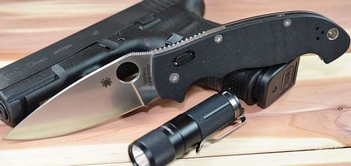

This is a saber grind. It can be just flat V shape or hollow ground like the one in picture. Its radiused inwards. Someone can just call it sabre grind and omit the hollow part cuz they don't care.

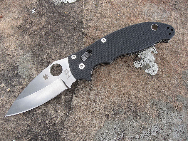

This is full flat ground blade. The blade is ground from the spine down like kitchen knife.
Oh and when it says hollow grind it already implies a saber grind. I don't think I've seen anything that's ffg and hollow
A hollow grind does not imply a saber grind. The way I've always interpreted a saber grind is a grind that is flat ground to the edge but starts roughly halfway up the height of the blade. A full flat starts from the spine and terminates at the edge. A hollow grind can vary in grind height. The diameter of the grinding wheel can be a factor in this. There are high hollows that run nearly from spine to edge and there are short hollows like that of the original Manix 2s
