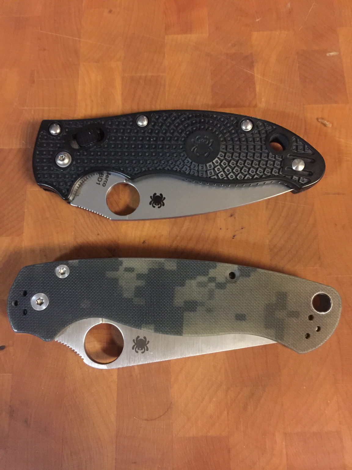

Highly disappointed with the deployment of blade on my Manix 2 LW. I'm able to thumb flick it out without use of wrist but it's nowhere near how the PM2 deploys or even my original Manix. And using the ball bearing lock to flick the blade back in is impossible. Does anyone else have this issue? Or is this just how the lightweight model is?
The ball bearing lock models are stiff at first but will eventually break in to becoming easily opened and closed. The nature of the lock makes it to where a constant pressure will be on the tang from the pretty strong spring, so it will never be as effortless as a different locking system like the compression lock.
Zinn,I'm having the same problems,Ieven leave the blade partially open at nite.She is nowhere as smooth as the axis lock on my Griptilian:confused:
I can open both my light weights by pulling back on the lock and using a very light wrist flick. I can close either by holding the knife upright, pulling back on the lock and letting gravity swing the blade closed. The blades on neither LW swing as freely as my Manix 2 G10 but they're still very easy to deploy.
Yours should free up with use. You can try loosening the pivot screw a tiny bit but I wouldn't go too far.
There are a couple ways to lighten up the spring pushing the bearing; remove it cut a little section and put it back but later on you may have to take it out and stretch it because it will be compress to the point it's too light. Or like garddogg 56 suggest leave it open midway to compress it for a couple days.
The washers also need to be broken in, do not adjust the pivot too lightly, if should be slightly stiff but smooth and it will even itself out with use; you will know when it's properly broken in when the blade drops with a light shake but not swing freely. Once that's achieved, take out the pivot screw, put some blue locktite on it (very little will do) and tighten to the smoothness you like and you will be a happy owner

I've adjusted the pivot and the action is much better now, although it's not as smooth as my G10 Manix.

I owned a BD1 LW for about 3 years before I sold it to a buddy of mine a couple months ago. Before I sold that one, I picked up a S110v LW. The BD1 was stiff and disappointing at first, feeling no where near as smooth as an Axis Lock as I was hoping (perhaps wrongly). Eventually, it improved slightly and I got over it, just accepted it...grew to really appreciate the blade for other reasons, as it's really awesome all-around. Obviously, that experience didn't stop me from buying the S110v variety. Same story with it's action, maybe slightly better.
So, my buddy and I went to the SFO and handled a G10 for the first time about a month ago. It was [B]***miles*** [/B]better than either of my LWs. Scott, the rep there, said the LWs tend to be stiffer than the standard models. My buddy and I both hand our LWs with us and Scott was pretty surprised by exactly how stiff they were. After a bit of tuning (pivot adjustment and lube) he managed to improve the action a bit, but nothing like the G10 model. This past Thursday we went back and handled a brand new display model blurple G10 Manix...same deal, way better than the LWs.
So, long story short, I just chalk it up as a possible characteristic of the LWs. Some might be good/nice. Some people's tolerance makes it a non-issue. Even with its 'kinda crappy' action, my S110v is a phenomenal blade. I'd recommend it readily to anyone looking for an extremely capable, lightweight, modern folder. :thumbup: :thumbup:
