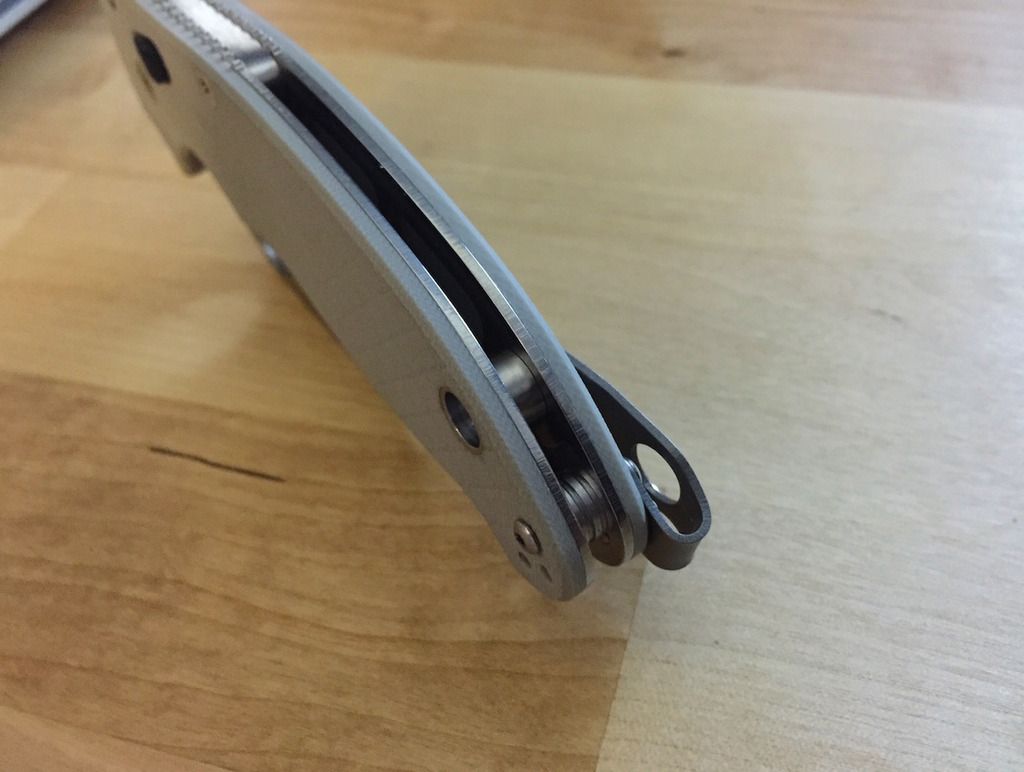

Just got a Manix 2 while on vacation in the Arizona White Mountains. I really like the knife overall. My one criticism is on the number of assembly screws. I'd prefer that it had one more screw and standoff (or standoff equivalent) further down the handle near the lanyard tube - above or below. The design is relying on the pressed lanyard tube to hold the lower portion of the knife together. Assembly and disassembly will loosen the lanyard tube and therefore the scales and liners near the bottom. I guess screw or not, I'm not a fan of Spyderco's pressed lanyard tubes, but one more screw would have been nice.

Really. The flared lanyard hole in general (IMHO) is not a quality design and not what you'd expect from a company like Spyderco. The knife should be built so that disassembly and assembly is without trauma. Typically, a shouldered lanyard hole standoff is sandwiched between liners and slabs with an appropriate number of screws to hold them together. Or, no lanyard tube at all, just a finished hole. To substitute the lanyard tube for an adequate number of screws and standoffs is not what you want. Of course these are going to loosen up. Same thing on the Para 2. At least the lower screw is closer to the bottom. I want a knife I know can be taken apart if I choose to, regardless of the warranty!

One can further strengthen the rear end of the Manix, or eliminate the lanyard hole altogether (as Sketchen and I did) by simply obtaining one extra long pocket clip screw that threads all the way through to the other side.
I didn't care for the appearance of the bare threads being exposed, so I spent 59 cents at the local hardware store for a teensy black hard rubber grommet that the long screw threads through.....the tail end of this Manix is SOLID, perhaps even more so than with a lanyard tube/flared ends, and super EZ to service the knife, now. Eventually I'll cut a little piece of brass or stainless steel tubing the replace the grommet, just haven't gotten around to it, yet.

Nicely done. I saw one execution where someone put a Chicago screw through the existing lanyard tube. The flaring was eliminated as well.
Nicely done, Razzle. I like the grommet idea. I did something similar with a steel standoff:
The standoff works great. I'm assuming you used a threaded standoff? Did you drill out the threads on one of the clip holes on each side?

Possible, but that's Eric's design. In my experience with the Manix 2 and Military, the tube is structural, and serves it purpose well. I found out by removing my Military's tube completely and realized it added a lot of rigidity. I put it back in and all is good. No rattling, no loss of strength, and it is a lighter solution. I get rid of all laynard tubes when possible. It seems US tubes are structural, and Taichung's are not. Not saying that is a guarantee, but from memory and my knives it holds true.

Yes, it's a threaded standoff. You'll just need a couple of longer screws, which thread through the liners and into the standoff. No drilling or tapping needed.

@razzle what are the specs on the screws you used?
The screws are 2-56, threaded length is .4".
The gap is about .55" but you can get away with a bit thicker if you're using a compressible rubber washer.
Replace a pocket clip screw with the longer one. Pinching the liners and scales tightly together, screw it in all the way through the opposite liner. You don't need to drill out the clip holes and use a threaded standoff, though that will certainly work as well.

Bro! (Long pause) Dude! (Longer pause) That's absolutely awesome. I hate to steal an idea. I'm going to have to do it to mine.
