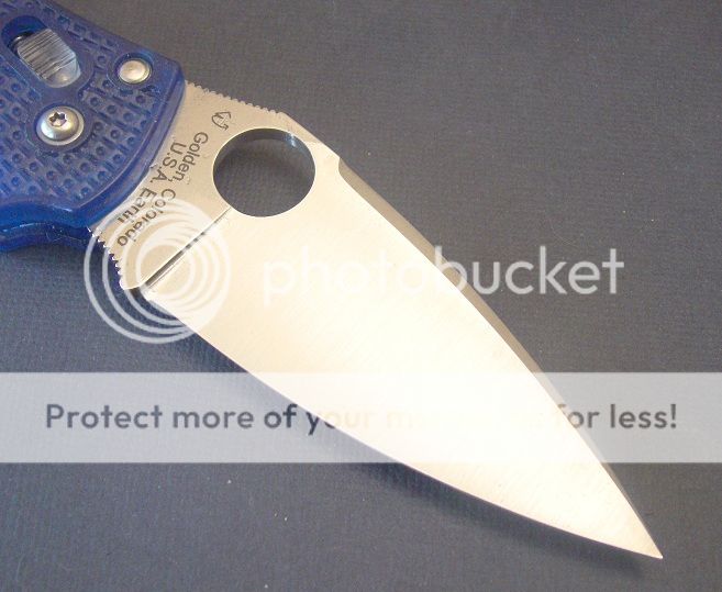

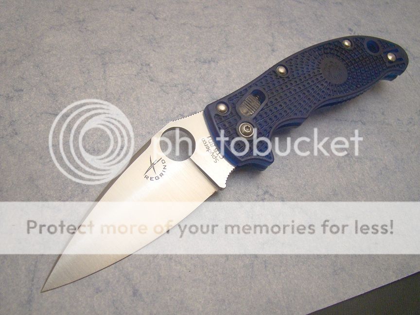

Guess who's loving regrinding?!?:D Really like how this one came out - I think I'll be getting one for my own pocket in the not too distant future!
Before:
After:

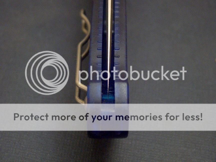

Added the swedge and took the edge down to 0.25mm behind the secondary bevel. Final finish was done on a 600 compound ceramic grit belt (lovely things)
Opposite side
Tip
Thanks for looking
Gazza
Now it's a super slicer. Judging by the photo it's looks to be in the 0.005-0.010 behind the edge range. Nice work!
Haha - forgot to add that detail :) Measures 0.25mm behind the secondary bevel which is pretty much 0.010 - Good eye!
That tells me I need new belts haha. Compare your beautiful satin finish to mine lol... mine is 0.007 at 8dps or so
Yours looks good too. Fresh belts definitely make a difference for a consistent scratch pattern. A cork or scotch bright belt will help tie things in as well, but I've only made about a Dozen blades to date so I'm new.
