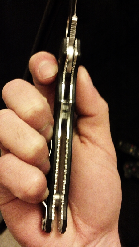

Had her for a week now & all I can say is this is one hell of a knife! That being said, unlocking the knife one handed was quite a pain.... So each night before bed I opened the knife just enough to fully compress the the spring, that and opening & closing while watching TV has made one handed unlocking a breeze! Just wanted to pass this on to others that felt one handed operation to difficult.

I have a Manix 2, it broke in enough after a couple days for me to close it one handed. You're still going to have to pull on both sides of the cage to unlock it though. What I do is put my pinky, middle, and ring finger under the pocket clip a little bit to give me grip, and then I pull back with my thumb and pointer finger. I can't get enough grip without putting my fingers under the clip. I can easily pull the cage back if I put my fingers over both handles, but then you run the risk of the blade swinging into your fingers. What I also find myself doing is gripping over the handles and letting the blade fall straight down, and then I close it the rest of the way with my thumb.
Pulled out the spring on mine and compressed it in a vise overnight. That helped a lot. Still didn't like the stiffness, so I changed out the spring. Tension is similar to an Axis now.

UPDATE:
Installed a Silicone Nitride ball, tapered and polished the tip of the spring perch on the polymer cage, and used three light compression springs wound together as one, to replace the heavy stock spring. The Manix is now quite flippable without touching the lock and the release studs can be activated with either the index finger or thumb. It still has a bias toward closure, a nice feature to demonstrate to the gendarmes, if needed.

Personally I wouldn't play with lighter springs, because that force holding the ball in place is what keeps the knife locked. Less force equals greater chance of accidentally closing.
