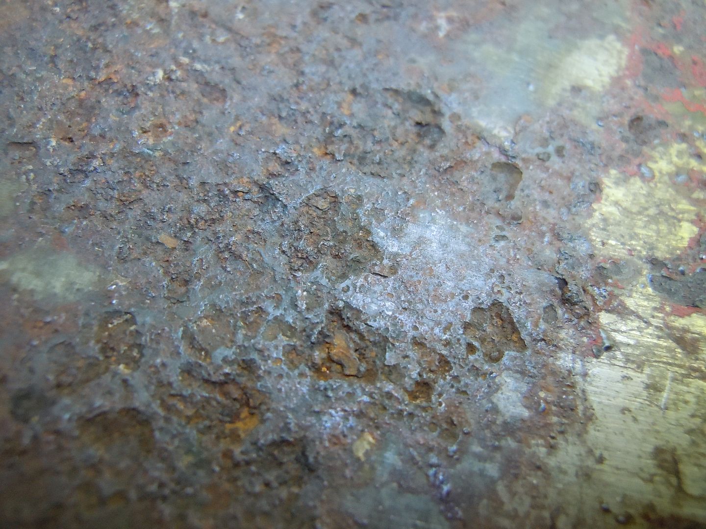

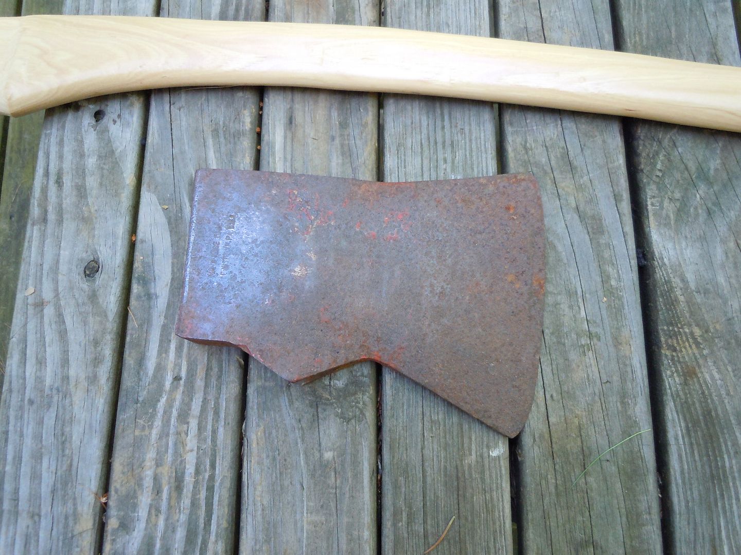

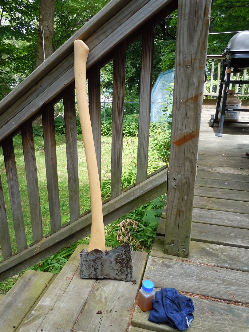

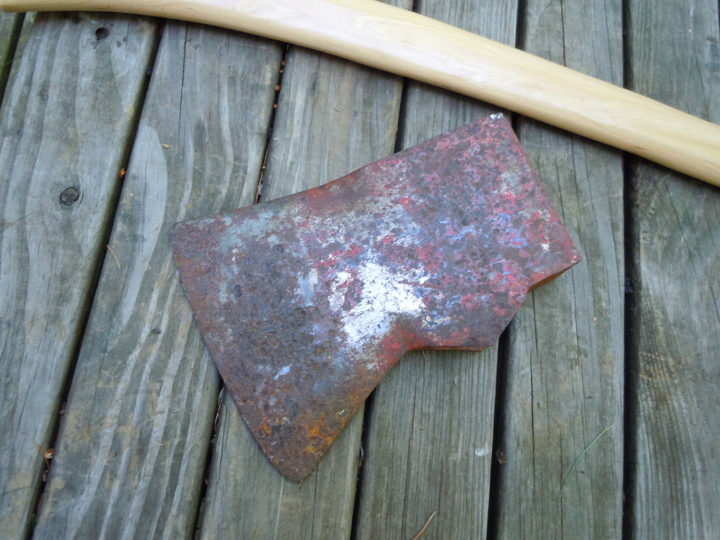

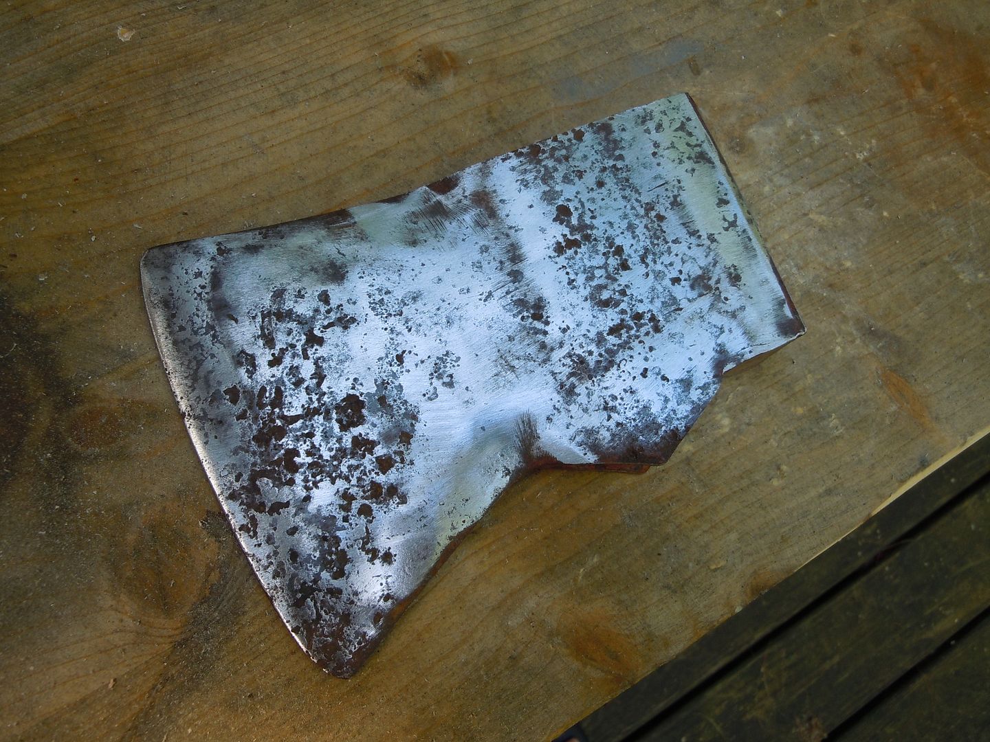

The head was rough. Some of the pitting is just too deep to actually sand it down to remove it. So I got off the surface rust for the most part, and decided to leave it at that. Handle is a 32".
After sanding

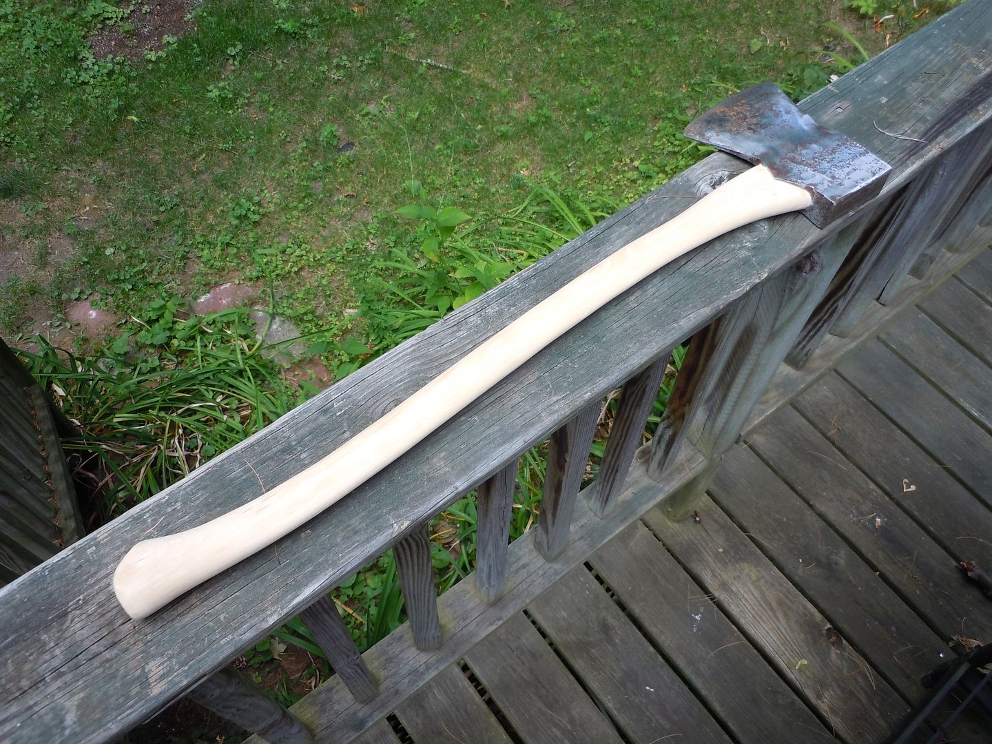

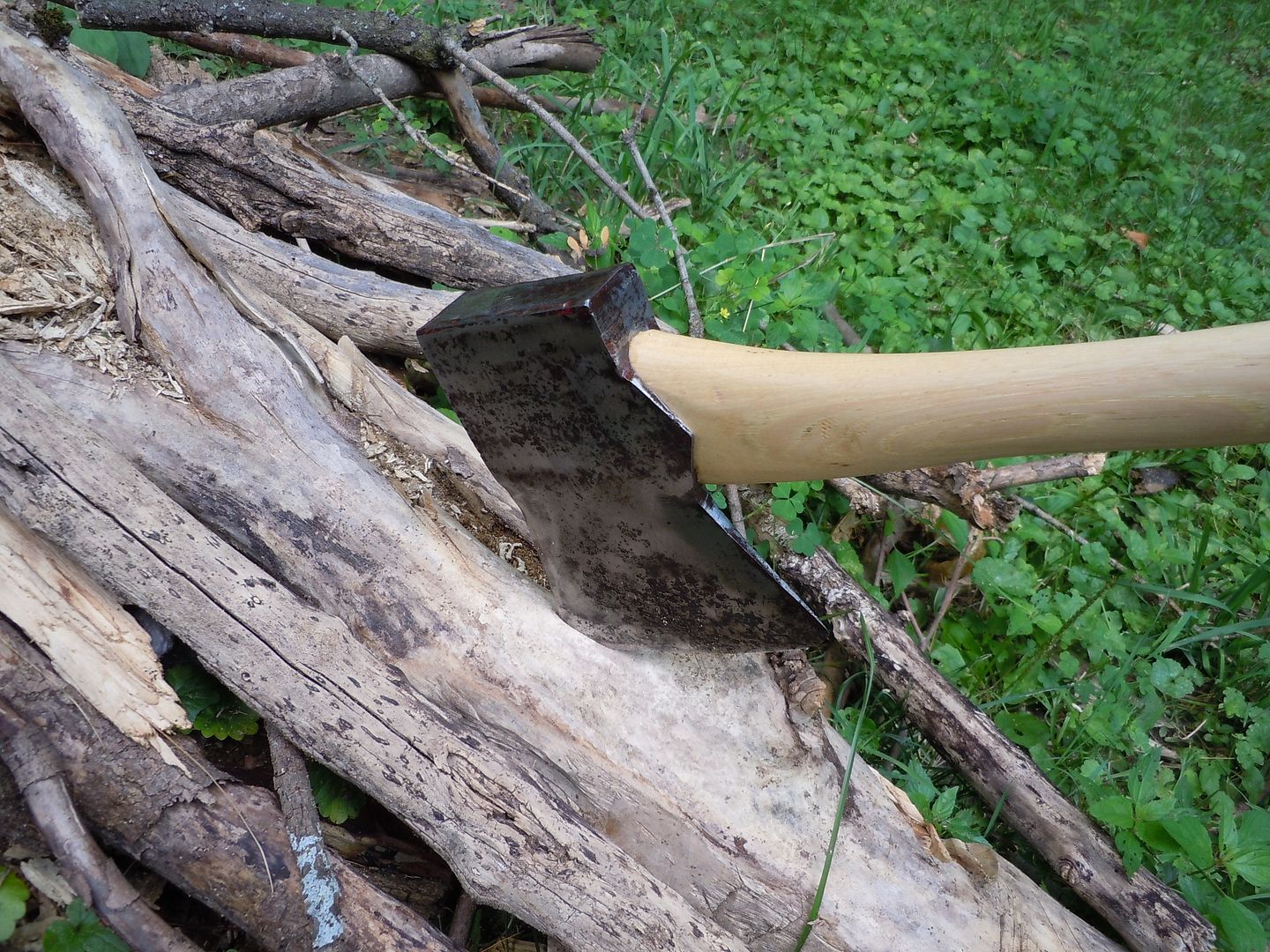

I got the head to pop on 1/2 the way with ease. I thought I had removed enough on the sides to take the lugs. Got down to the point of no return, and she seemed to stop. Had to really spend some time driving it the rest of the way. I will say one thing, this head will never slide...ever.

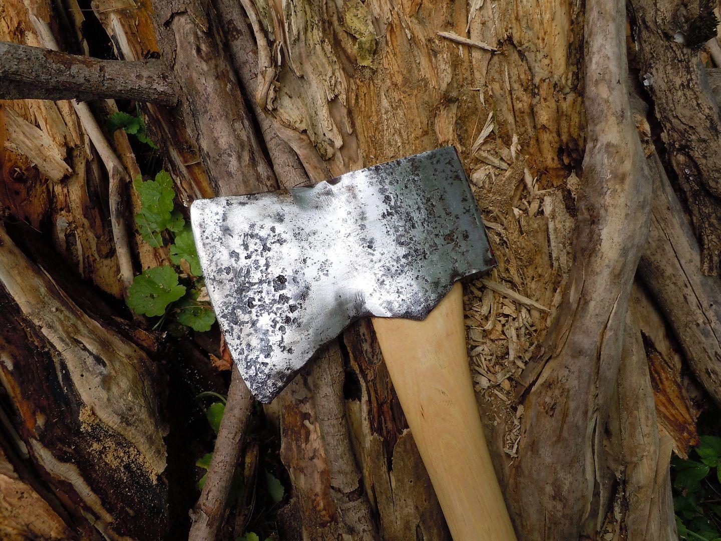

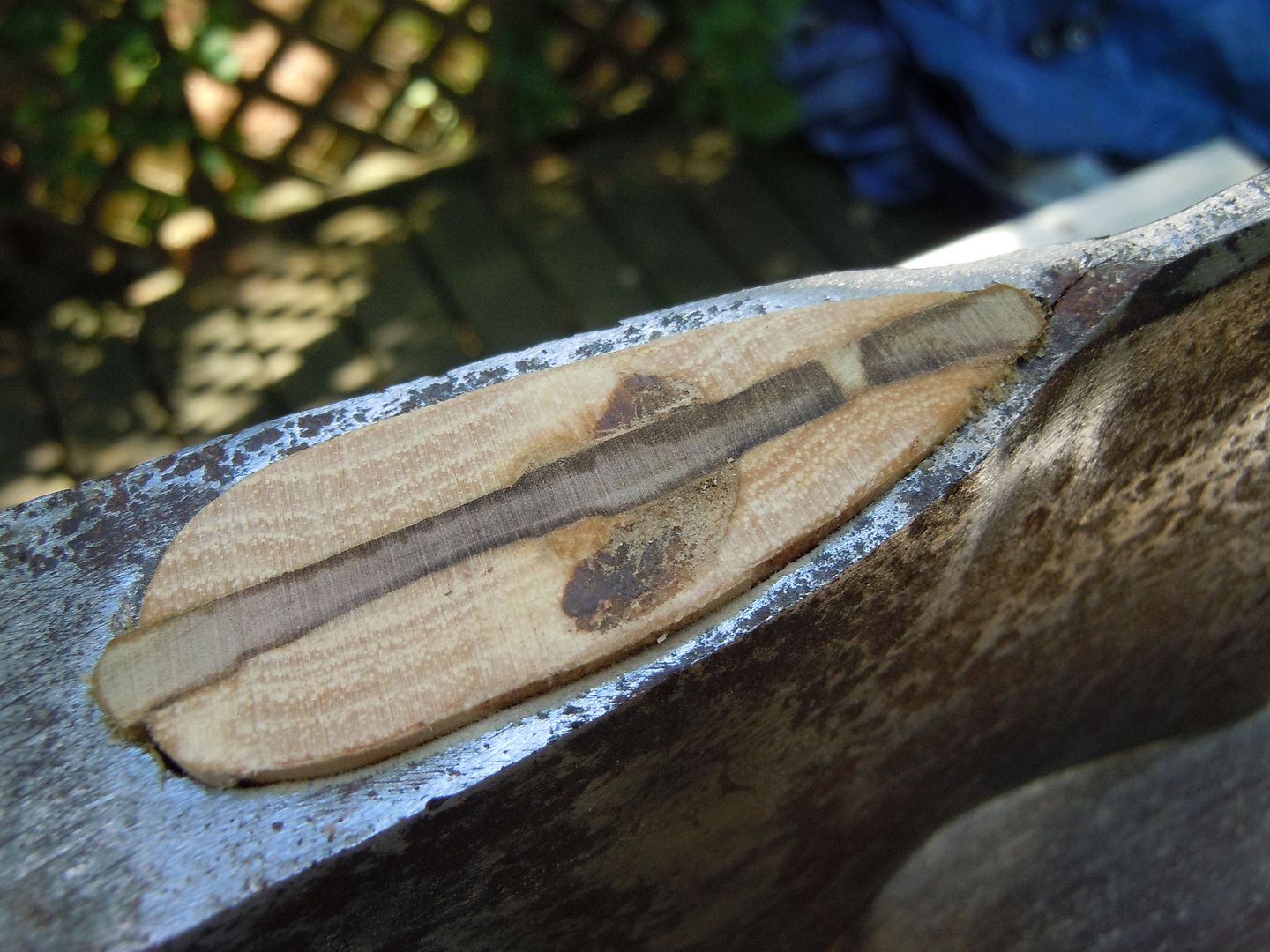

Wedge went in real tight! Also took some time to get to settle.

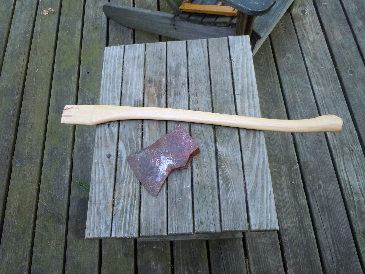

Going through the grits on the handle. Handle came with damn hard varnish on it.
Finished sanding

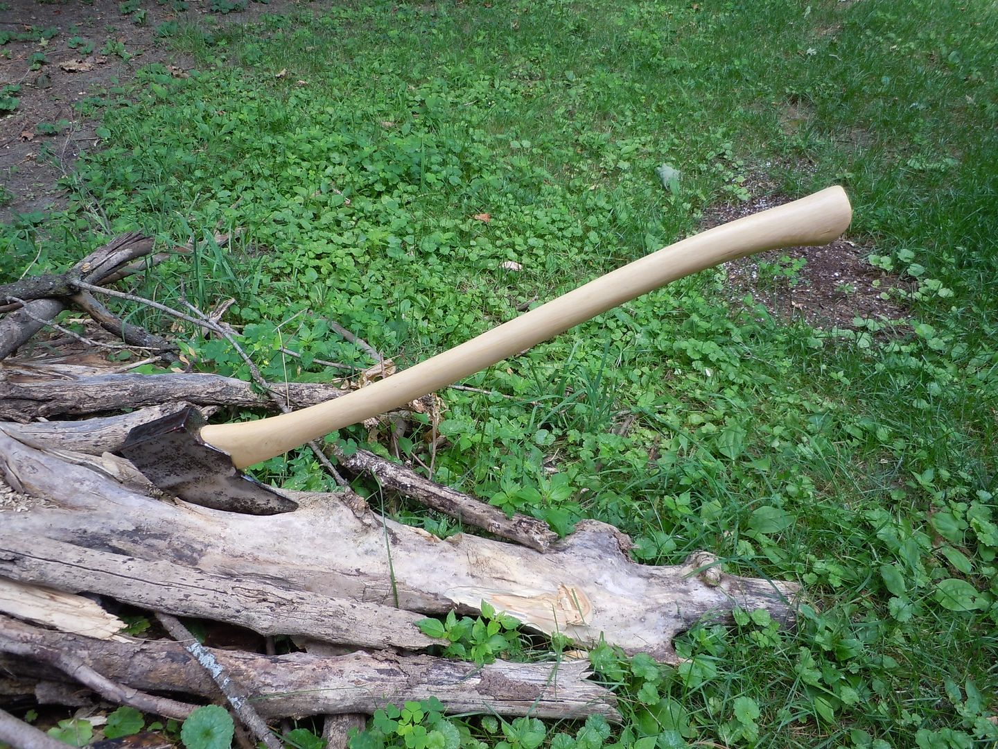

Time for porn pics and oil
Time to dry
After sanding
Finished sanding
