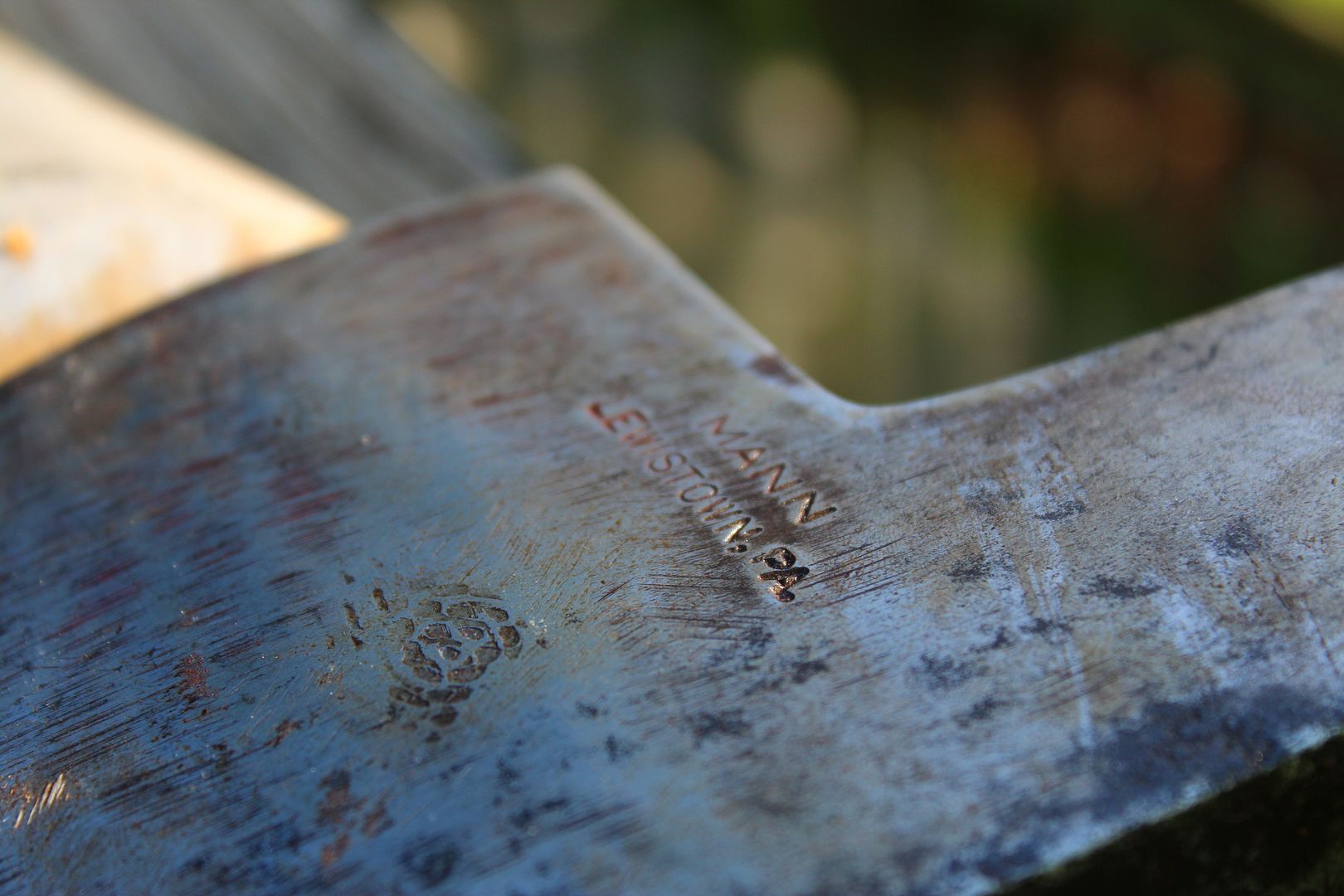

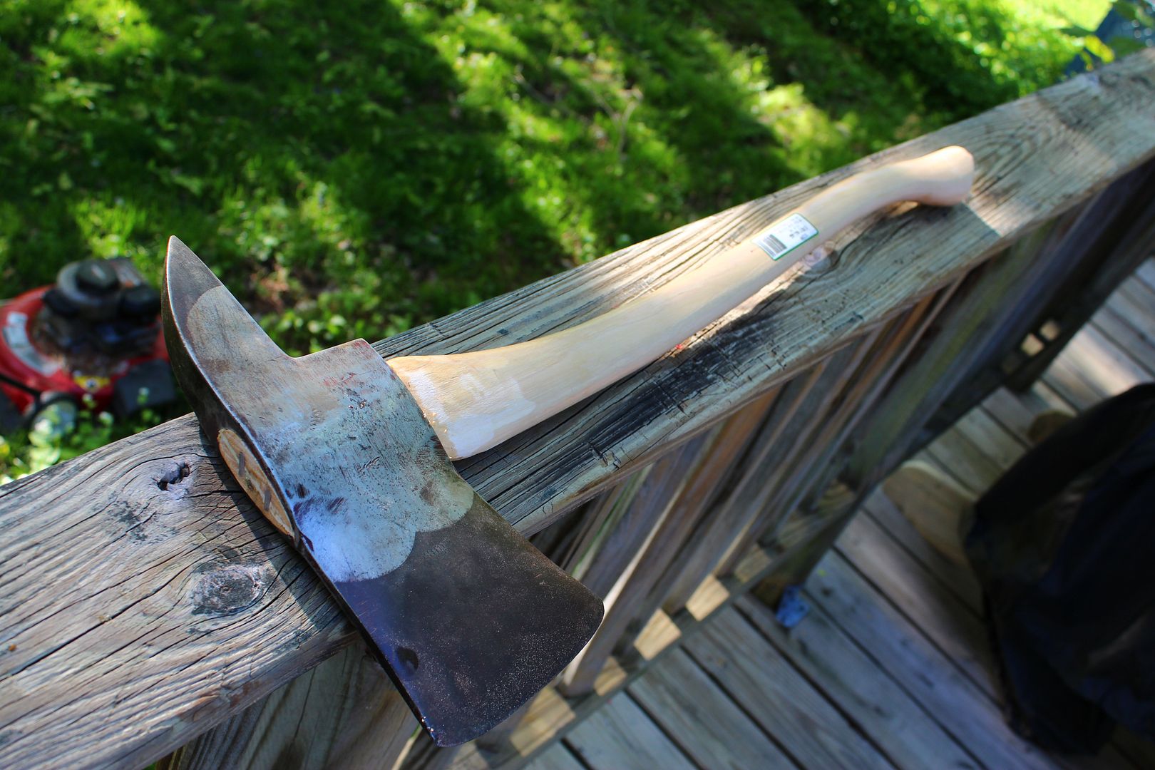

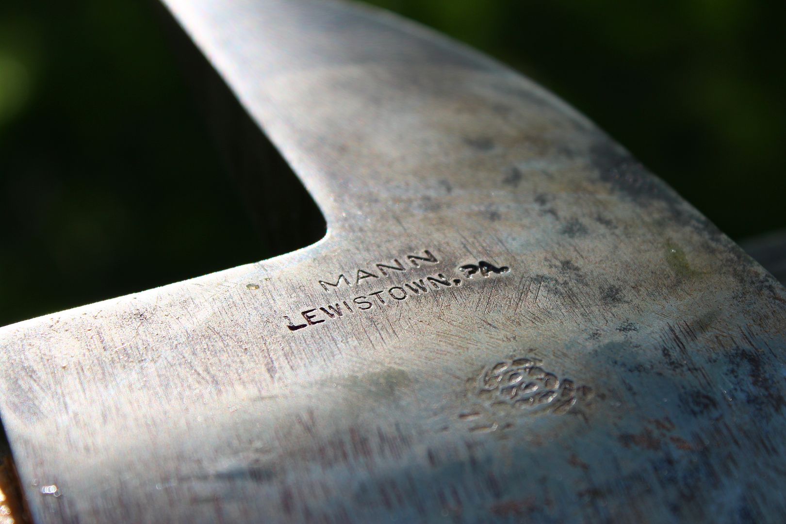

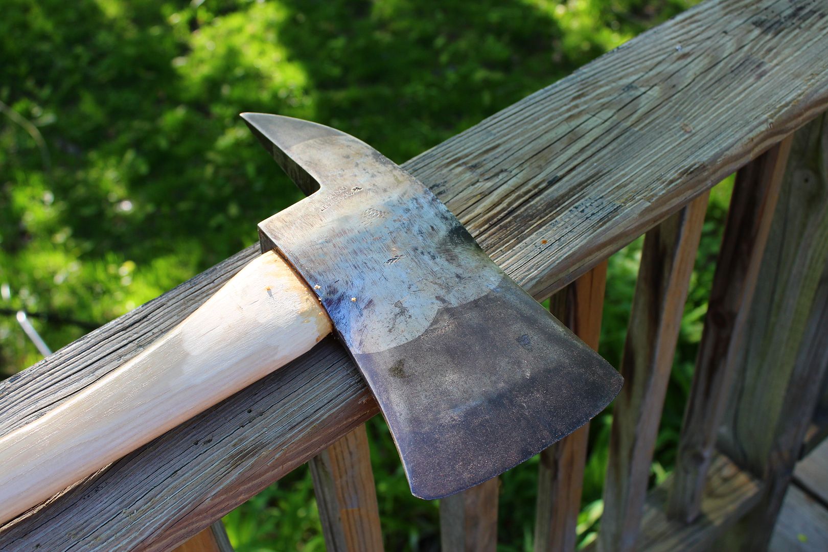

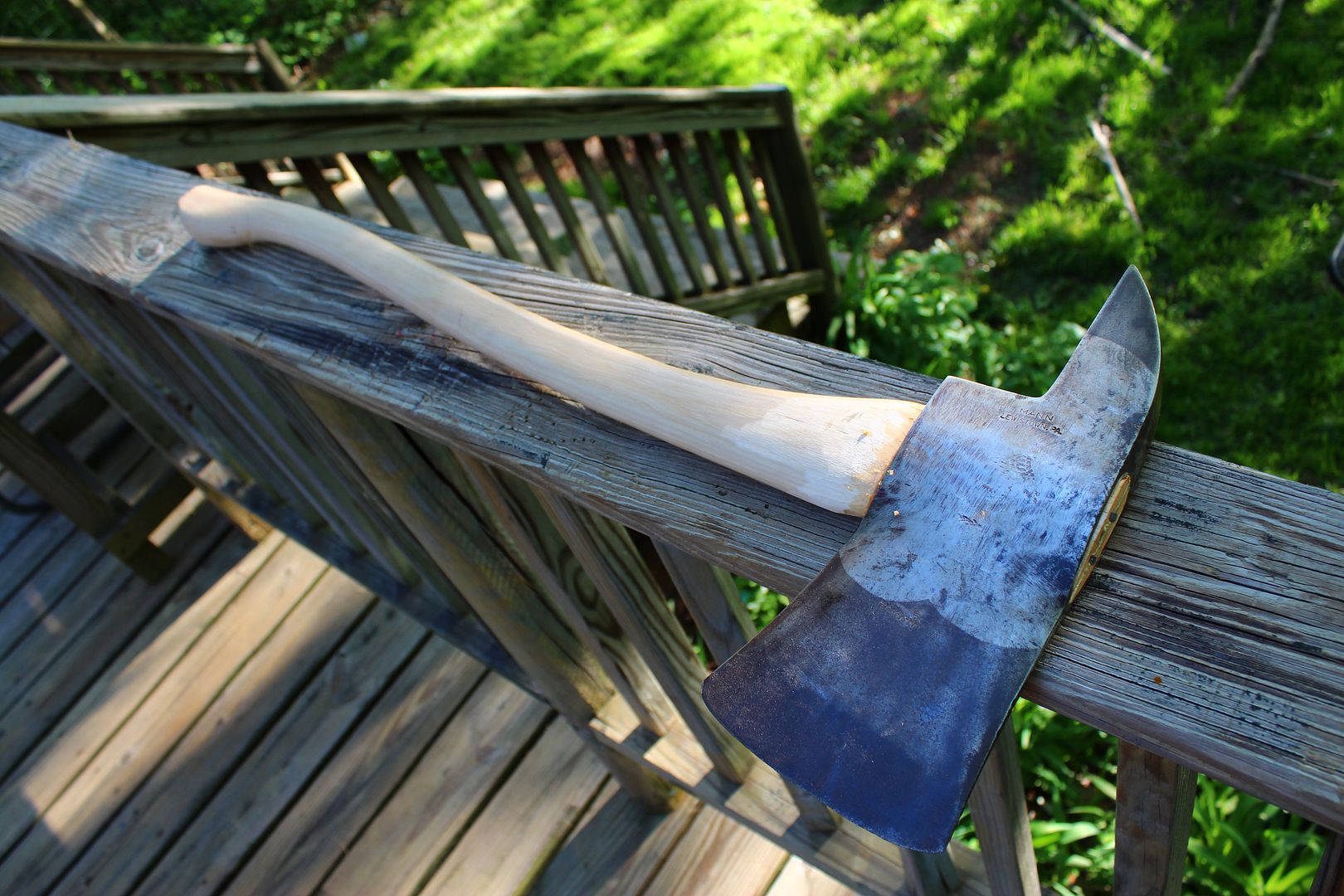

This is I think a 6lbs head, I never weighed it. It is the neighbors, he found it in his garage. I had an extra handle.
Ideally I think a 36" handle would have been better, but all I had was a 32". He just wanted a handle on it, so he could display it up.

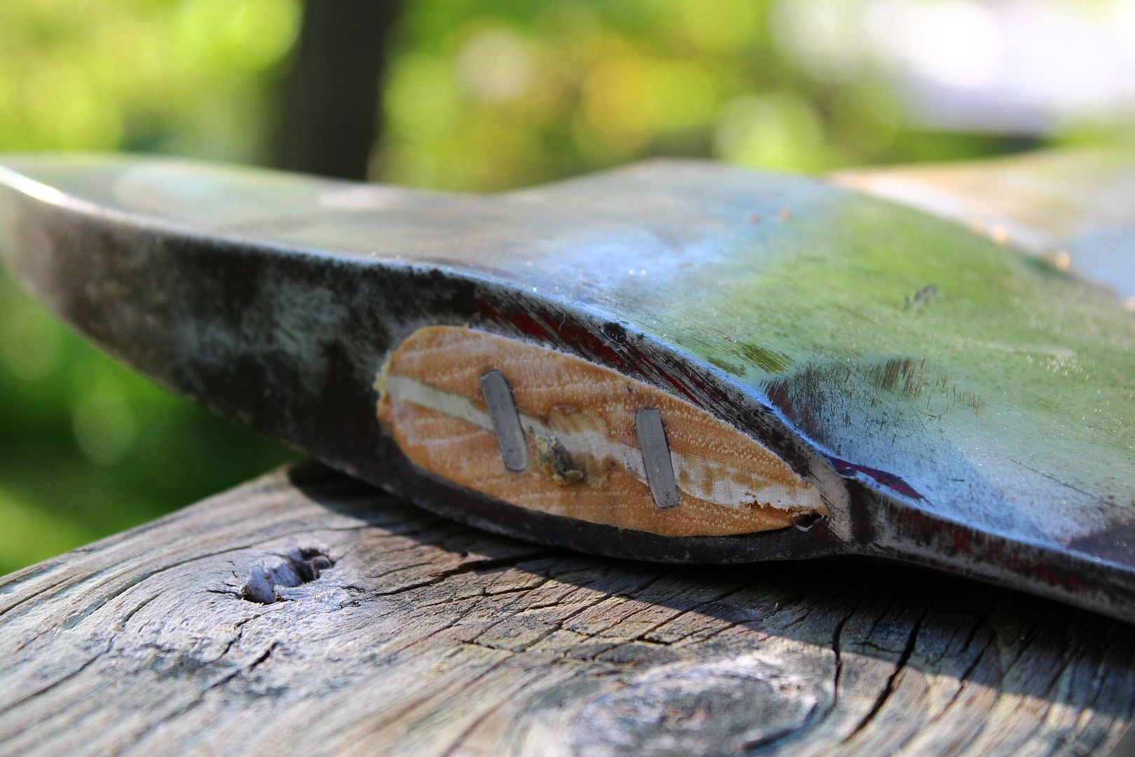

I just shaped the neck and drove the wedge home. He will finish off the handle himself.
Wedge went in super tight, and compressed. I figured this time I would drop in two metal cross wedges. The eye on this axe was odd shaped. Should never come out now.
