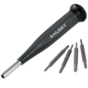

You don't need anything fancy, I have a Husky 8 in 1 torx screwdriver set, has all the bits in the handle, and has from t4 through t15. It's like 7 bucks at the hardware store.
Most every guy I know has a set or two of torx drivers. I find them to be extremely common. But if you don't have a set, you can find a mini-set (T4-T10 will cover 99% of knives out there) at Home Depot or Lowe's for less than $20.

I don't know where I got the tool, but I know it was cheap and it's super handy. It has 4 double sided bits (that's 8 sizes total), and the handle stores the 3 you aren't using. Looks like this:
