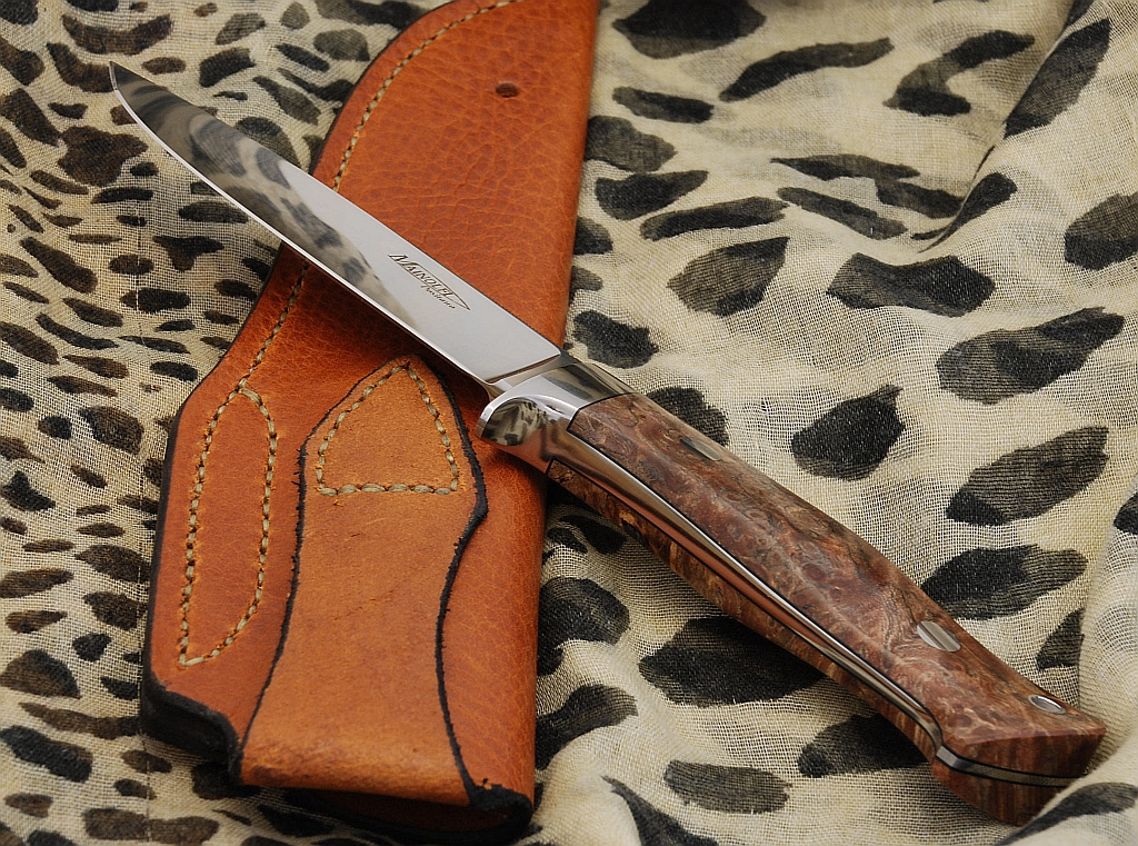

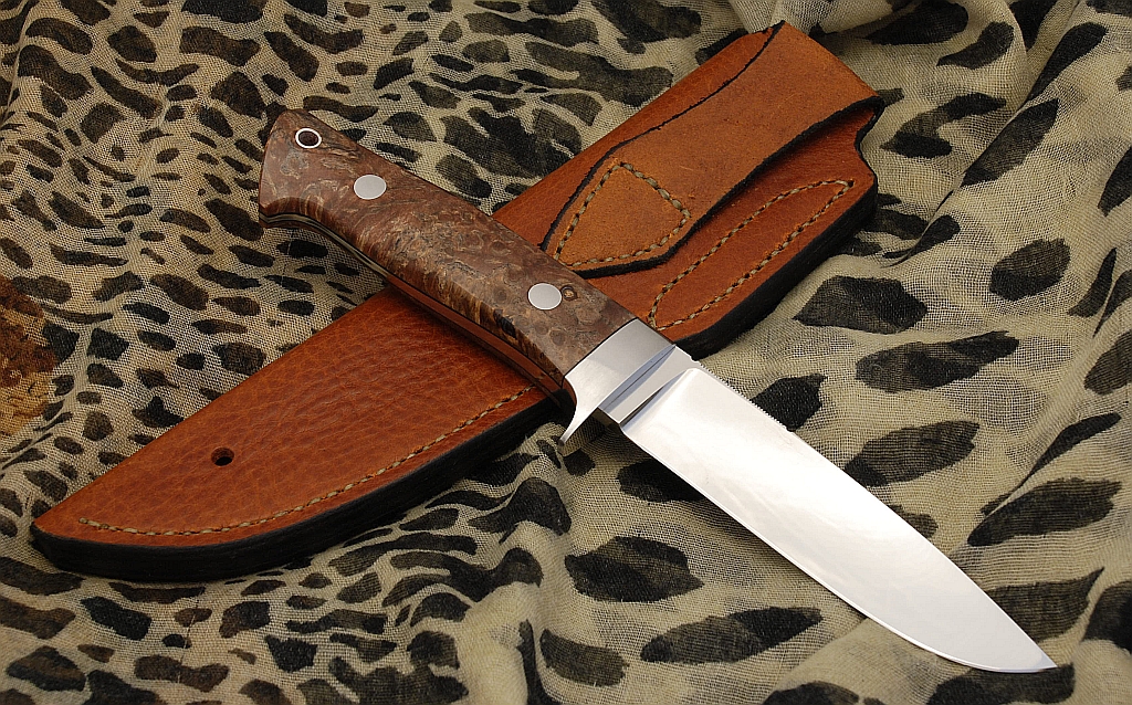

Hi friends,
here a drop point in full tapered tang costruction. The steel is 154CM satin finish the handle stabilized maple. I hope you like it!

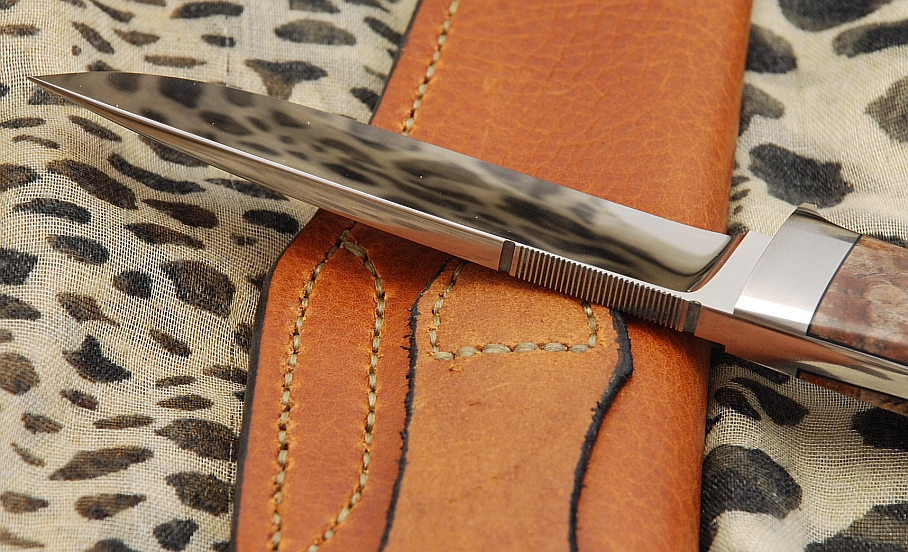

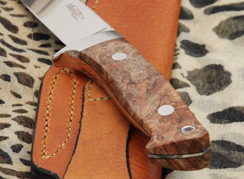

I always try to put the guard so that there is no gap with the blade plate. In this way I avoid brazing, which over time can cause stains on the steel.
