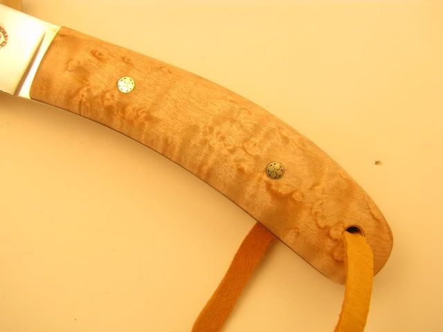

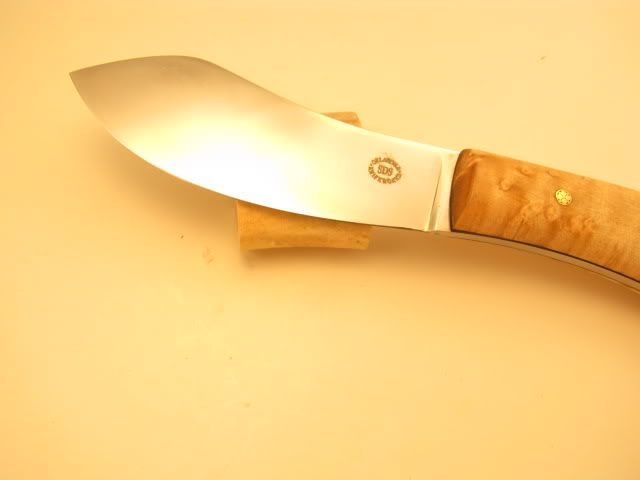

This one was a customer order.
1/8" D2 steel
stabilized birdseye maple
mosaic pins
This is the first time I've used maple and I really liked how it worked. I sanded it down to 2000 grit and put a light coat of tung oil over it. I realize it didn't need it since it was stabilized but it added a little depth to the wood.
Thanks for looking and as always criticizms are encouraged.

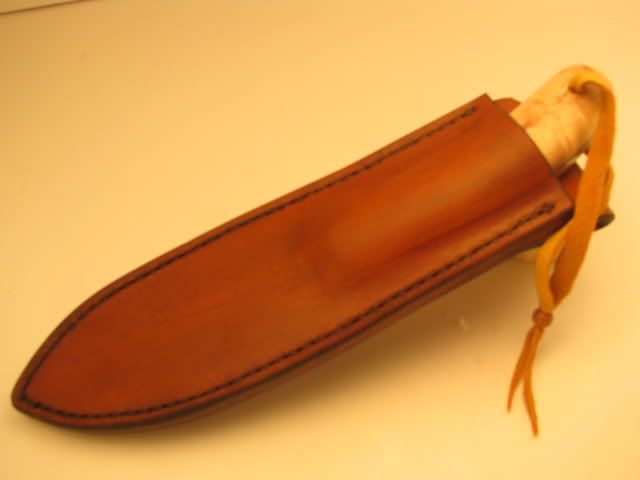

That's one of the nicest Nessmuks I've seen. The only thing I can say is maybe a little less hump on the top forward part of the blade but that's just my preference. Great job with the knife and sheath.:thumbup:
Ray, the design was provided by the customer and was his request. I would have chosen less "hump" myself when I designed it but it actually works pretty well on the finished knife. Thank you for the kind words. Coming from you it means a lot. You make some very fine knives.
