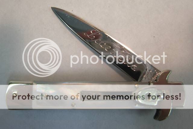

The New Hermes machines with rotary capability can be used without the motor. You will need a diamond drag stylus. This is what I use to mark my knives.
Using the rotary cutting function on steel will ruin the spindle-so don't do it! The lettering can be sized to the knife. This knife is 2-1/4" closed. (I hope I don't run afoul of the picture rules!)
