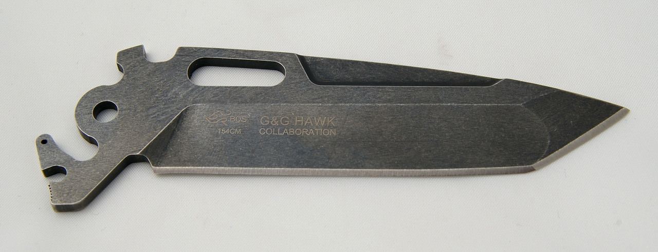

Does anyone know what these holes are for in the hidden tang of the Marksman blades? Maybe they identify the steel type of the blade so they don’t get mixed up before they get marked? It makes me curious enough to want to take apart my prototype Marksman with the 420HC blade to see if it has a different hole pattern (or none at all) - but I figured I would ask here first. Have any of you taken your Marksmans apart? What hole pattern did you find?

The Vantages have notches on the tang to indicate steel type. They are near the lock face relief cut and you can read more here:
Also, some 110's had holes in the tang to differentiate between blade steels
https://www.bladeforums.com/threads...-110-by-buck-why-are-these-holes-here.923647/
Here's the 154cm tanto blade from my one and only Marksman.
Thank you! That was some good reading. Steel-identifying marks they are, then.
Man, that is a good-looking blade.
