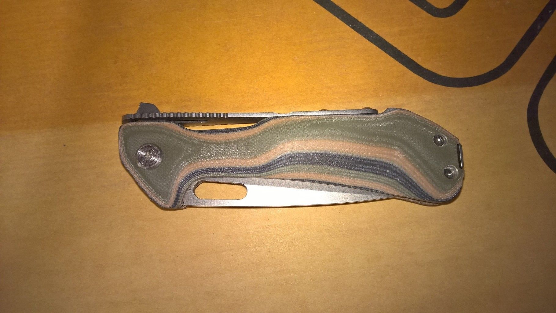

I classify myself in that group to an extent. I couldn't get used to carrying my 110/560 on my weak side while carrying a side arm so I've been struggling to find the right knife for front pocket carry. I started with the Marksman and absolutely loved it! Except that the steel seemed to need touched up constantly. The other criticism I had was the aluminum frame. For some unknown reason they added the geometric shapes to the handles which do little more than cause friction getting in and out of a pocket. They're not hand-friendly either. I guess they did it to add some traction to the frame, but I think they might have went about it wrong. To remedy that, I made my own G10 handles which made the in and out of pocket, and in-hand feel much, much better!

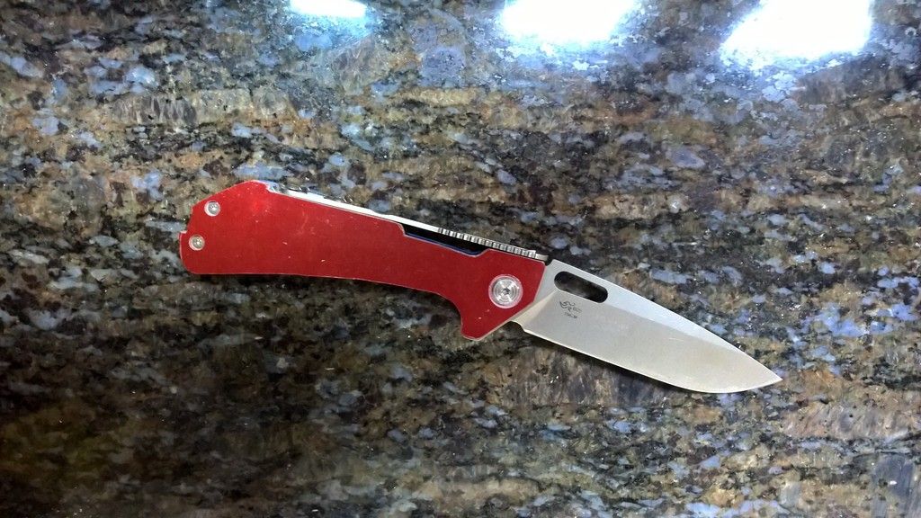

Photos:
Ok, thank you for taking the time to write this review on the Marksman. It helped me make up my mind. I'll shy away from it and hope SK brings out a 110 to my liking. Your work is handsome. DM

That was a Great explanation on the Marksman MT- Pokt and very nice job on the Micarta and G-10 scales 👍
