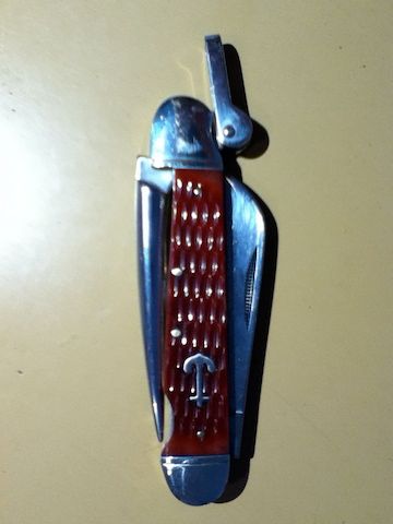

Hey . . . ahhhhh
I suppose this has been asked before but I got a couple questions about this knife :
It is a brand new Rough Rider Marlin Spike , 440 SS, Red jigged RR576
Does it seem right, design wise, that the anchor is upside down when the knife is dangling from it’s lanyard ? Or maybe that is the great white whale blowing and I am just not seeing it right ? :D

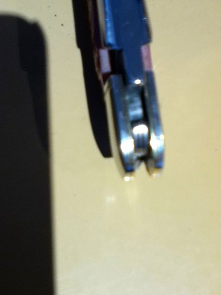

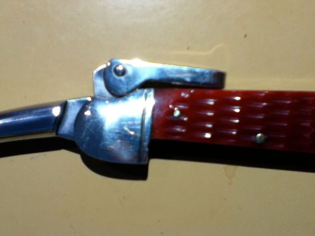

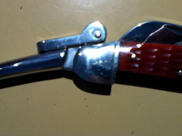

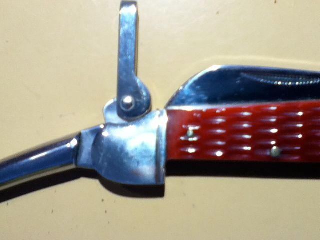

Also and more importantly, if any of this is really of importance, the lever “lock” on the spike . . .
should it actually lock? Because when I fold the spike open, push the lock into the notch in the blade hard with my thumb and then, with the lanyard loop forward like in the second photo, try to fold the spike back closed it just folds back no problem. It doesn’t feel like it could ever really catch . . . it does provide some resistance to closing but not much more than a similar slip joint of about the same blade length.

My spike locks securely open. The loop/lever must be depressed back to unlock the spike and fold it closed. I also have a Camillus marlin spike in abalone (probably the model RR copied from) which functions the same way.
If possible, you should send yours back for one that locks.
Yes it should lock open and depress lever to unlock and close.
This would be because you need to jam the spike into a big fat wet knot and and manipulate it to loosen the knot-especially for knots that have had large weight or tension applied to the rope.

The marlin spike should lock with the lever toward the marlin spike. And unlocked when depressed into the handle. That is if it is truly a copy of the Camillus which I have.
Every marlin spike knife I've ever used required you to hold the bail in the locked position when using the spike. It does not lock in place like a liner lock or lockback.
MY RR marlinspike locks. The bail is then free to move around, until you pull it up against the spring (about 90°). Pushing it against the spring unlocks the spike and allows it to close.
I have that exact knife, same handle scale and the marlin spike should lock. The bail unlocks it when it is rotated towards the body of the knife and depressed.
Thanks for all the replies.
Sounds like some varied experiences out there but for the most part she should lock up tight without holding the lever forward against the spike. In my case I can hold the lever forward as hard as I want and can still easily fold the spike closed with as little resistance as a normal slip joint; maybe a tiny bit more resistance but no significant change beyond just leaving the bail sticking straight up.
Any more comments on the anchor orientation ? Is it so the user of the knife when they look down sees it right even though an observer would see it upside down ? That seems odd for a decoration/artistic embellishment. I think most other such things are oriented so observers would see it right side up. Beating a dead horse here but I am kind of mystified.
Reminds me of the guy who said "That's nice . . . you have "MOM" tattooed on your arm." The other guys says "That doesn't say MOM . . . it says WOW when I look down at it".
It's a rope knife with a marlin spike, not the other way around, so the shield is oriented right side up when you're using the blade. :) And yes, my Rough Rider marlin spike locks.
