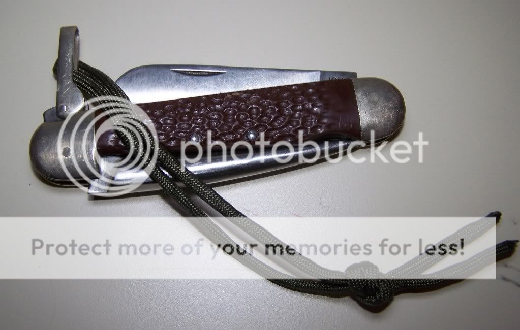

myerchin makes several rigging knives fixed blade or folding, that have a Marlin spike. or the spike can be purchased separately, also Camillus,Buck,Case,Ka-Bar, all sold rigging knives. used knives can still be found online at fair prices.

I have three, I like them. I don't carry it as often as I should, but I always take it if I know I'm going to be dealing with rope.
I have a Camillus model, Victorinox Mariner, Sog Nautical. They are all good in their own rite.
My favorite would be the Camillus but the Vic has a different approach to their spike.

Most spikes that come on folders tend to be rather pointy, which can poke you sometimes. The spike on my Camillus is a little more forgiving and I have still been able to work it into knots on very small line.
