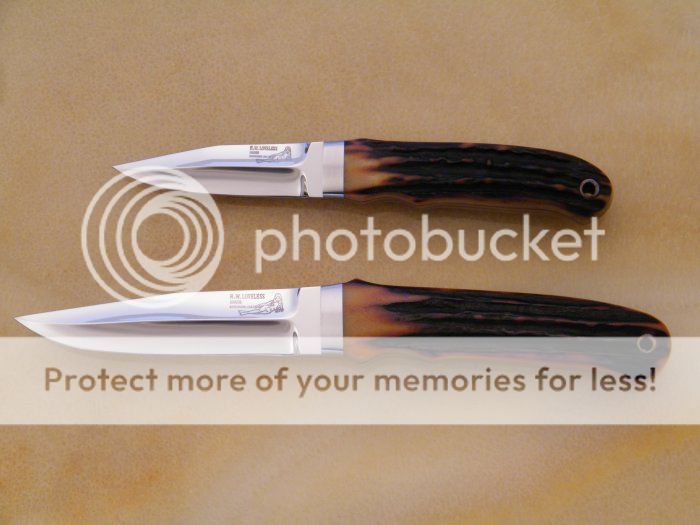

I just finished up another one of my Northwest specials. These are my version of the Loveless classic NYS.
This one has a 14c28n Blade, and classic maroon linen micarta. The blade has stonewashed bevels and polished edges. The pins are carbon fiber and it has a copper lanyard tube. This is the first one I have done that is hollow ground on my 12" wheel. It has a fine edge and should be a keen little cutter.
Comment and critiques are welcome.

I like the pattern and materials, but I think the handle is chunky.

I like the looks of the double grind of the Loveless original, although less practical for using than that high hollow. Unless it's being used as designed- weapon-like. But really, people like using knives for other than weapons, so that grind is a better choice if this knife is utility oriented, as it looks to be and knowing you it's a fair guess I figure.
I think you should consider bolsters for future iterations.
Don't like the copper lanyard tube. It will darken in time, so no big whoop there.
Sweet rendition
I would prefer the handle to be a tad more contoured but that's just a personal preference

The spine shot is kind of deceiving, because it is such a small knife. The handle scales are only about an 1/8" thick at the blade, and the handle itself is only 1/2" thick there. I only used 1/4" micarta w/ liners whereas traditionally it would start with 3/8" and liners. The handle is flat on the top and bottom, but this really index's the knife nicely in hand.

You pretty much summed it up Lorien! The blade grind while being a bit more practical for edc use, is also a bit more legal to carry as the top edge is not sharp. And it is still plenty "stabby". :cool:
I thought about darkening the copper tube, but I figured it would take on a nice natural color with age or the end user could patina it. I am sure I will do one with bolsters at some point.

Thanks very much Joe! The sheath is setup for vertical carry. Although I have done a few with horizontal, generally I get more requests for vertical sheaths. Since this was not a commissioned piece I opted for what I thought the majority of people may want. I agree this design lends itself to a horizontal sheath very well.
For me (being the skinny guy I am) I prefer an inverted (handle down) kydex sheath on my weak side if I am carrying a small fixed blade. A horizontal sheath sticks out like a sore thumb under a T shirt. :)

I feel your photos (photo angle & lighting) are making the edges of your handle 'look' very 'squared off' creating a clunky look as opposed to having a nice contoured and ergonomic look.
Thanks Rolf, Nick and Kevin.
I think the scale is apparently not perceivable in the pictures. Like I said the top and bottom of the handle are "flat" (and so are pretty much every other NYS I have seen pictures of), I made it that way so the handle indexes in your hand. But it is far from being clunky.
Here is an in hand shot that may better show the scale of the knife and handle shape.
