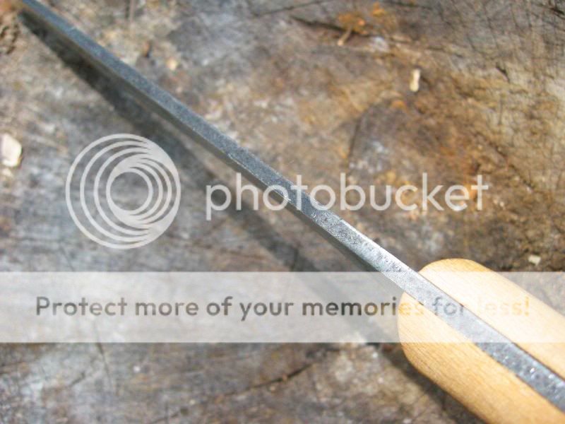

Continuing my recent golok phase of knife collecting, I found a Martindale #2 on ebay. It came in all the way from England yesterday. The Brits call these goloks "beaters", and now I know why. Too dull to chop, they are obviously used to beat things. The Martindale gives new meaning to the term "zero edge". They come with absolutely no edge at all. With just a crude outline of a primary grind for me to follow, I proceeded to grind a convex edge on the beast with my 1" x 42" belt sander. In just a few hours, I had a decent chopping edge, and a pile of steel dust. Did they really expect the customer to do this with the little file included in the sheath?
The knife has a 13" blade and weighs about 17.5 oz, after grinding. The blade has a distal taper going from .128" at the tang to .90" at the tip. The steel is soft (thank God) at about 45 to 50 RC. The handle is wood and secured with two rivets. Fit and finish are consistent with the term "Beater". Not nearly as nice as the Condor I recently reviewed, which came with a polished convex edge that only needed a bit of touching up to shave.
With a decent edge, the #2 can chop quite well. As sold, it can beat dents in wood with ease and beat grasses down to the ground. Balance point is about 3.25" in front of the handle for a nice blade heavy feel that works well for chopping and slashing vegetation once sharpened.
