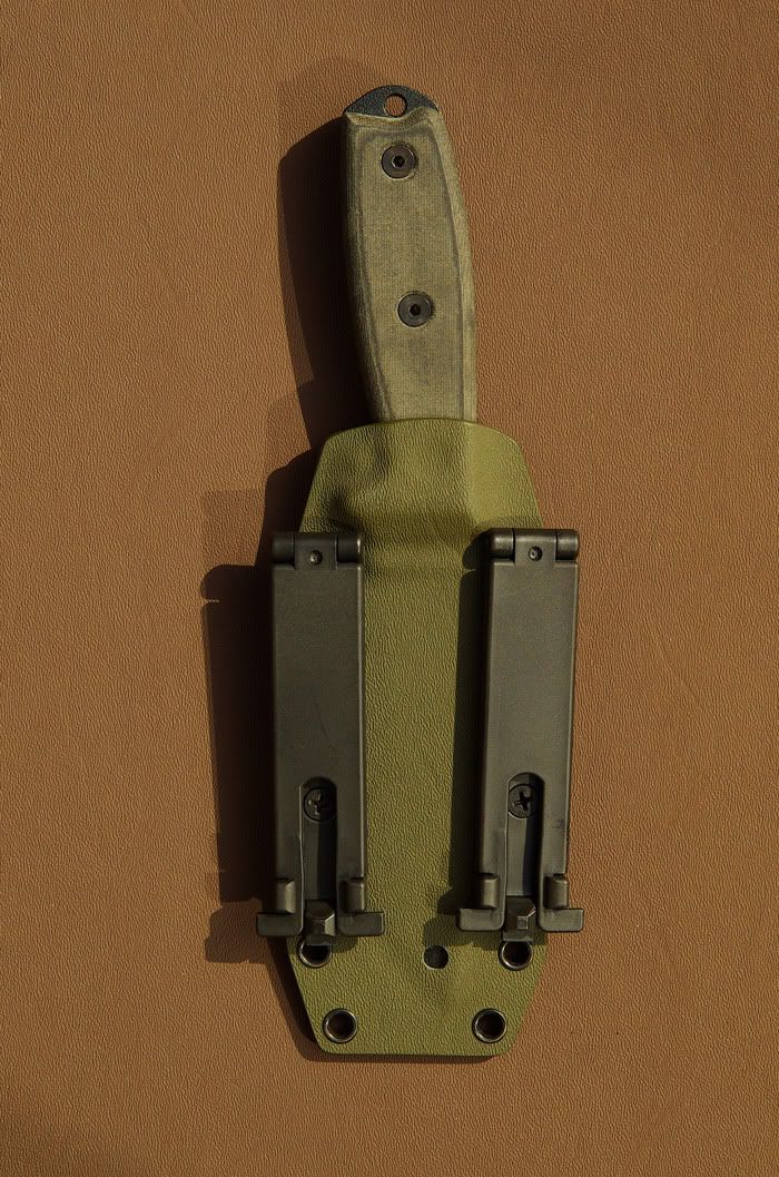

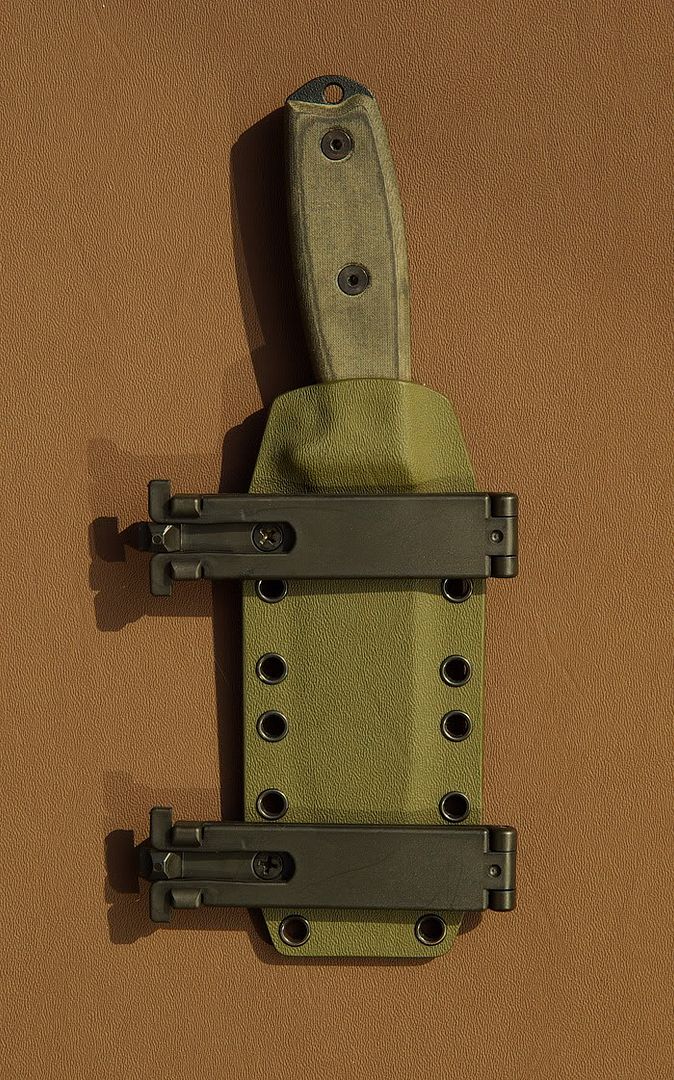

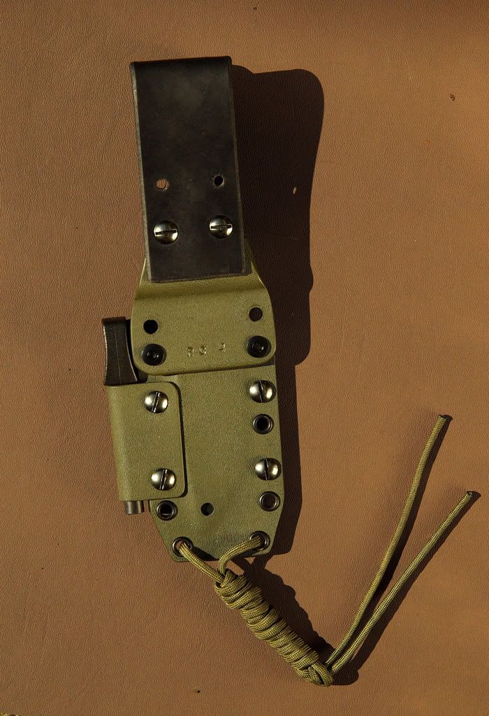

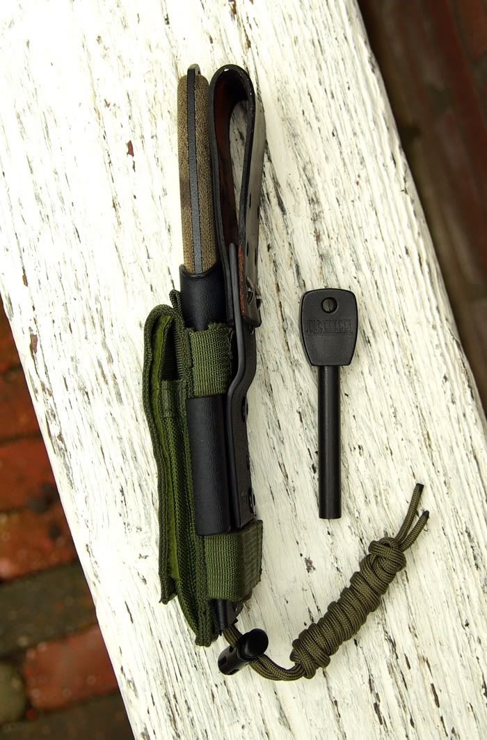

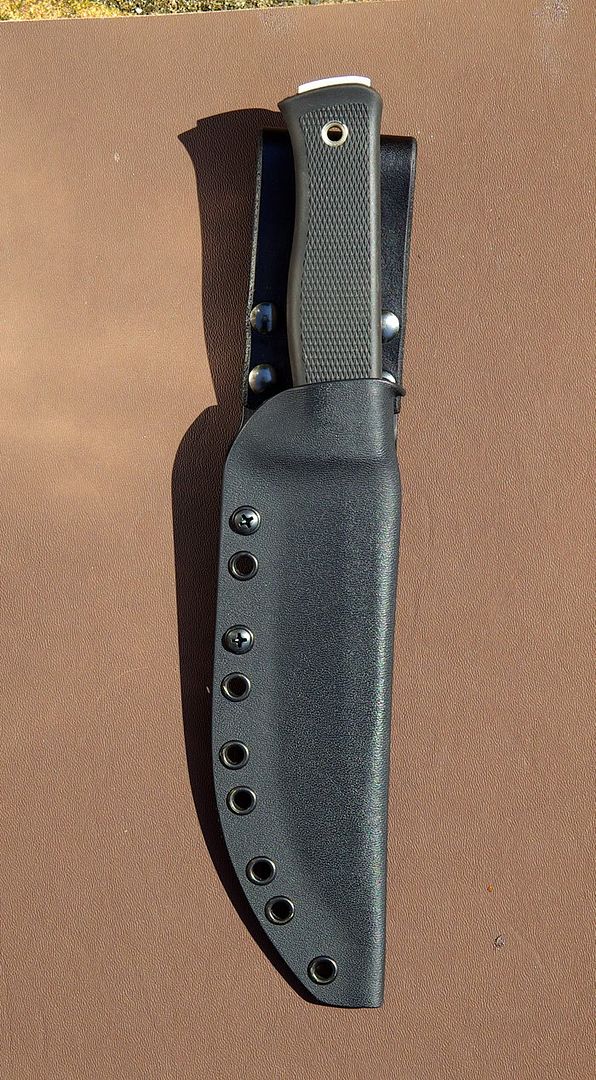

After having done numerous kydex liners for use inside leather, I decided to make some sheaths out of mainly kydex.
This one is for the RC-4, made by Rat Cutlery.
The sheath is made pancake style in order have eyelets on both sides of the blade to provide in many attachement points.
I prefer to have the drainage hole at the bottom of the sheath, but this one is closed, so I drilled a hole through and through.

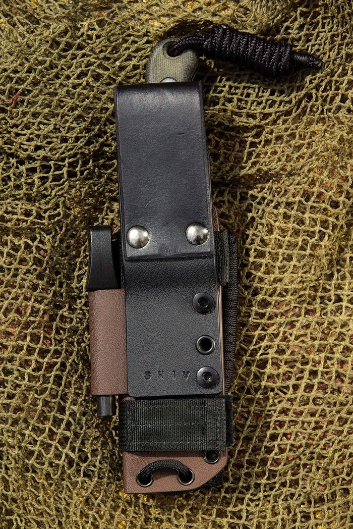

It fits both molle and tek loks. The teklok can be used in horizontal, vertical and canted position.
The front plate takes a malice clip to attach a pouch to.

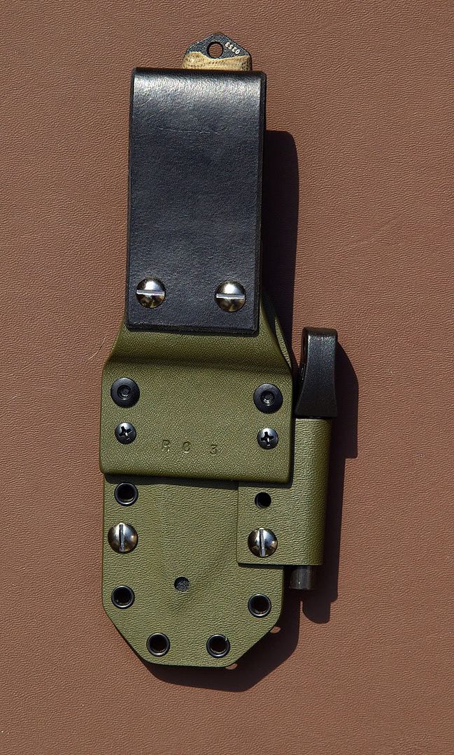

If high carry is unpractical, a beltloop can be mounted. The kydex backplate also takes a teklok. The leather loop has a very comfortabel compromise between flexibility and rigidity..

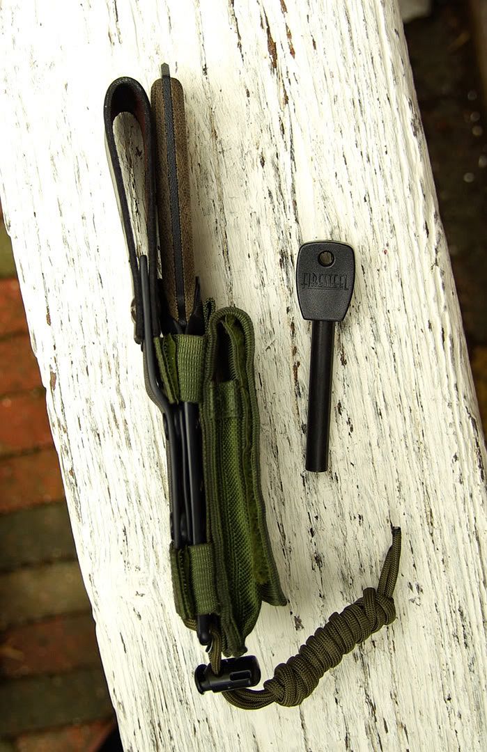

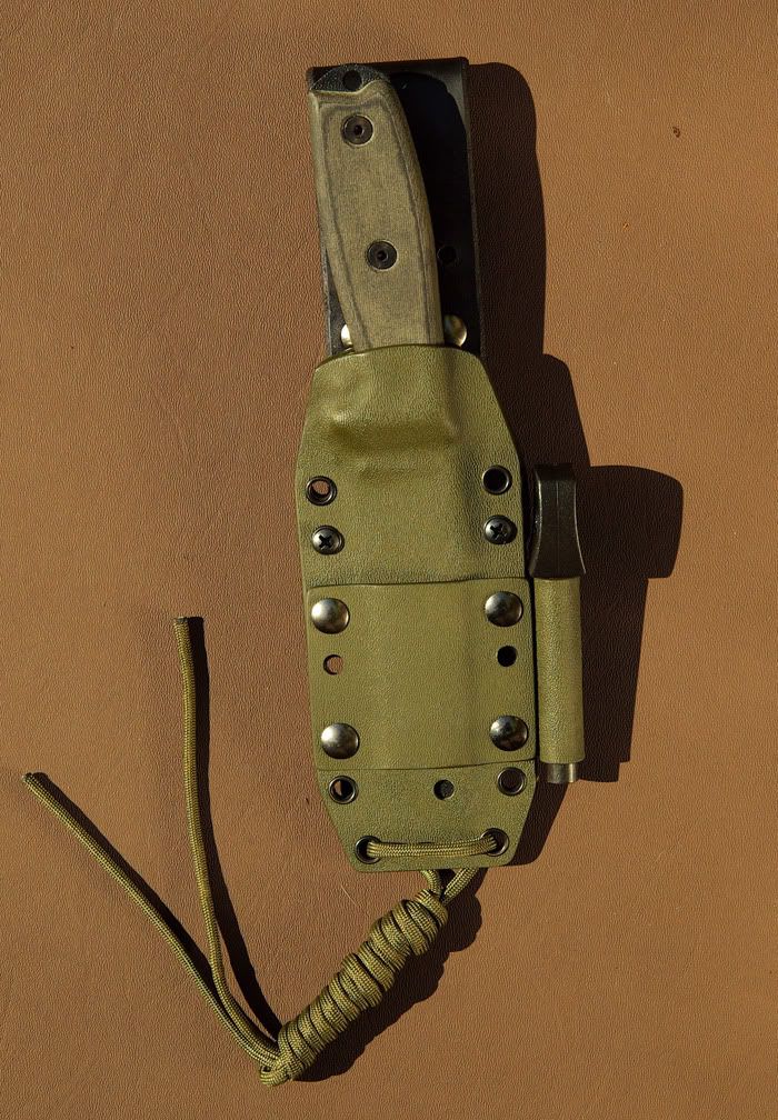

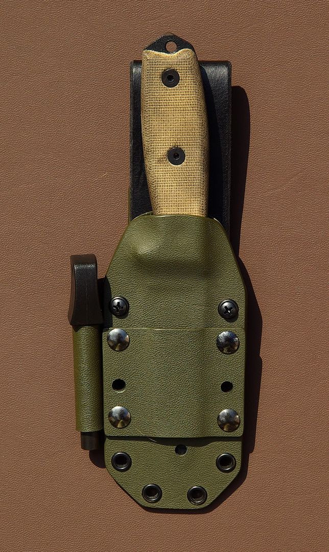

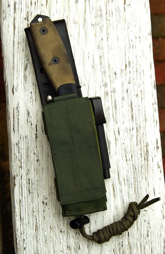

Same design, but for the RC-3

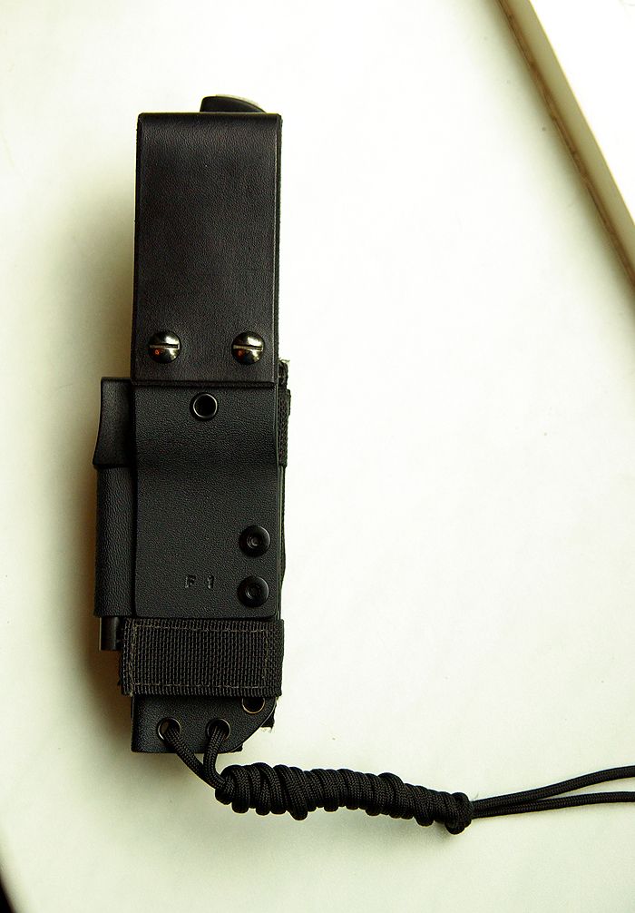

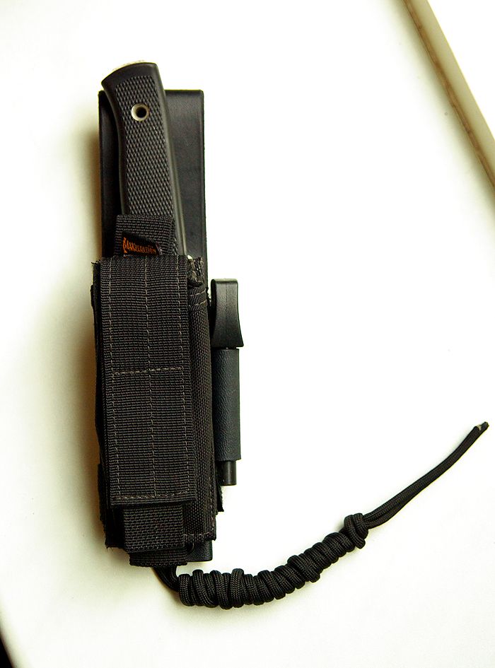

This one is foldover style.
It has less attachement points, but is a lot less bulky too. It fit's the Maxpedition "Single Pouch" or the Eagle pouch as sold by Blade Tech. It's meant to be a very versatile sheath. It's all modular, and will fit a teklok too.

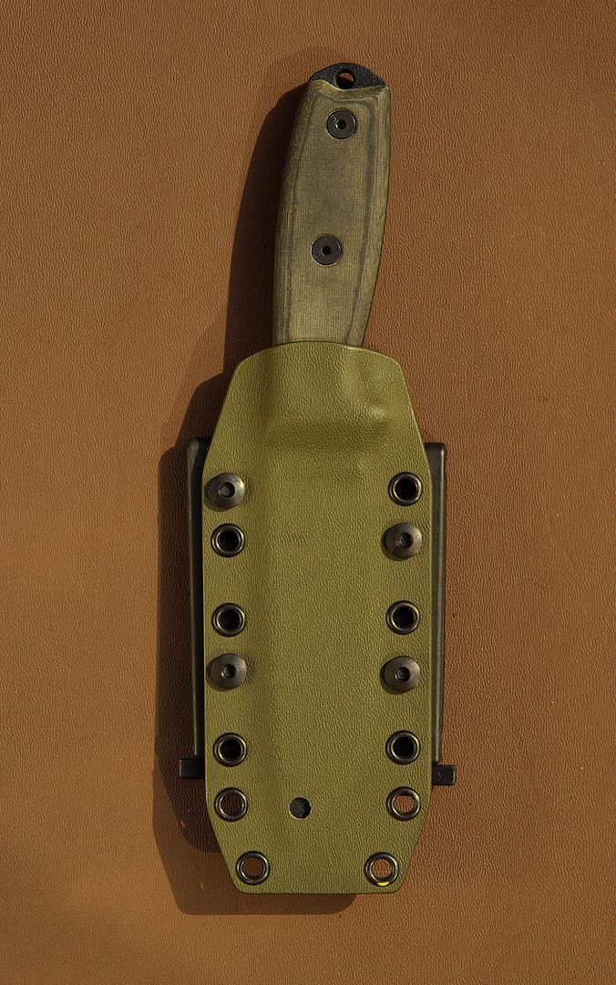

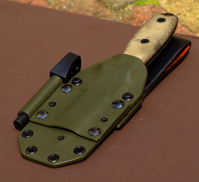

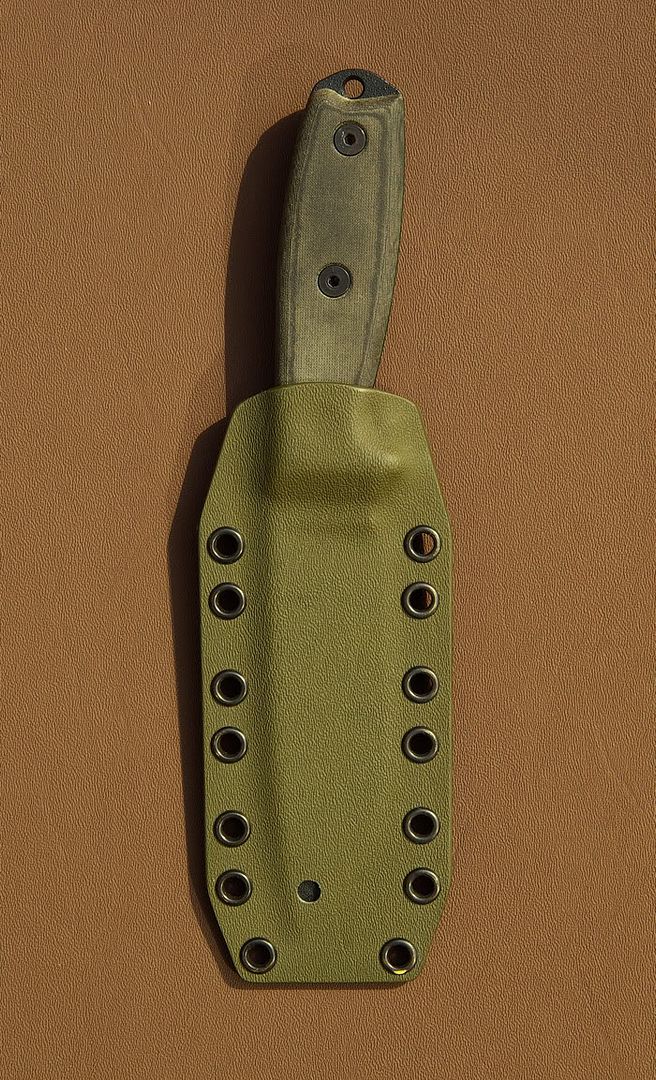

Classic style
The sheaths are made of 0.08" or 0.093" kydex. The backplates are made out of double folded 0.08" or single 0.125" kydex..
