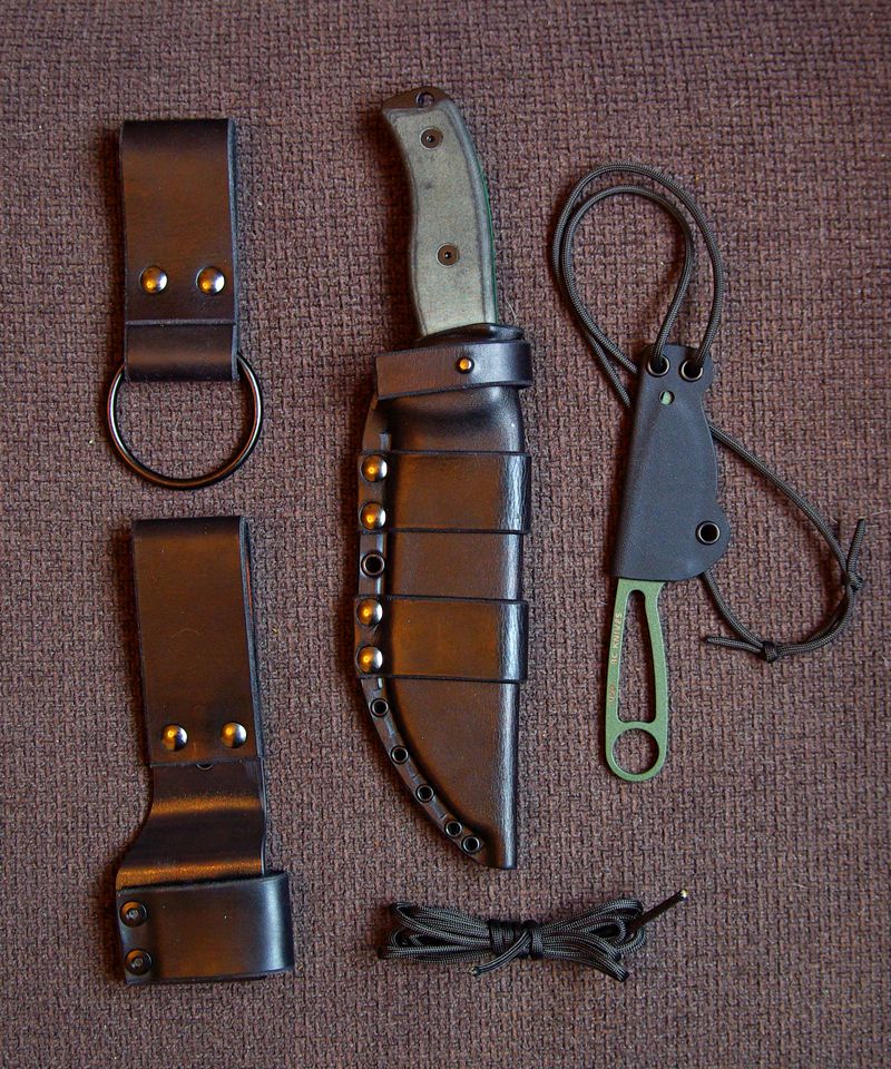

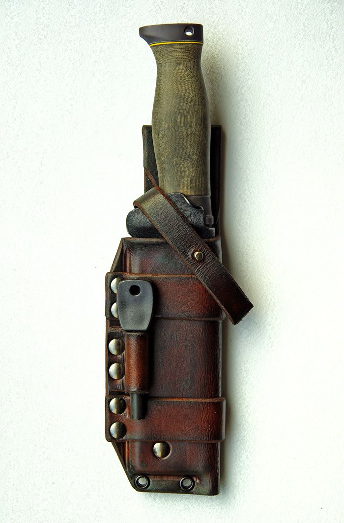

Some examples of the "Technical Sheath" I'd like to show.
These are modular sheaths that sport halftanned leather outers and a removable kydex liner.
The sheath has a drainage hole and some have a retentionstrap.
Most have a (removable) kydex backplate with a droploop, but some have an integral droploop. The removable droploop could be replaced by a teklok. The teklok also fits directly onto the body of the sheath. They have a firesteel loop and 2 horizontal straps.
Enjoy the pics.

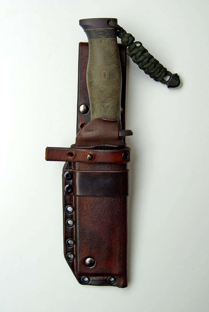

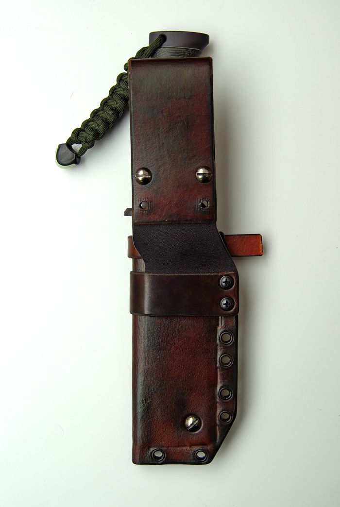

Andrew Jordan OPO:

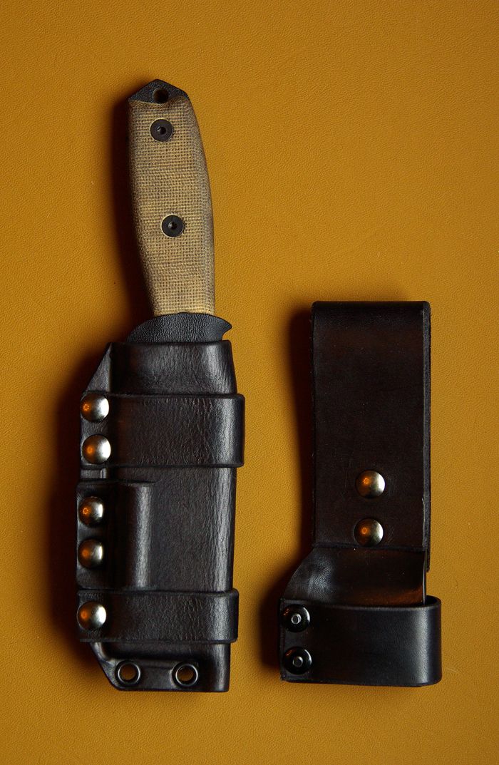

another OPO:

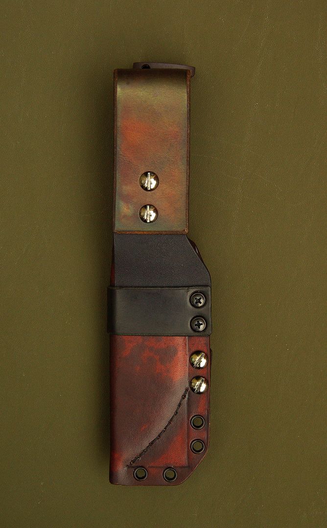

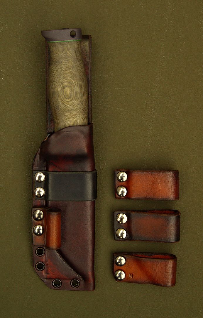

Andrew Jordan small Scout:
(this one is made for Stani Groeneweg from http://discoversurvival.com)

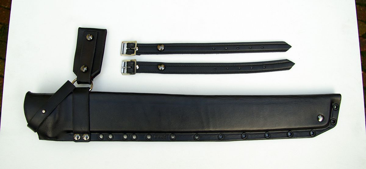

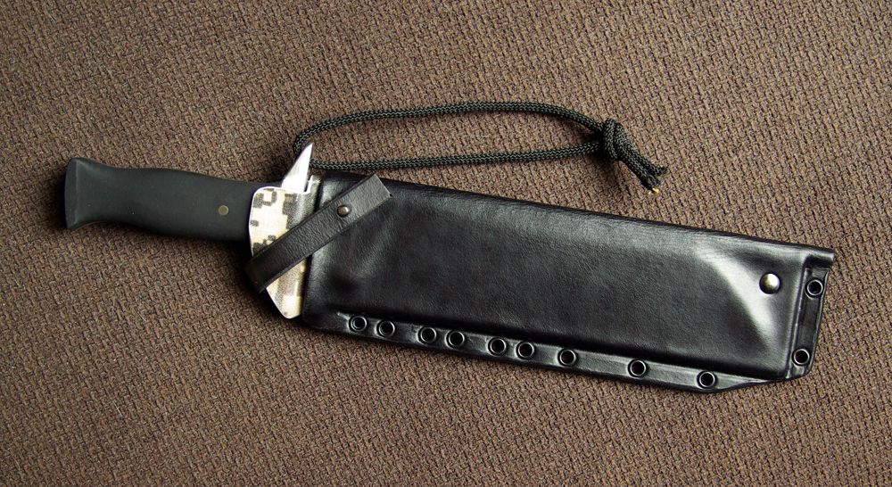

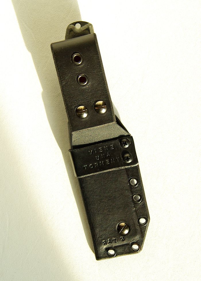

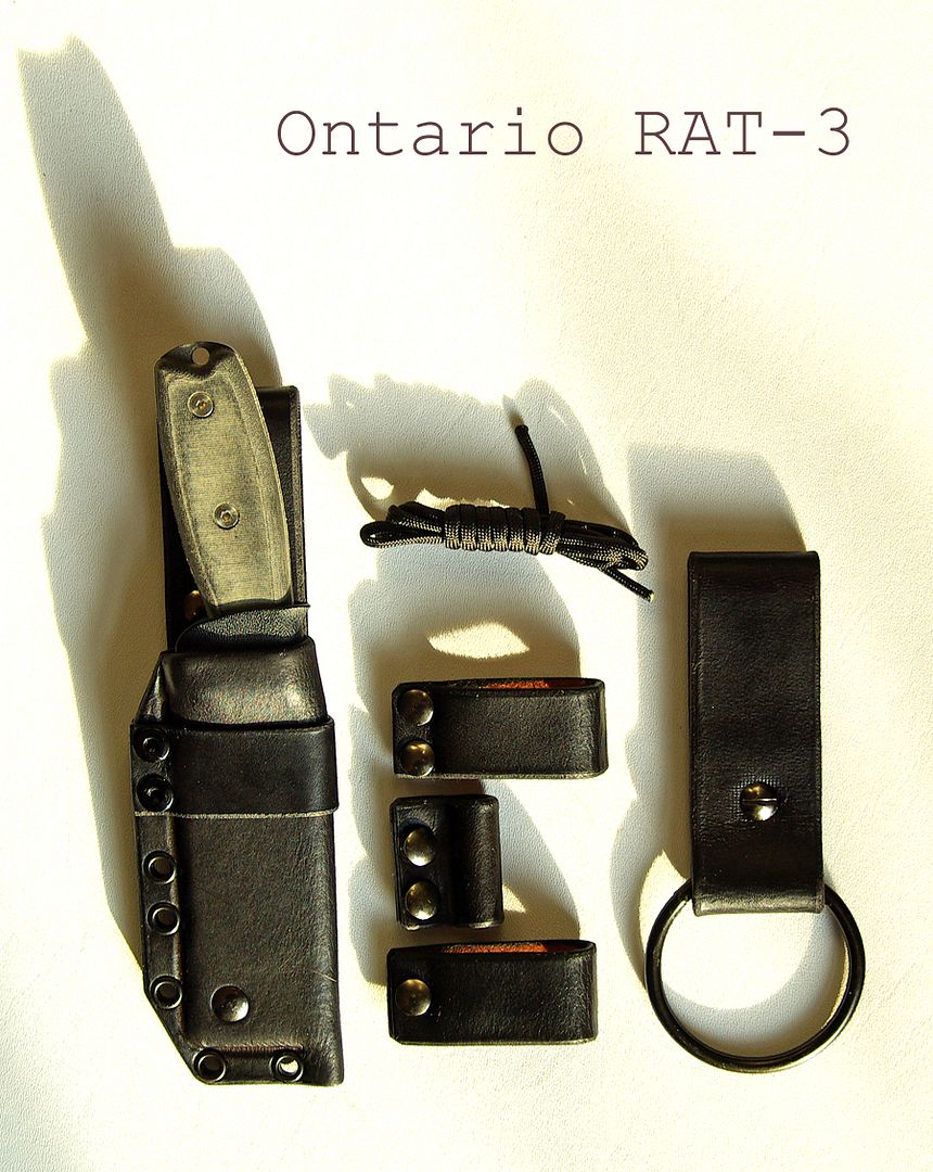

Some ESEE and Ontario/RAT
I hope you like them..
