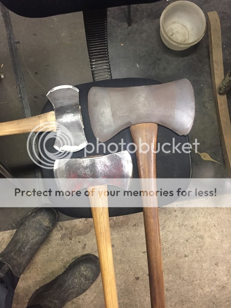

My neighbor who's a axe hoarder acquired a 7lbs double and J.willliams hewing axe at a yard sale in Cincinnati some years ago. I've been trying to find any information on these large double bits for him. Still haven't found any info that would give an idea of who produced these. Figured I ask here in case someone knew.
For size comparison next to a woodslasher cruiser and a modded saddle axe
7 lbs, i doubt this could have been used by just anybody back then, DAMN thats alot of steel to move and swing around all day... wow.
I believe axes up to seven pounds could be ordered from American Axe & Tool Co. If they offered that service I can't help but think others did also but I can't say for sure.
That's all I got but there are guys here that know lots more than I do.
A 1923 catalog from Collins shows the single bit "Yankee Axe" in weights up to 8 pounds, but the maximum weight listed for their "double bitt" axes was "only" 6 pounds.
Thanks for the replies everyone! It would take a stout man to swing this axe all day. Im sure it would throw some serious chips too! No way I could handle it!

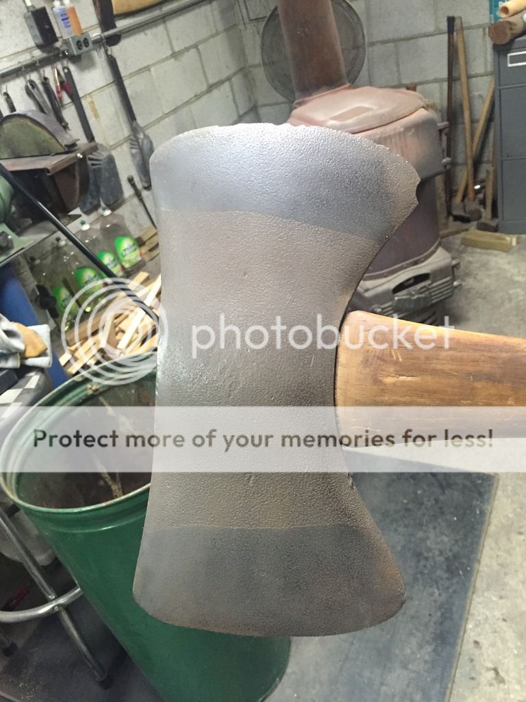

The axe head does give use some clues as it is of an overcoat construction. It's not much though...
Thanks a lot Gary ! I figured that this axe was some kind of special order. No way these would sell by the lot. I've tried researching

I wouldn't call it a hewing axe.
Is it 7 pounds with the handle, or is it stamped with a "7" somewhere. Either way, that's an impressive DB.
Edit: Nevermind...I missed the 7 stamp when I first looked. That a monster.
