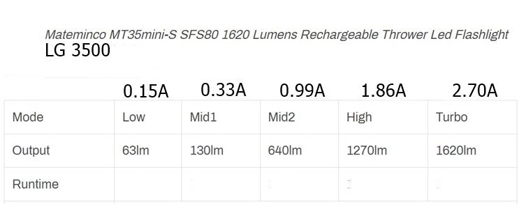

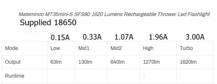

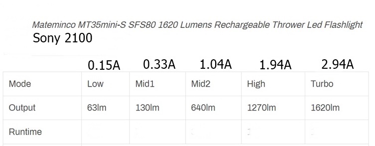

I have some current draw results for various batteries including the one supplied !
The Nitecore 2600 was only included for current draw comparison … It’s a protected battery and will be a crush fit in this light .

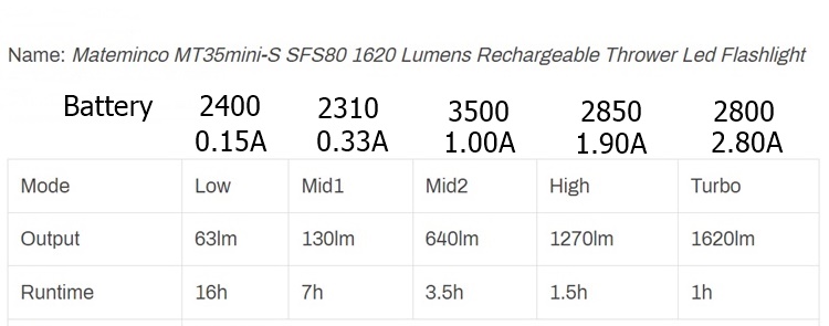

Now there are some runtime claims and … I can only guess some ones calculator was maybe not functioning correctly … In anyways some figures .

Taking into consideration the current draw , especially in Turbo ( 3A ) . A 18350 is going to be strained to say the least . The supplied 18650 was certainly very good as tested and came out on top against some serious competition . If you go down the 18350 route , I would suggest either buying the best 18350 you can or just stay out of Turbo mode . All I have done today is take measurements and play with the light . I will try for some beams and Video ASAP .
