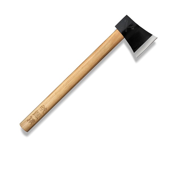

By the way, this is the hatchet in question
Evidently it is drop forged 1055 carbon steel, differentially heat treated. The hatchet is a bit over 2 lbs in factory form, I'd like to reduce that significantly while maintaining the same shape by taking material evenly off of the cheeks and at the butt/poll. There is a ton of excess material. This hatchet hits hard and bites very deep (granted at least partly due to the factory weight), I believe the straight cutting edge and squared heel/toe play a big part in it's performance. Significantly reducing the weight will hopefully make it easier to haul around and swing without negatively impacting performance in my use.

For that hatchet job you could just use a cheap Harbor Freight belt grinder. It's gonna eat a few belts though!

All these would be good suggestions if the OP was a smith with a forge and shop. But he is not.
He is looking for a simple and cheap way to thin the head. I don't think that is a good idea, but it is his hatchet.
The best suggestion is an HF belt grinder.

Correct, not a smith by any stretch lol! I would love to make knives and tools maybe one day, I have ideas for knives/tools that I would love to have but aren't currently or readily availible. It would likely be years before I would be able to do so though. In the mean time I'll try my hand at some modification of existing knives/tools and try to learn as much as I can.
The HF belt grinder sounds like the ticket for me at this time and I could use it for other projects. I may try to piece together a DIY misting setup just for peace of mind in not ruining the HT/temper. Otherwise, I will just take it very slow, small amount of material removal at a time, dip in water and repeat until complete.
