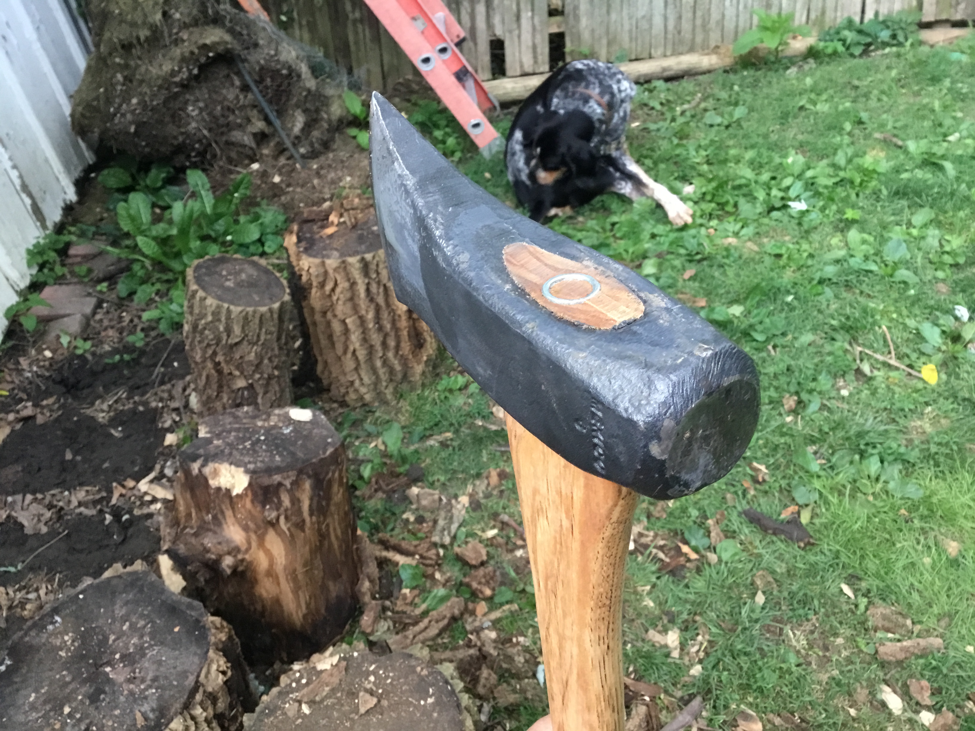

There's no reason that a properly filed axe won't split wood. You'll probably just run into a similar circumstance with the new one. Sounds like you just need to spend more time working on the bit of your Collins. I'm out now but I'll post up a pic or two of an appropriate profile for splitting when I get home.
For some reason it's next to impossible for me to get my phone camera to focus edge-on to the bit. But here's a few photos. If you can achieve anything even close to this you should be fine! You want a slightly convex shape not flat edges like this diagram. But this is a good angle for splitting I've found.
Here's my favorite splitting axe. A 5lb Snow & Neally;
The leather wrap was a bad idea btw. Didn't hold up very well at all. It did offer some protection but it's ruined after 1 cord.
Hopefully that will help give you an idea of what you're looking for with your Collins. Good luck!
