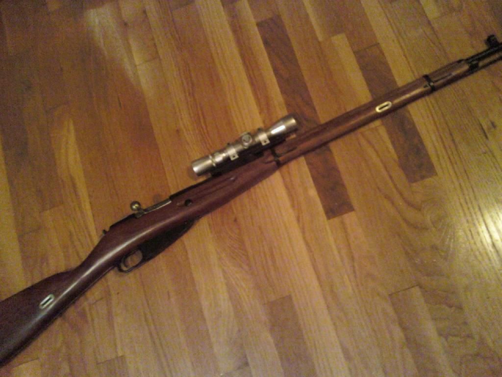

Just acquired this Turkish 8mm Mauser. It is a 1940. The wood is awesome. Great looking gun with a super smooth action. How do I get some of the grime and grease out of wood without ruining it?? I need all the advise I can get!
I would guess. I used oven cleaner on my SKS, but that WAS cosmoline. The flash from the camera makes it look a lot lighter than it really is.
I've seen and heard of mosins having cosmoline removed from the stocks by taking the stocks of, wrapping them in paper towel or something and putting them in a couple of black trash bags for a few days and leaving the stock (trashbags and all) in the dash of a car for a few days when it is hot and sunny to melt out the cosmoline.
I personally have not tried it yet, but whenever I manage to get another mosin (after I foolishly sold mine) I am going to try cleaning the stock up the same way.
I'd say that if it is cosmo on your mauser it might work, and I don't think that it has even a possibility of harming the gun (my opinion)

Ifit's just grime and a little grease a good scrubbing with mineral spirits should work. If it's something more sinister like cosmoline I used to throw Mosin stocks in the trunk of my car and just wipe the cosmo out every day. Some stocks took a couple of days, some of the nastier ones a week. I would NOT leave stocks directly in the sun, especially thinner pieces like the hand guards. I have seen them warp pretty badly.

Cosmoline supposed to melt at about 150 F. Saw an article about making a garbage can and light bulb unit to melt out the cosmoline .Solvents took out the remaining.

May not really need cleaning. Brownell's sells TCE Degreaser. Use it and some shop rags and 0000 steel wool. Try it on just a spot of the stock to ensure it just cuts through the grease and gunk and not that particular rifle's finish.

Cosmoline was designed to be cleaned with what would be available to soldiers in the field. Stuff like gasoline, kerosene and diesel fuel.
I don't recommend gasoline for obvious reasons. I have had good results with kerosene.
