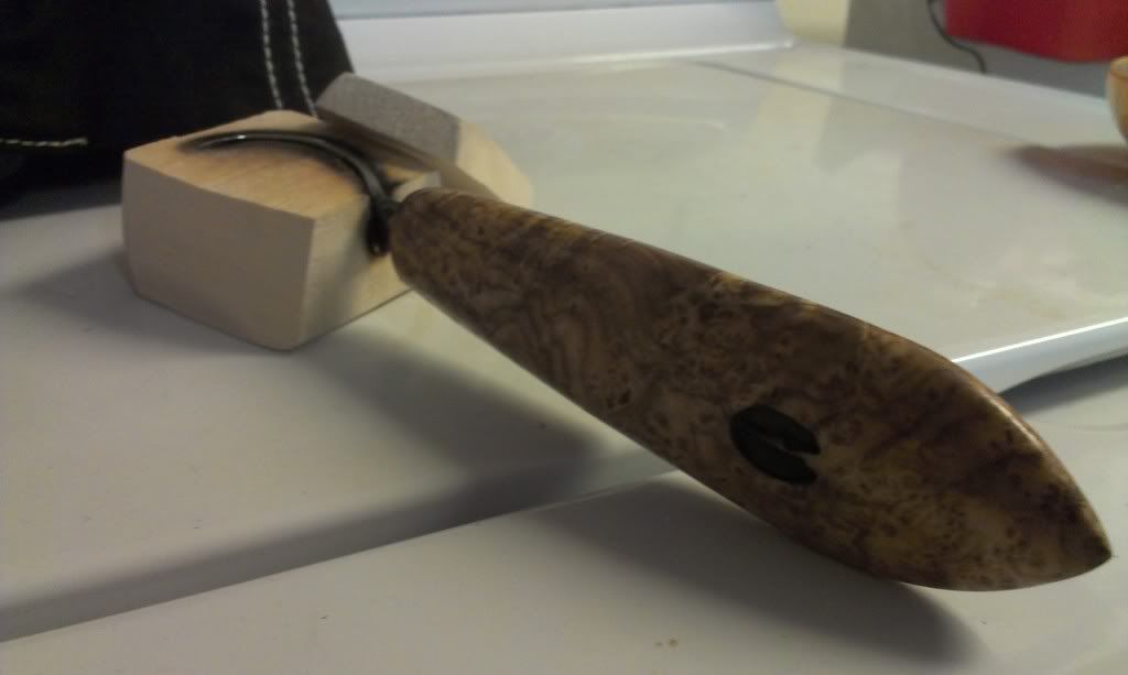

Hey guys. I made a little wooden box for my hook carving knife.
My question, and maybe it's dumb, but better safe than sorry, is... Is there anything in charred wood that can damage 1095 steel?
I like my box, but I love my knife!

If it's dry I don't see how it can.
It could however, scratch your blade, and maybe even dull it.

char has slightly higher silicate than raw wood - depend on volume shrinkage %. Ash concentrate all wood silicate/volume in much smaller volume, thus more dulling affect on your blade.
Speculating ... Salt in char is low ppm so I wouldn't worry about rust. Otoh, wet ash (taste kindof salty) could has minor oxidization affect. Trees & plants usually has some sort of anti-freeze agent in them, oil/sap/salt/etc..
I'd just make sure the wood is DRY, as mentioned, and is stored in such a manner as to keep it dry. Might also be worth sealing or oiling the wood, just to minimize the chance of it absorbing moisture in the first place.
I tend not to like storing any blade in something that's in constant contact with the steel or the edge itself. Anything the wood holds onto (moisture, dirt, salts, acids) will be held against the blade and may create corrosion. Same sort of issues as with storing it long-term in a leather sheath, for example. And as mentioned, if the edge is in contact with the wood, dulling may be a possibility; especially with the charring. Keeping the blade dry and clean, with some space for air circulation around it, is how I'd prefer to store them, unless they'll be used very frequently and therefore watched and kept judiciously clean.

My concern was with the composition of the ash... Whether it has acid in it or not, that kind of thing, but dulling would be terrible. When I was making it, I thought about trying to line the bottom with cork or something. Maybe I'll carve out a larger channel and line the whole thing with something.
What would be best? Cork? Leather? Other?
How about lining it with paraffin wax or some similar product. If you enlarge the area so the blade is loose and line/seal with wax, then no leaching from the wood. You might carve out all the burnt part before lining it.
I know where you got the idea, and nothing was mentioned about any danger of damage to the blade. ??? I guess better safe than sorry.

Whatever it's lined with, I'd choose something that doesn't hold moisture. Cork might be good for this, or a synthetic material like rubber/plastic. I'd still try to find a way to keep the blade free of any contact with it, so there's no chance of either dulling or corrosion being caused by it. I remember seeing a thread some time back (linked below), with pics of an old traditional folder that had some 'tells' about some of it's past. There was a specific spot of corrosion in the central portion of the cutting edge, and a small bit of wood (maybe a piece of matchstick) that had been inserted into the blade well, just over the 'hump' in the spring where the spring's anchor pin goes through it. A previous owner of the knife had no-doubt put the piece of wood in there to keep the cutting edge from contacting the backspring when closed (very common problem). The central portion of the blade edge had therefore been in continuous contact with the wood over a long period of time, and had become noticeably corroded. That's why I emphasize making sure nothing is contact with the edge, when stored.

Felt can hold particles that can scratch the blade. I would consider just burnishing the wood and giving the blade a wipe with an oil cloth/gun cloth before putting it away.

I've now cleaned out the channel of most of the ash... to the point that I'm no longer worried about its effect on the blade short term, but I'm still a tiny bit concerned about dulling, and long term storage.
Obviously it's looser in there, which I think is a good thing. I kind of wish that I made it so that the knife was stored edge up though.

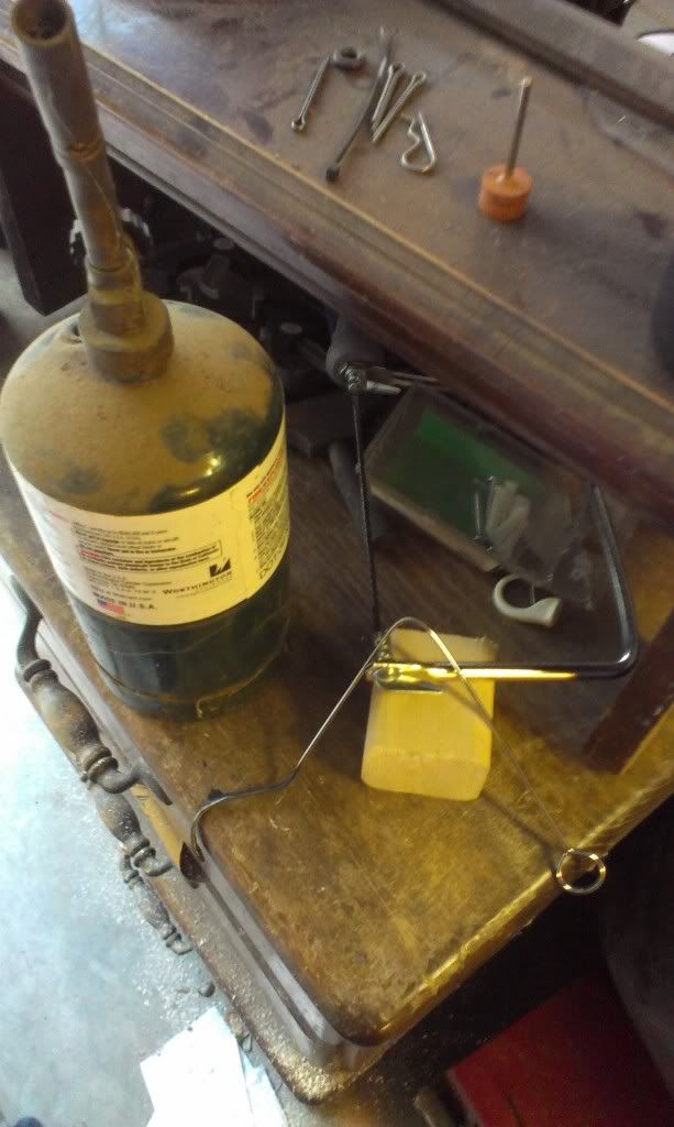

Forgive me if I'm seeing your photo wrong, but it looks like you've heated the bade to get it into the block. If so, wouldn't that kill the temper?
I think he used a hot wire for burning the shape in the block, but he can answer this better than me. He did a great job on fitting the blade to the box. Reminds me of my wood burning kit when I was a kid. After trying to "brand" the cat with it, my mother removed it from my possession. (also a little hide from my young butt :eek:)

Ben, no I used a shish ka Bob (or however you spell it) skewer, which I heated with a torch, then formed into the shape of the blade. You can see it bent up in the cluttered pic. That poor thing... after getting it red hot several times it bends like tin.
I really should link to the guy that gave me the inspiration, but I don't have it handy. It was not my idea, other than a few little things like the dowel pivot, which works really well incidentally. Only bit of advice I would give if anyone plans to burn wood for depth is to clear out the char after each burn. It will prevent further burning from taking place if left alone.
