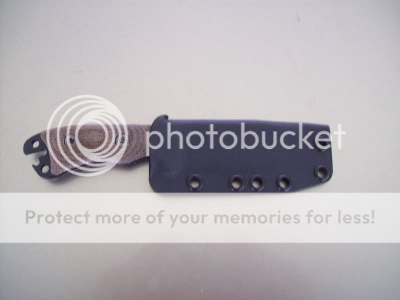

So i'm sure most of you have seen my kydex sheath i picked up for my bk11 last year
some pics
as I am guessing most of you know, the sheath is Kydex...and apparently kydex doesnt do well in extreme heat
i live in mississippi...and its august. So i decided to take my bk11 out of my emergency truck kit and check it for rust and lo and behold i discover my kydex sheath is all warped and twisted, the retention is bad...and i start to get upset. Havent done anything with it since last year, but its sat in the truck in the heat all summer meh
then i think about it for a minute and take it into the bathroom and bust out my wifes hair drier, turns out it DOES get hot enough to make the kydex soft enough to work with. so i got it straightened out, now just trying to get the top part right, enough retention to keep it from falling out, but loose enough to actually GET the knife out when i want.
man, here is something i never thought about when i bought this sheath. Thought it may be good information for other folks thinking of what sheath they want to buy.
