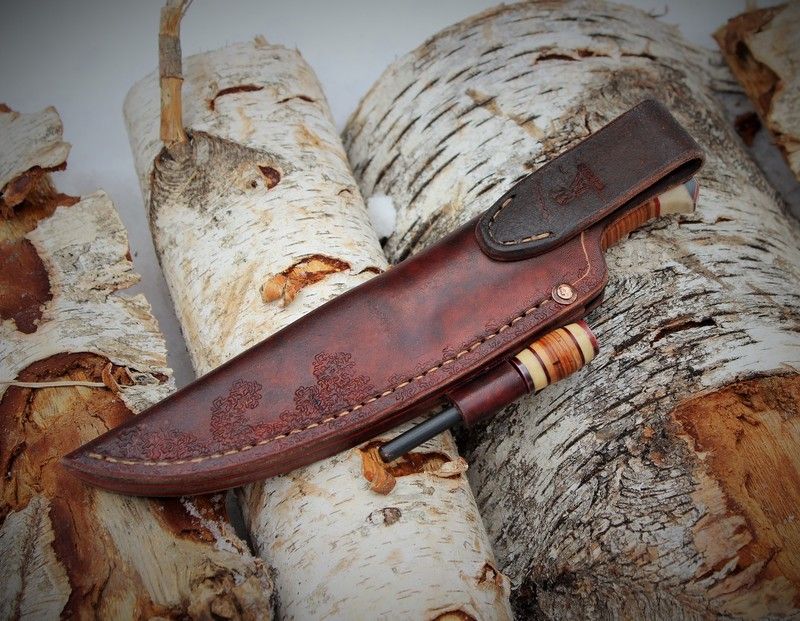

Here are the results...

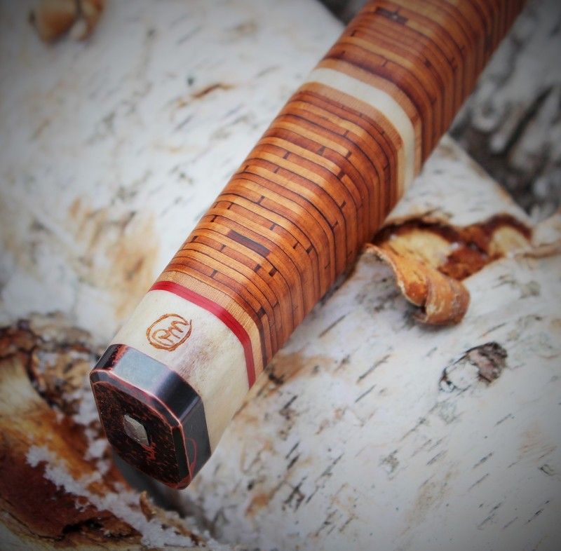

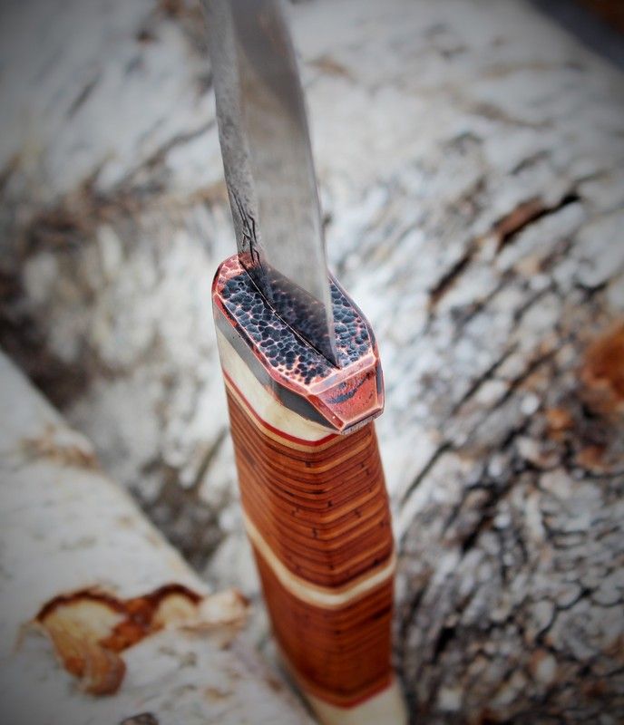

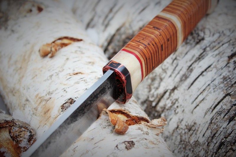

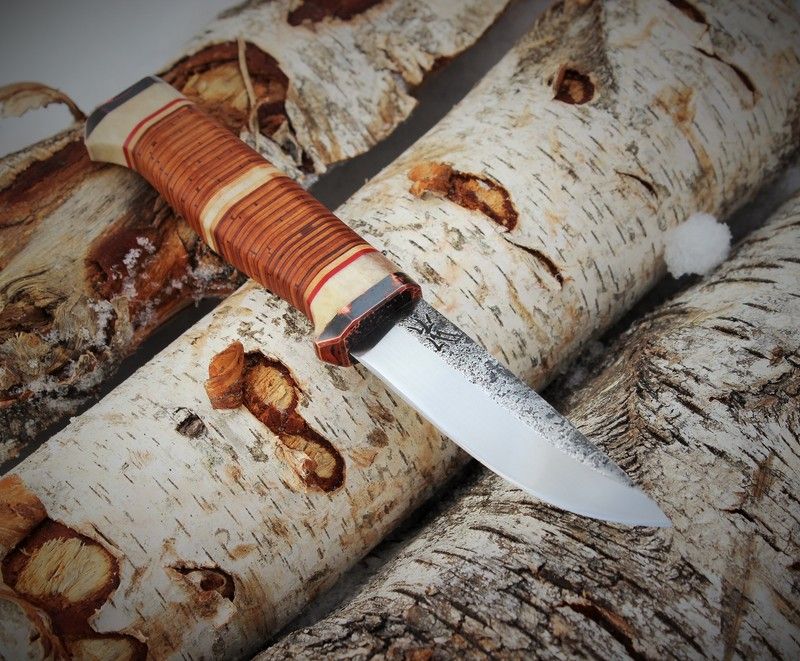

Acadian Voyageur Knife
Blade - 52100(NJSB), approx 1/8" thick, 4.5"blade, 9" overall length
Handle - Friggin beautiful stacked birch bark, that I'll let Peter chime in on, further down.

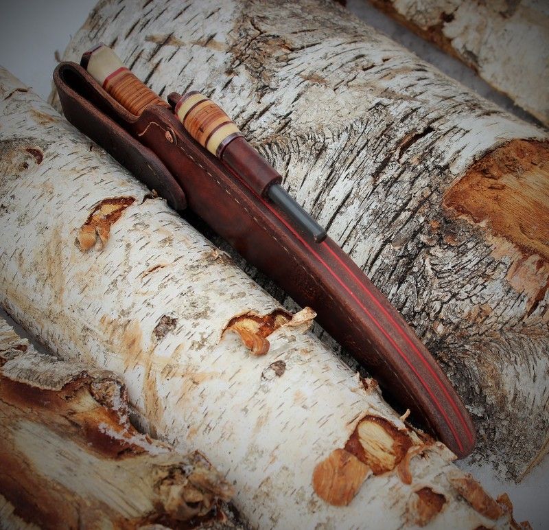

Sheath - 9oz veg tan leather, hand dyed tooled and sewn. Copper rivet, firesteel loop and red fibre liners to reflect the handle.
(Note: Peter's handle really set the standard for this collaboration. I wanted to keep the sheath simple and raw while avoiding throwing a pair "cut-off jean shorts" on a refined, Man of Adventure.)
Thanks for looking!
Rick, you do what you do very well.
And that's a great story. (I have a few of my own similar to that, but it should be expected from time to time.)
Beautiful knife, and the birch bark tops it off nicely.
Nuthin' like team work. :thumbup:
Good story and project. I like the red liners in the sheath. Great collab.
Beautiful knife all the way around, l like the red liners in the sheath.
That is an outstanding looking knife! The blade looks very useful, the handle is spectacular and big enough for a large hand, excellent work all around. John

Rick, you put together a hell of a fine sheath there, and then took some very nice photos of the whole package. It was wonderful working with you on this project.

The handle is constructed with:
-Birch bark from the Frenchvale hills of central Cape Breton.
-Moose antler from the Cape Breton Highlands.
-Yellow Birch from Pictou County, N.S.

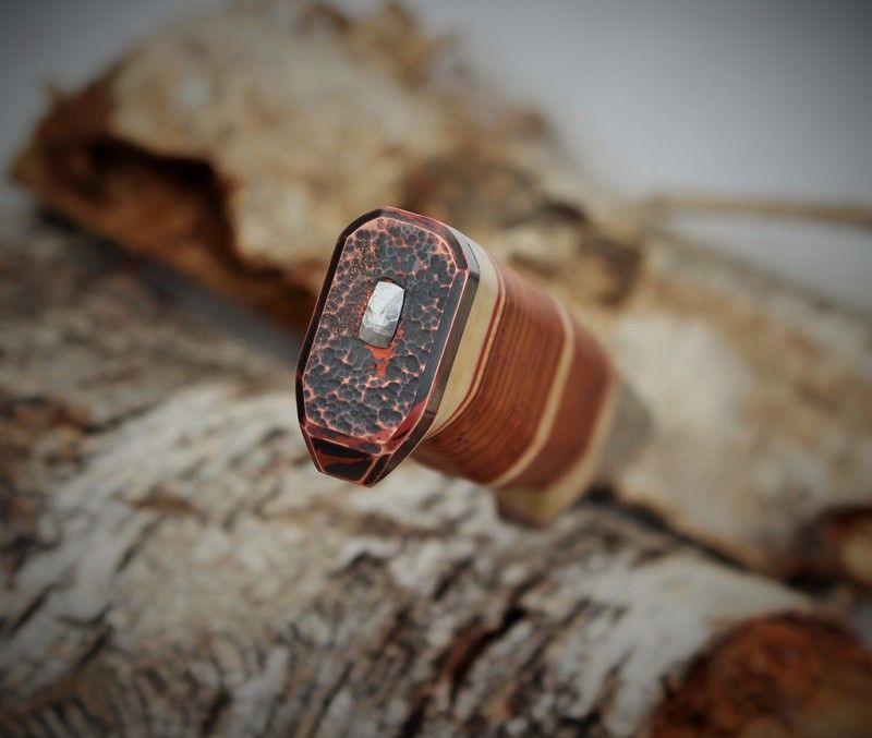

-Copper reclaimed from the demolished Sydney Boat Works junk pile. The guard and pommel were hammer-textured then heat-colored.
-Red fiber spacer from Rick.
I'm very happy with the way the entire package turned out, and I enjoyed this epic colab-adventure immensely.

very sweet work, two heads are better'n one eh!
Everything about this project is incredibly well done! More collaborations are now required!
This is such a awesome story and knife! I love it! way cool. Really works together!
Very cool when two makers with so much talent get to work on a project like this. Beautifully done, gentlemen!
that rocks. I love the forged puukko blade, and the copper on the handle was a great addition. The whole shape of the handle is original and cool. It looks traditional without being a copy.
