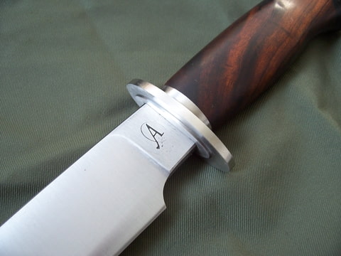

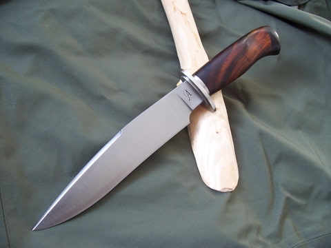

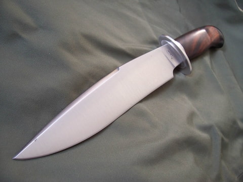

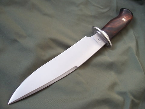

For an upcoming article in the finer edge, I forged this bowie out of 30mm rond silver steel (1.2210). The blade is clay hardened in water, tapered to the point. The fittings are all Stainless steel, grip desert ironwood with an ebony butt. the point is dead centered in my hand.
O yes this one has my logo punched into both sides of the knife, no particular reason, just liked the punching I guess.
At this moment the knife has a scotch brite finish because it will used in the woods for the article. After that I'll give it a nice handrubbed finish and bring out the hamon.
Total length: 31,0 cm
blade: 19.5 cm
here are some pics:
I like everything about that knife, Tony.
Roger, if you check eastvillage's profile, you will find a link to his website.
Like I already said on weapons.be, nice knife. Nice wood on that handle!:thumbup:
Very nice bowie.

Nice looking Bowie/fighter,dig the slight recurve. :thumbup:
Hoping you post a pic(s) after you hand rub/etch the blade.
