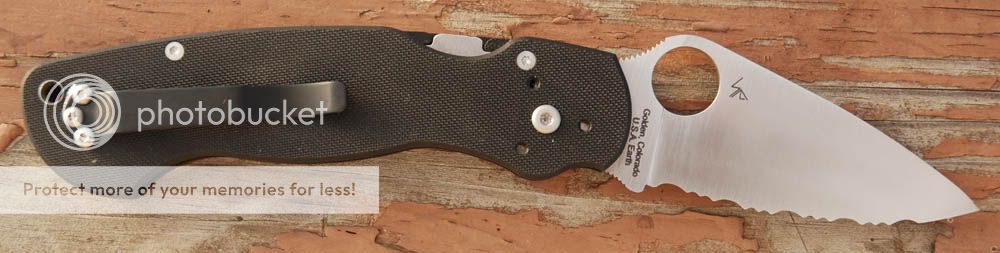

Yes, it's the S.U.C.K.: the Spyderco Urban Combat Knife.
To the casual observer this looks like a Spyderco Paramilitary at first glance, but look closer and notice the carefully designed features making this a first class self-defense knife.
1) The blade has been shortened so it measures less than 3 inches at the longest point. This makes it legal in a much wider number of jurisdictions than in its previous form.
2) The choil/blade intersection bas been subtly reshaped to make it less likely to snag on an attacker's clothing.
3) The military-style clip has been replaced by a smaller clip from a Byrd Crow and the G10 has been tapped for tip-up carry like I prefer. The screws and clip are also epoxied for a secure attachment.
4) The edge is fully serrated for maximum slashing effectiveness (not a modification, obviously).
The end result is a knife with a legal blade length but with a large handle area for maximum gripping security and reach. When I'm legally forced to carry nothing better than a <3" folder as my only means of self-defense, this is the one I'm going to choose.
Behold the awesomeness of the S.U.C.K.

Elkin, nice work on the mod's. The blade shape looks surprisingly similar to my D2 Para / beater which I was forced to reshape after snapping the a tiny bit of the tip off (completely my fault). I agree with it making for a more "friendly" EDC. I do notice a difference in performance though between that and the normal blade shape. I do have another D2 Para which I EDC also.
Nice execution of the clip replacement. The closed retention of one of my Paras isn't great and with that in mind there's no way I'd me doing that. I know this does vary from knife to knife with the original Para's, but I simply dot not trust it. I'm also a huge fan of the std tip down carry Millie clip, and FWIW I am disappointed to see the Endura type clip's appear on the Para2, but that's really not to big a deal as I'll probably retro fit an old school clip when I get my hands on one anyway...
And don't knock the serrations guy's !, they have their uses. The only Millie I carry is a SE 440V and in an abusive hard pull cutting environment that will out cut any PE blade hands down.
