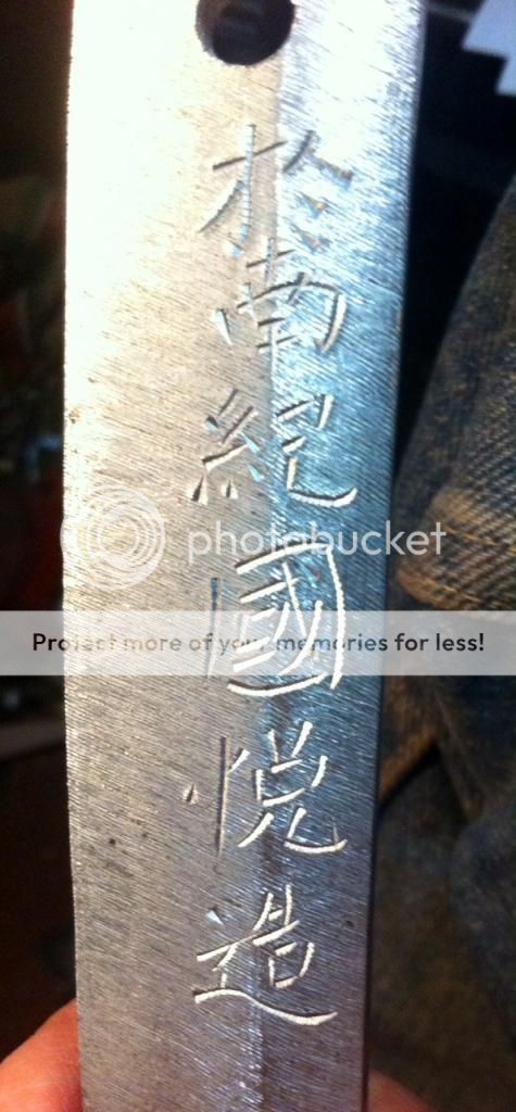

Mei help
Hiiragi Nankinofuhi Etsuzou....she doesn't read mei, this is just a literal translation.
You would probably do better with someone like Southern Comfort, who I think reads mei.

Trying to find out a little more information on this Nihonto.
According to my Yumoto book, last character appears to be "Tsukuru"- make, so the preceding would likely be a name, especially as this is the usual side for a mei. Third character from the bottom seems to be "Kuni"- province or territory. "Kunihiro" is a possibility- hard to tell. best guess is for last 3 characters Kunihiro Tsukuru- lit. made by Kunihiro.

Just checked in and saw this. Are you sure this is a Japanese sword ? The inscription doesn't seem to read as anything coherent in a Japanese context. It is obviously new from the condition of the tang and my only guess is that it reads in Chinese, of which I am of no help.
Of course, it is entirely possible that I am wrong. Wouldn't be the first or last time :-)
Do you have photos of the sword itself ?

Well, long story short...
I was first approached about this a while ago with the possibility of requenching it. It has a poor heat treat and resultant hamon and there was a thought to "rescue" it even at the expense of it's already lowly status. After some research, it was determined that this is indeed a Japanese blade but I looked back over the email communication and I guess some of the initial comments didn't sink in. A few quotes:
"but we actually did a bit of research into its origins, and it turns out that the blade is pretty much a complete write-off"
"the jihada is fairly tight overall and shows good control, the final opinion is that this blade was probably made almost entirely for "practice" (like a doodle/sketch; maybe by a junior apprentice)"
"well-carved signature was a bit misleading and contributed to the confusion, but it now appears that that was just for practice as well." (oops.. missed that)

I have since looked at it more closely and there are many things wrong with it. There is some poor shaping( possibly poorly repolished after damage), bad kissaki, uneven shinogi ji side to side and one side loses proper proportions. The hamon is pretty rotten, as if someone was very timid in their approach and quenched too soon or clayed it way too heavily. It's quite a heavy blade so likely left too thick prequench as if concerned about breakage.
There are some nice aspects to it that make it seem much nicer than most Chinese katanas I've seen though..
Thanks for the responses though, I suspect that the mei is not going to produce any actual information. I am subscribing to the idea that this is a practice piece, and may have been a practice piece for a polisher as well. It's got some polishing problems but there is certainly a fair bit of effort put into it regardless, with the burnished shinogi ji and some hadori polishing (suguha, to obscure the actual disaster of the hamon) and a very clear jihada.
The nakago is odd though as it has a strong curvature that mimics some old Kamakura tachi but nothing else matches the era... again supporting the "doodle" comment.

I took a little more time to look at it again. In regards to your original question regarding the mei/sword. As I said it is obviously new, so perhaps it is a made in Japan practice sword. There is a name for them that simply evades me, but there is a shop in Kyoto, right off Maruta-Matchi Dori across from the Budo training hall on the grounds of the Heian Shrine which supplies most if not all the locals with gear for Kendo, Iai etc.. I saw these practice blades there and the owner told me that they were Japanese swords, but not made with the quality you see in actual Nihonto. They are genuine swords used for practice (didn't ask about cutting) but not of value for collectors of Nihonto.
As for the mei, I'm not sure about the references to Horikawa Kunihiro, except that it ain't him !
I didn't elaborate previously, but of course the kanji for "Kuni" and "tsukuru" are obvious. I suppose if you allow for artistic liberties, a lot of liberty, I could possibly agree with the "Hiro", but it is very poorly done.
The kanji above Kuni, absolutely not "Horikawa" (堀川). I suspect perhaps it is two kanji separated so widely, I first thought it was three, in a feeble attempt at "Shinano" (信濃).
Here is an example of what "Shi" "Nano" and "Hiro" look like on an actual Nihonto:
