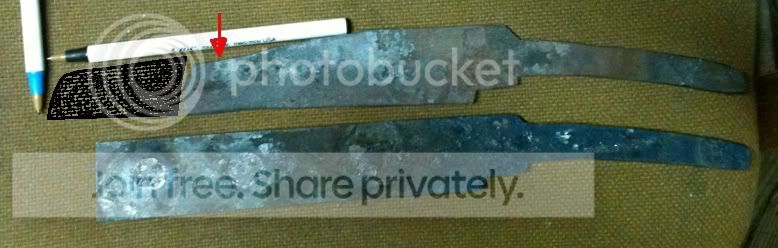

I was doing some forging yesterday in a charcoal forge with a hair dryer for a blower. I was working on a piece of Aldos 1084. I had cut it out to match a piece of san mai I have. I wanted to work on this one first before attempting the san mai.
The san mai blank is the bottom one. The 1084 on top was cut out to match the SM. The black area is the piece that came off. I put it in the fire and let it sit there. Not sure, but I think it got up to yellow hot. When I grabbed the tang with tongs and pulled it out, the front part just stayed where it was. The red arrow is a result of me hitting the steel after it broke.

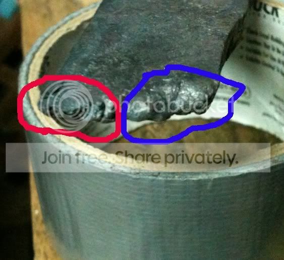

This is the end of the piece. The left side kind of looks like wrought iron would when you bend it at a cut. The right side looks a little like it melted.

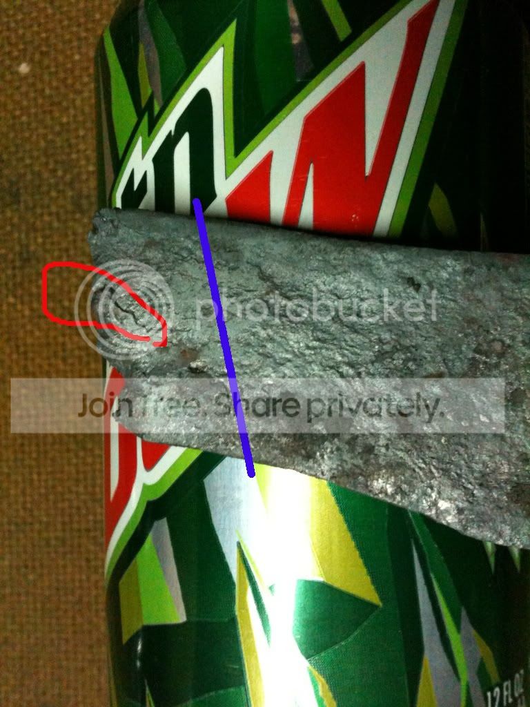

There is a crack in the end of it now. That may have been from me hammering on it though. I just kept at it. If I cut it back a little, maybe where the blue line is, would the piece be usable for a knife or is it ruined?

If you get hot enough to create the "sparkler" effect (often called white hot) with sparks flying aggressively from the steel, it's toast. If you get hot enough to melt steel, which is beyond the sparkler, it's toast. You're talking temps in excess of 2500F.
--nathan
It's dead, bury it and move on :( Maybe throw in in a steel scraps bucket and make some fitting damascus with it later on down the road, but it's not gonna be a knife anymore.
As you go above normal forging temps you get melting of the grain boundaries then oxidation of the grain boundaries --it's scrap !!

Thanks guys. I was thinking that the very end of it was toast for sure.
