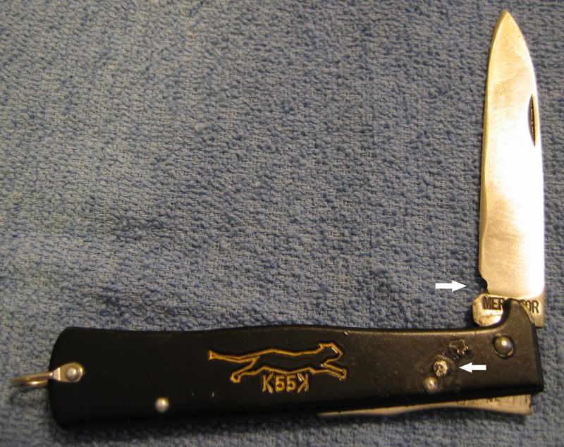

I know it is supposed to do that. It is one of my pet peeves in a knife. It is true of many, otherwise very good, knives. On an Opinel it isn't as much of an issue since there is no spring. Don't get me wrong, I really love Mercators. I have a couple 15-20 years old and I really like the carbon steel.
Here is one I "fixed". I put a pin in the handle which the base of the blade hits (see arrows). I sanded that notch to "adjust it in" and to make thicker steel hit. This is easy to not get just right. If you do it, make a paper template of the blade to figure where to put the pin.
