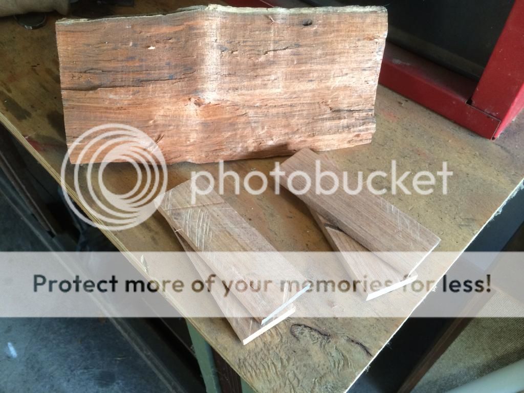

Has anyone used Mesquite for knife handles? I picked up some on a Texas hunting trip and am considering making a knife with it. It is not burl, just a couple of dry pieces from a firewood pile. So far I have just sawed it into a couple of blanks. A pretty blond sort of color but it does not show much in the way of impressive grain; maybe with some serious sanding and some oil???

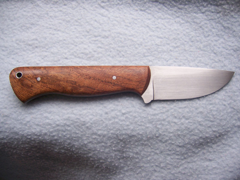

I use a lot of mesquite, being from Abilene. Some of the blondish is fairly plain. There's also a reddish plain variety. The burl is as good as any other burl. In general, the wood is fairly stable and dense, although the blondish variety is typically a little softer.
Reddish knife in this pic is the straight grain reddish variety.

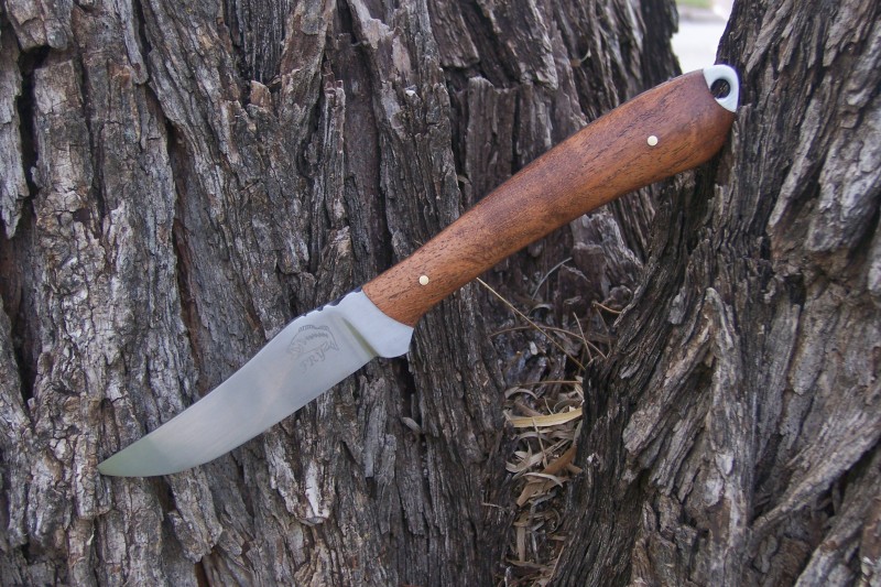

This little guy is a little more burlish in the wood.

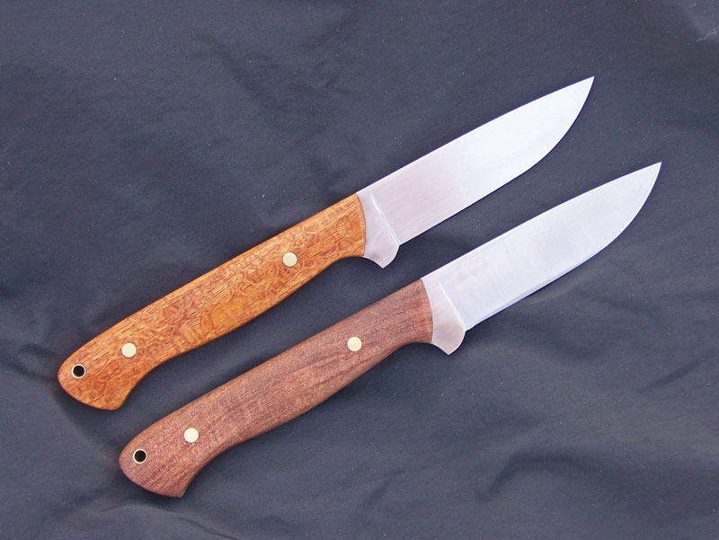

Here's a little more blondish version... had to go back to the beginning of 2012 to find this one.
This is mesquite on my petty knife. Can't recall where I bought it. AKS, USAKNIFE, Texas Knife.....I forget. LOVED working with the stuff. I have a few large chunks of mesquite burl that I have harvested from our ranch. Been drying out the past year. Sometimes mesquite is just plain straight grain. Other times you can get a nice tiger stripe effect/affect? Which is correct? My grammar aint too good. 020.jpg021.jpg
Thanks Samuraistuart and Jason Fry - you guys have some great looking knives... here's a pic of the Mesquite I have to work with:
I do plan to go ahead with at least one knife and see how I like Mesquite.. Thanks!
