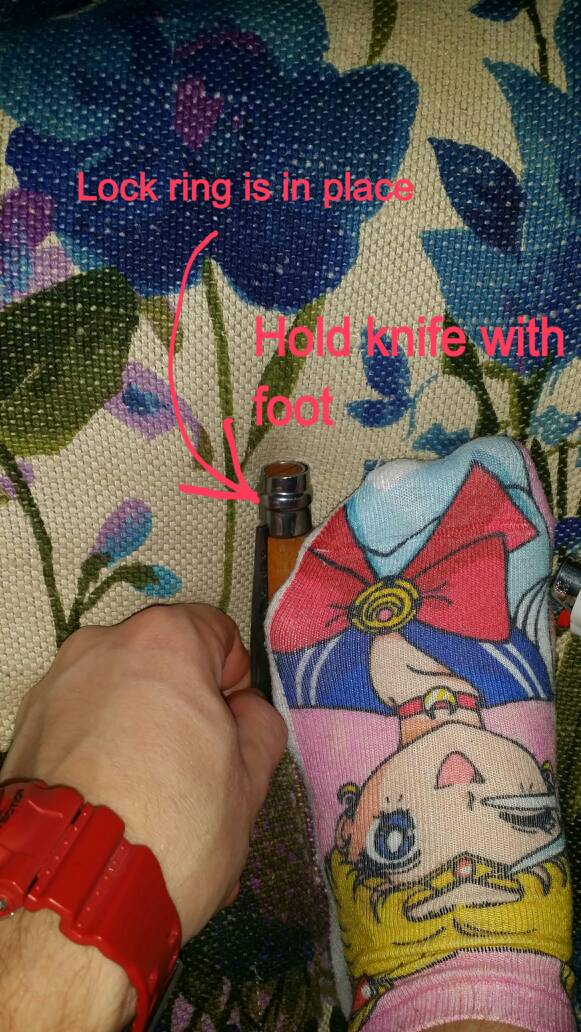

My opi originally had a grinding problem, it seemed like after two days of use I had gummed it up. Play the ring back and forth to work in the grit, wearing it in so to speak, then pop off the ring, clean with an old toothbrush or q tip, do whatever sealing you want while the ring is off, then put ring on.
Here's how I remove my ring: make sure to pop it off at something really close and contained, maybe into a cardboard box. It can fly far! After you get a grip on it, just pull the blade open from the locked position. To reattach, snuggle it on to the top, then give the ring a sharp smack on a hard surface to snap it back on.
Also disregard Sailor Moon socks :D
