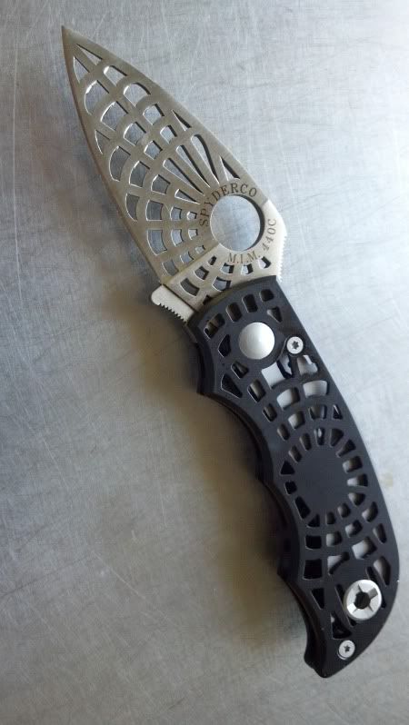

Kershaw had a high end folder with a MIM 440c blade. If I recall there were reports of warped blades. I have never seen one outside of a knife case.

MIM only makes economic sense of the part shape is complex. Most blades are not in that category.
And depending on the alloy, machining and MIM are not the only options for manufacturing.
420HC is popular because the blades can be stamped to final shape.

Molds are very expensive $10 000-$20 000 a copy. And they wear out, and you can only use them one at time. Compare that to having 10-20 machine operators cranking out blades. The advantage to the machine/man combo is that they can be switched to making other gadgets at the drop of a hat or fired.
